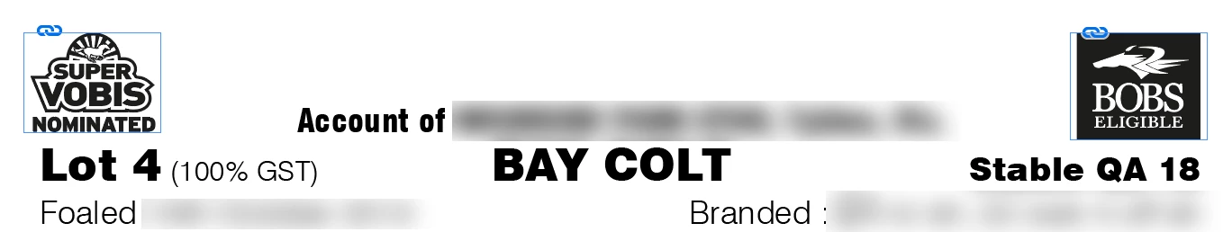

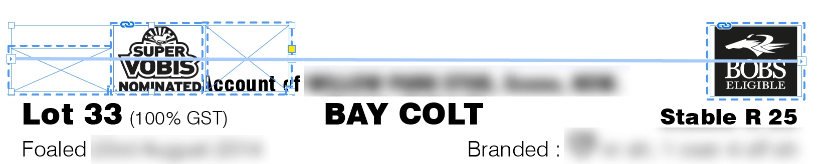

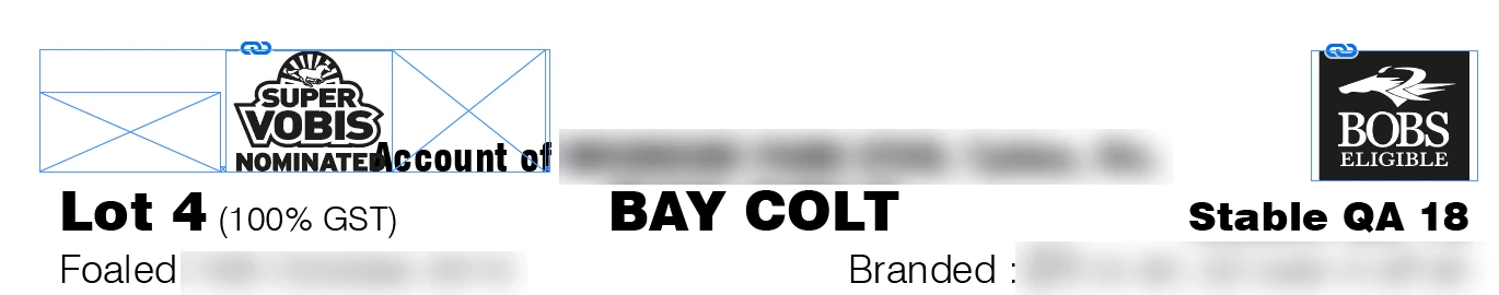

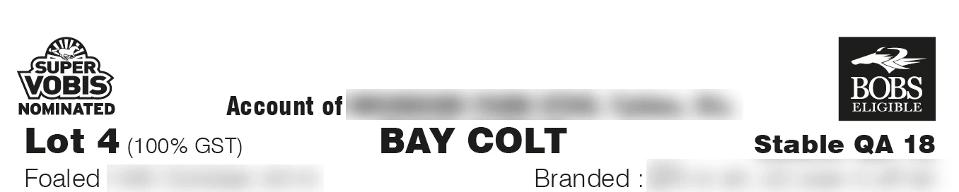

    I used to face this issue when applying eligibility logos on horse auction catalogues. The brief was that the primary sponsor would need to be in the top right, and subsequent sponsors appear on the top left e.g.
    The solution was to make two threaded text frames - start on the right and finish on the left - and in the text itself, use inline objects that were linked to the logos that were required.

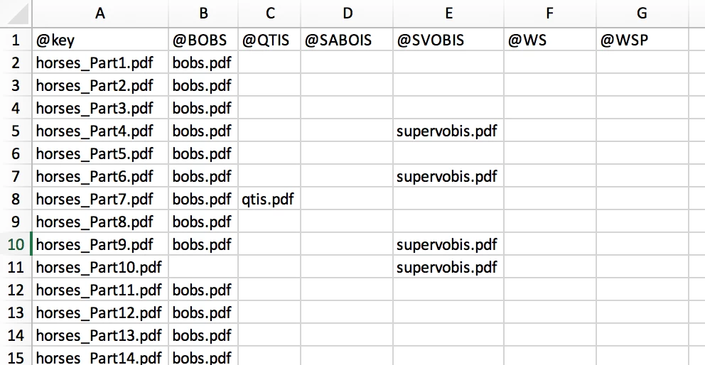

    The data was set up in a way similar to Jeffrey_Smith's example, with the exception of putting them back into one column (as I may have more than one logo to add):
    I would then merge to a new file and be left with the following result:
    so the outcome is close, but not complete, because there are still empty frames here. That's when I run a script I wrote called empty frame remover to remove the empty frames, thus moving the left hand logo where it needs to be.
    The empty frame remover can be downloaded from my website for free: Scripts | Colecandoo!
