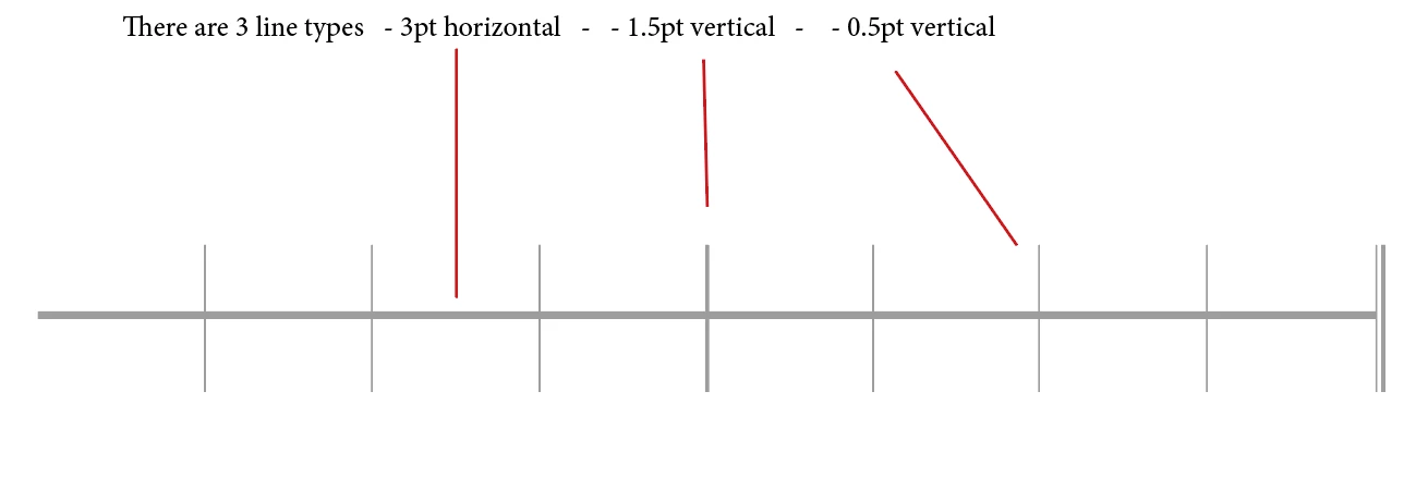

I am using three different line types, created using InDesign line tool.
This simplified music stave is used over and over (for different tunes).
The stave, and its lines, are not a single size.  ALL line lengths vary (depending on the tune length!).
I am wanting to standardise the three line types for line point size (only), retrospectively (!), on a large number of staves.
Can I, in Indesign, set three different line tool point sizes which I can then apply simply by highlighting the lines and clicking?

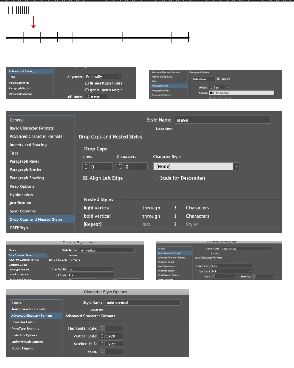

    You can do this…
    Type a series of vertical pipes and apply a paragraph style that has the following properties:
    Full Justify alignment
    Paragraph Rules: rule above, 3pt
    Nested Styles: a light weight character style applied through 3 characters, followed by a bold weight character style applied through one character. Then repeat the last two nested styles.
    Hopefully the screenshots make this easier to follow. It's a bit of hack and you might be better off making a Pattern Brush in Illustrator if you're comfortable using Illustrator.

    October 4, 2019
    Thank you! I'll give it a try. (Illustrator is not an option!)

    October 4, 2019
    Hi Scott, Thanks for you answer. I've re-edited the question to try and explain better my problem...

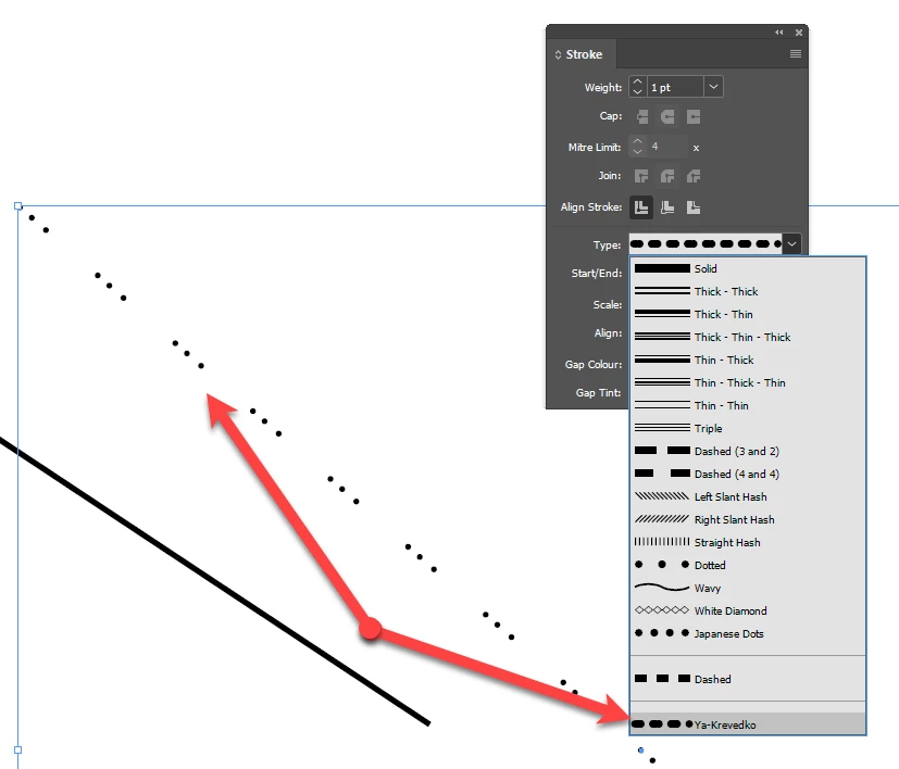

    October 4, 2019
    Hi! Yes I have. But I can't make 'stroke' styles apply to lines made with the line tool...

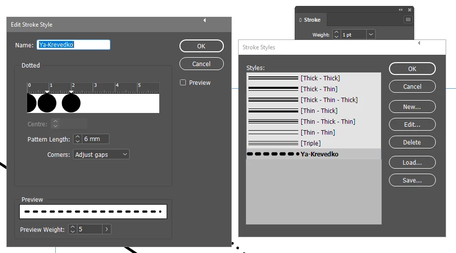

    Randy Hagan
    October 4, 2019
    There are ways you can create object styles with InDesign, but if the lines are not only consistent thicknesses but also consistent lengths, you can store them in an InDesign library to drag out and apply at will.

    No NotesAuthor
    October 4, 2019
    Thanks Randy. But there are too many! It will not be quicker than highlighting each individually. I've added a screenshot to try and explain the problem better.
