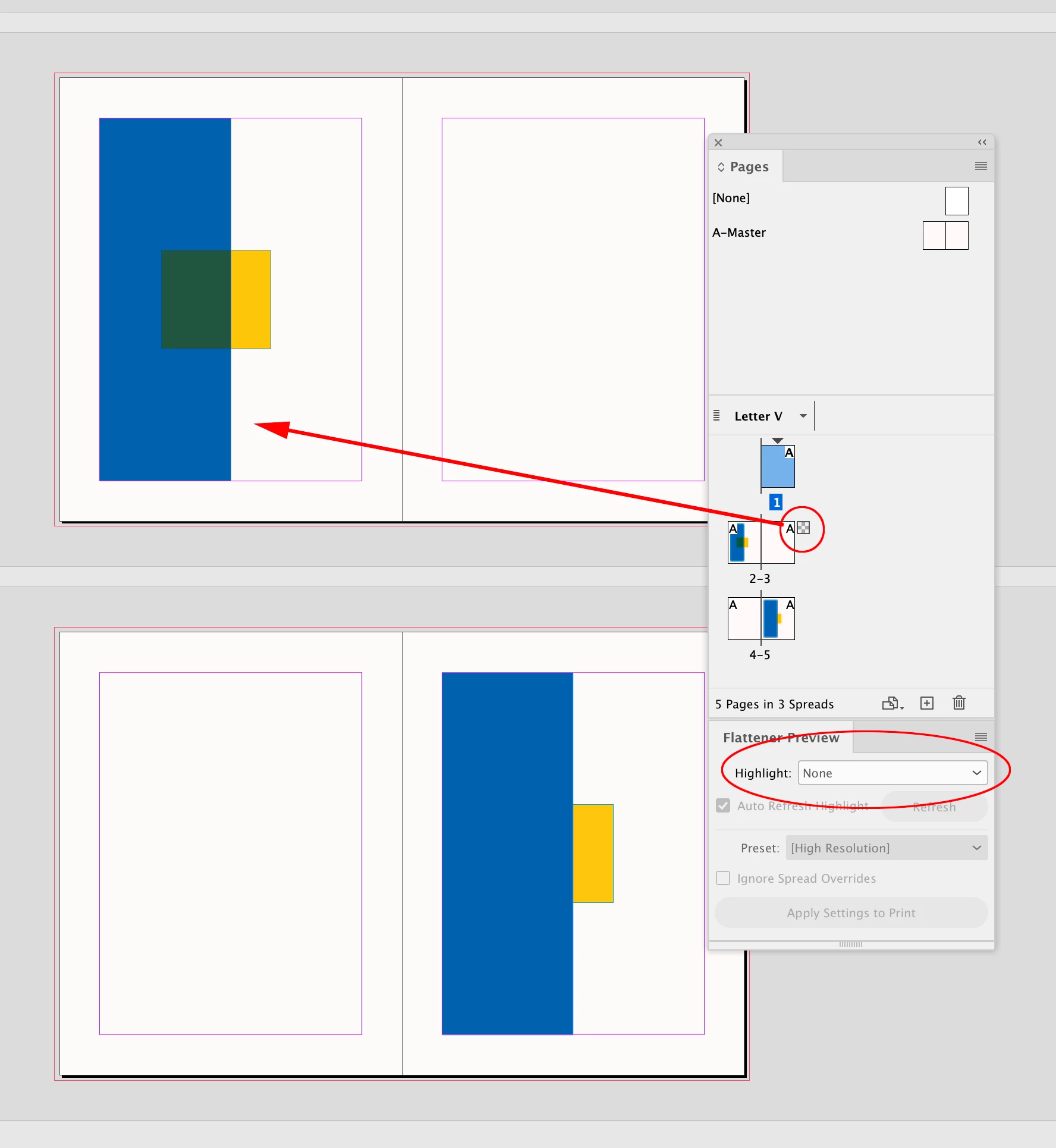

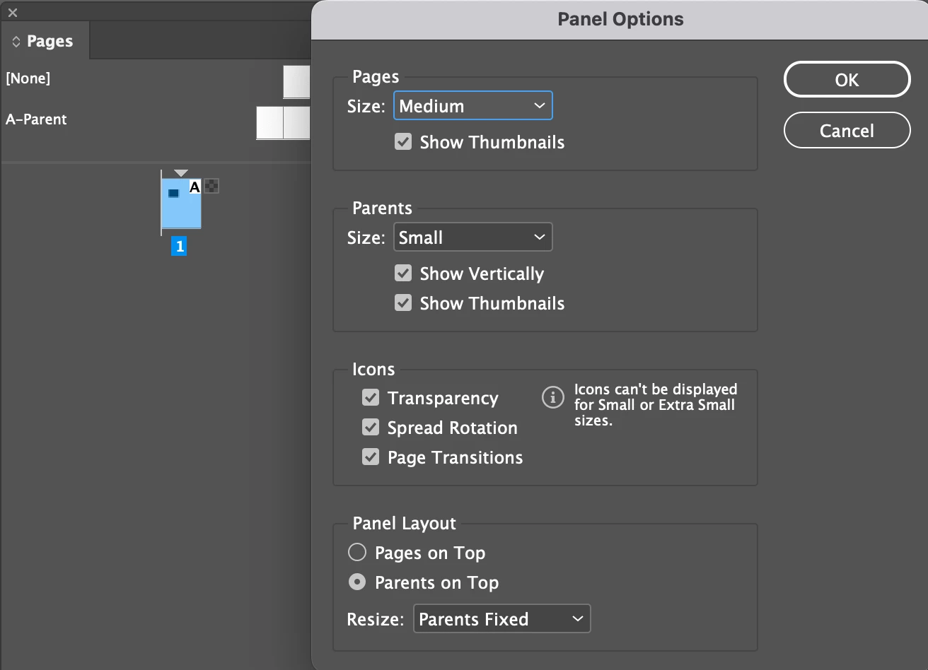

@Mike Witherell has covered it.
If you're wondering which pages have Transparent Objects you can go tot he pages panel sub menu and the Panel Options 
And it will show a transparency icon on the spread to indicate that spread has transparent objects.

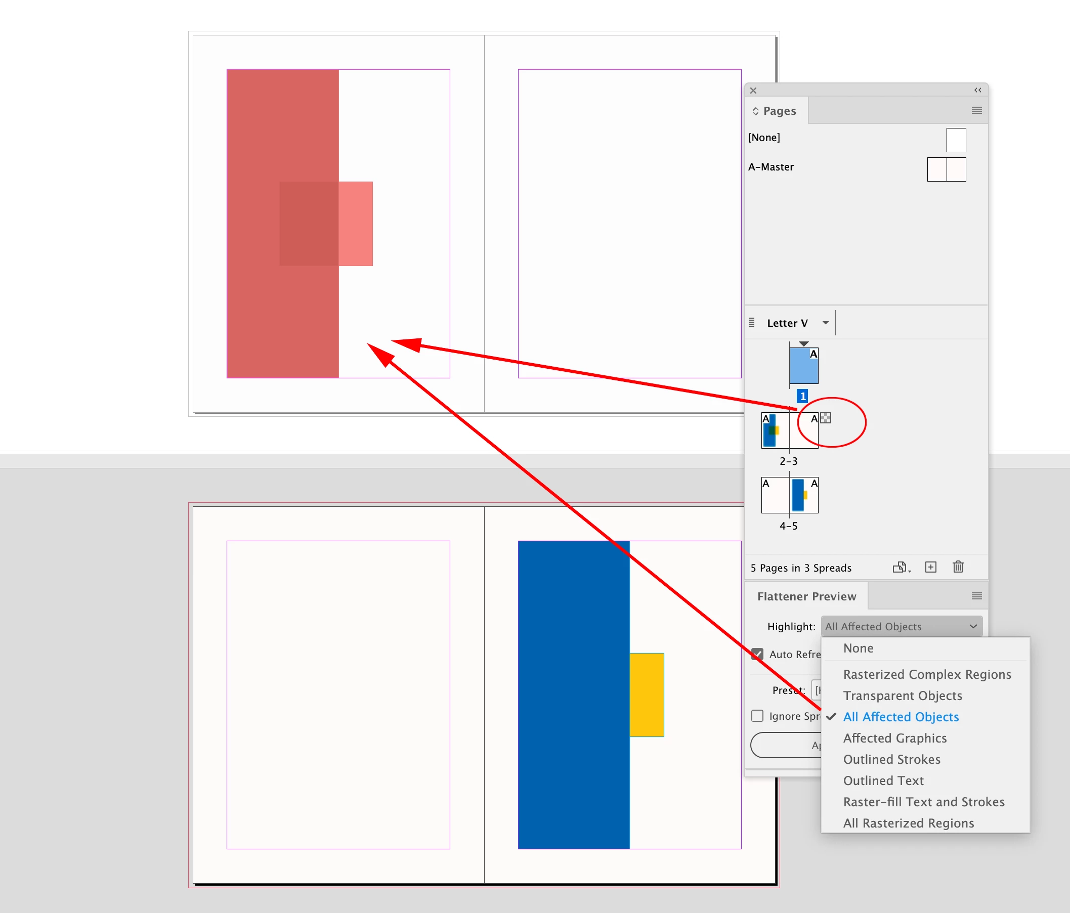

Hi @Snowdog63 , Also, not sure if this helps, but InDesign has the Flattener Preview panel which shows how a spread with any transparent object will be flattened for print using a selected Flattener Preset.
