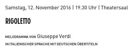

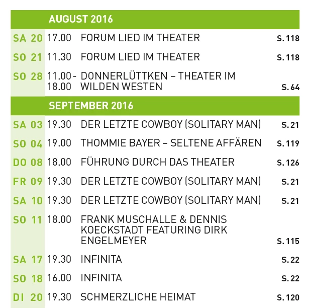

I´ll attach two screen shots to show my layouts.
This is (last year´s) table layout with 200+ single dates, each date having it´s own cell:
And this is another instance of date inside a normal text frame:
My idea is to just write down the proper date like DD.MM.YYYY and let ID convert it into the format needed: in the table only into "SA 20", inside the text frame to "Samstag, 12. November 2016", mainly so the week day is added automatically.
