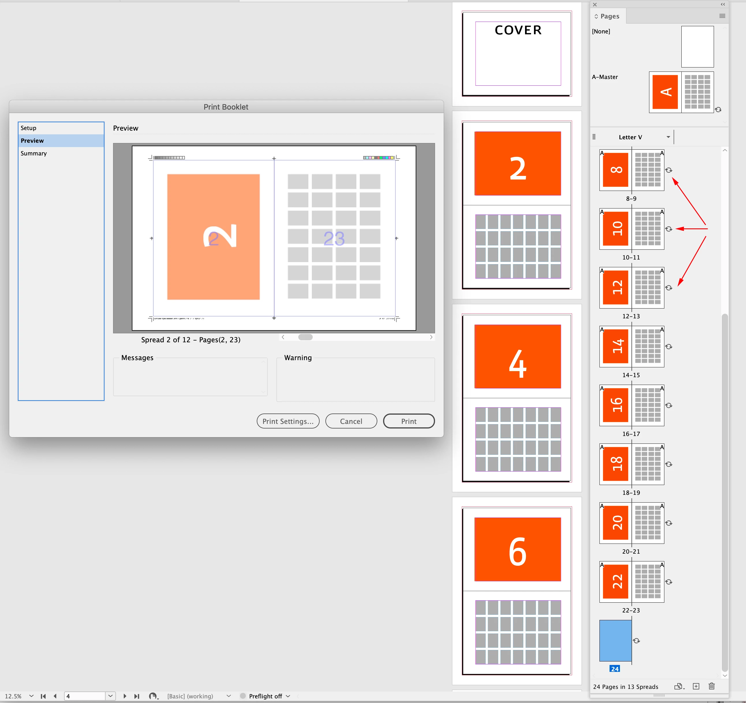

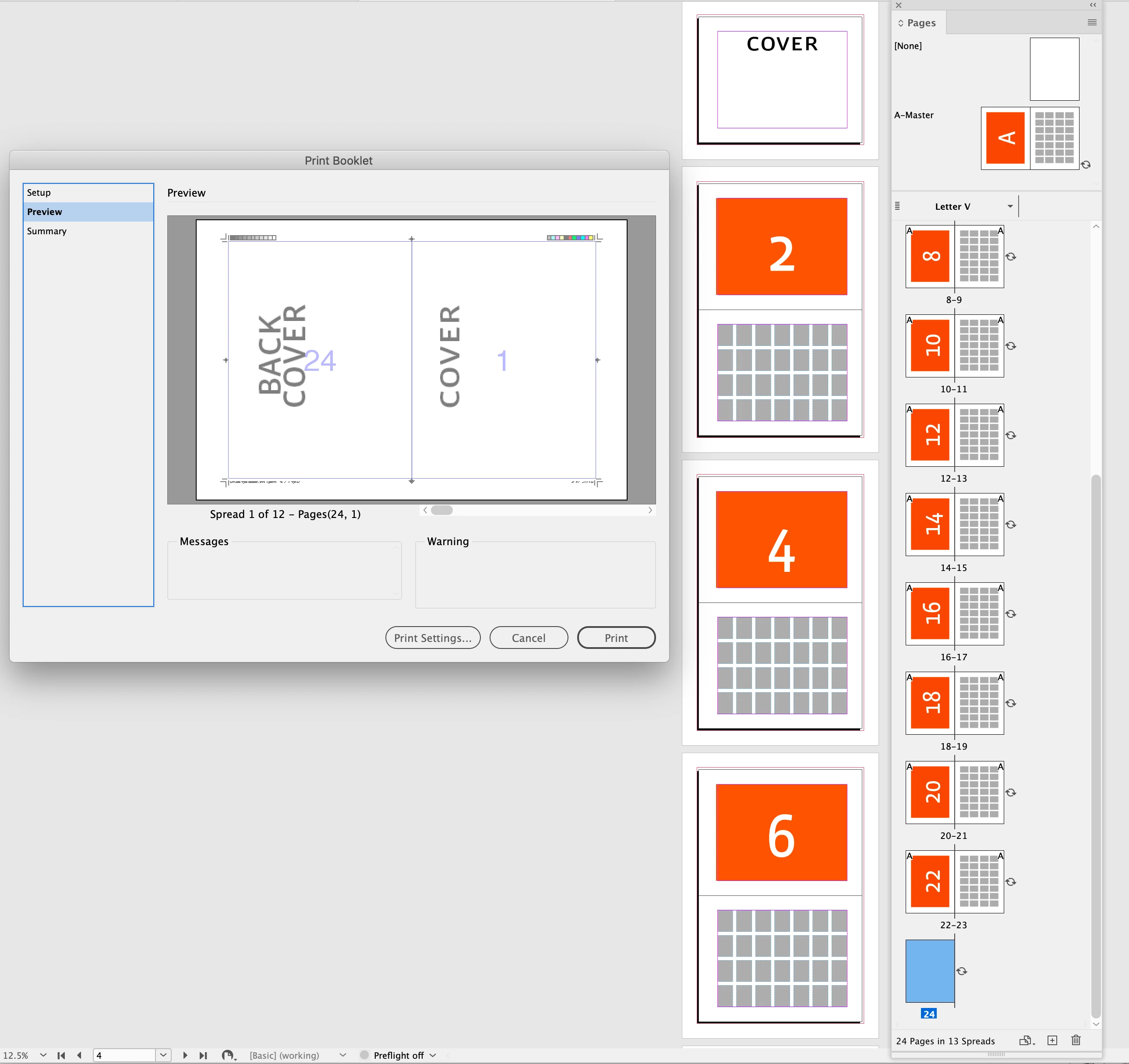

You can rotate the page view by selecting all of the pages in the Pages panel, and from the flyout menu Page Attributes>Rotate Spread View>90CW. Design to the rotated view and Print Booklet could work:
