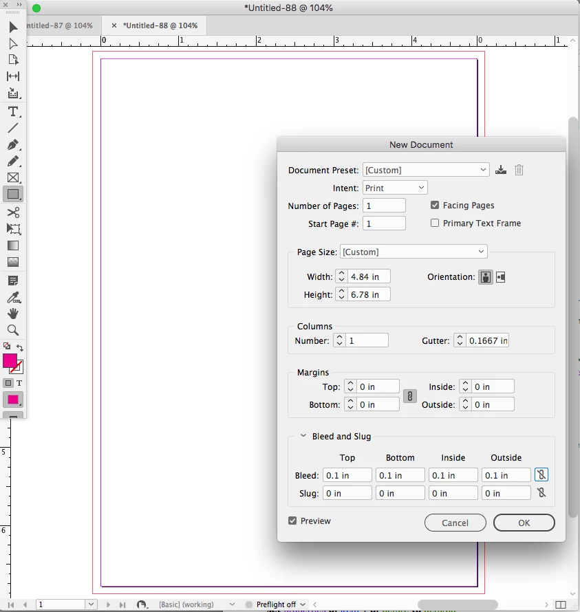

I'm working on a 5x7" magazine ad and in the spec document they sent over includes this image.  You'll notice some additional information outside of the print area graphic, "X.XX in bleed" and "X.XX in trim".  I have no idea what that's trying to say.  Does anyone else in the forum know what this means? I'm quite familiar with trim size, cut size, bleed, text-safe area/margins but I've never seen it presented in this way before so it has me a little confused. Thanks in advance for your help.

I've seen this before with automated printing where the 5"x7" dimension isn't literally the final production dimension—there is some adjustment to get extra efficiency. As Frans suggests, it seems like they want this for the document setup (the margins would be your choice):

6,98 - 6,78 is 0,10 at each side maybe is what they mean.
June 2, 2018
Dank u wel, Frans!  That was how I originally interpreted the instructions but it doesn’t jive with print standard for bleed, which is usually .125 inch.  I’m going to see if I can get in touch with someone at the company putting the magazine together on Monday to see if I can get clarification.
