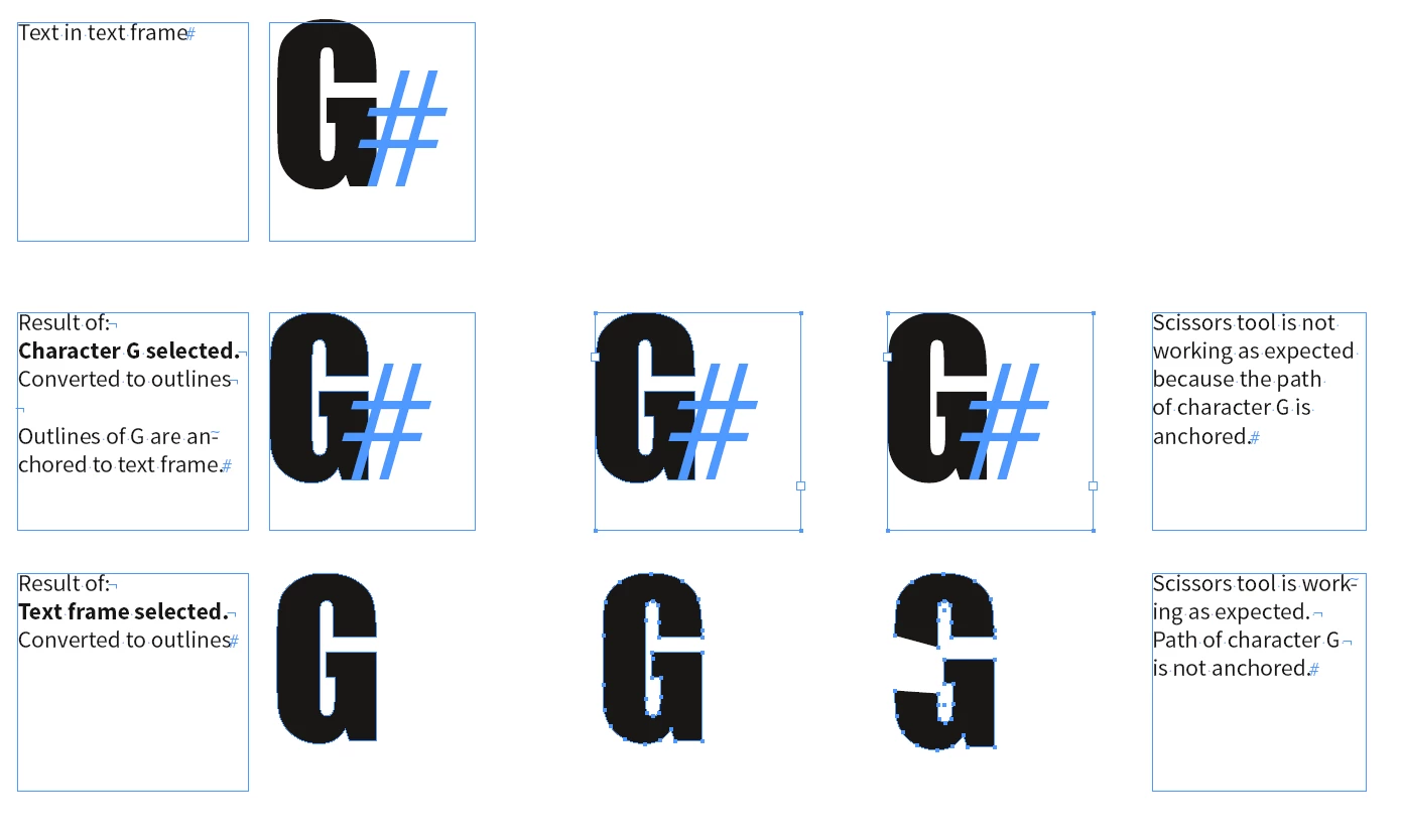

I assume that the outlines of character "G" are still anchored to the text frame.
Here two screenshots that explains what I mean:
The whole picture:
Unanchor the path from the frame and the Scissors tool is working as expected.
Cut the selected path and do Paste in Place or use the unanchor feature of anchored objects.
FWIW: When working with that kind of tools it's always good to enable View Hidden Characters and View Frame Edges.
