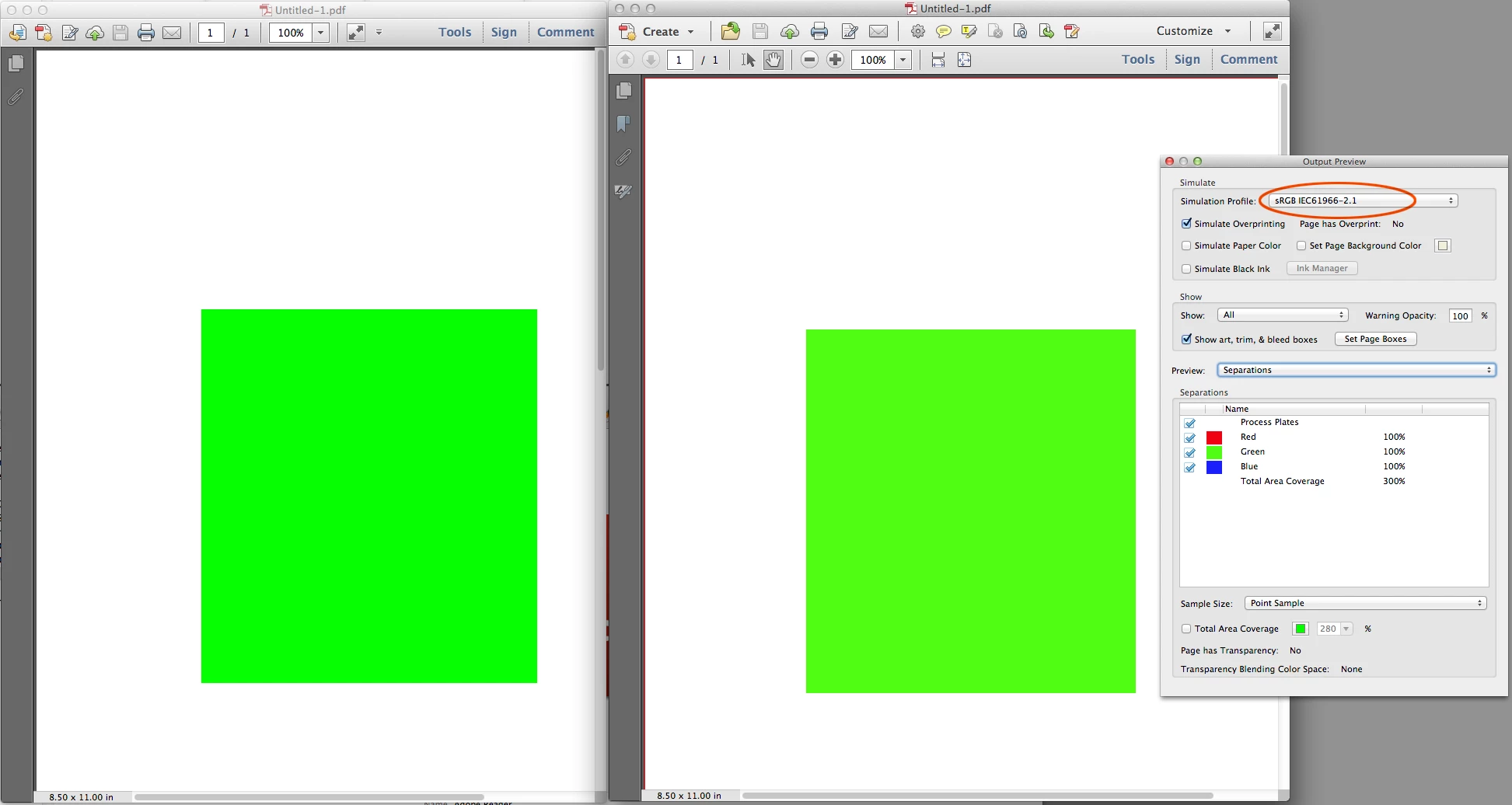

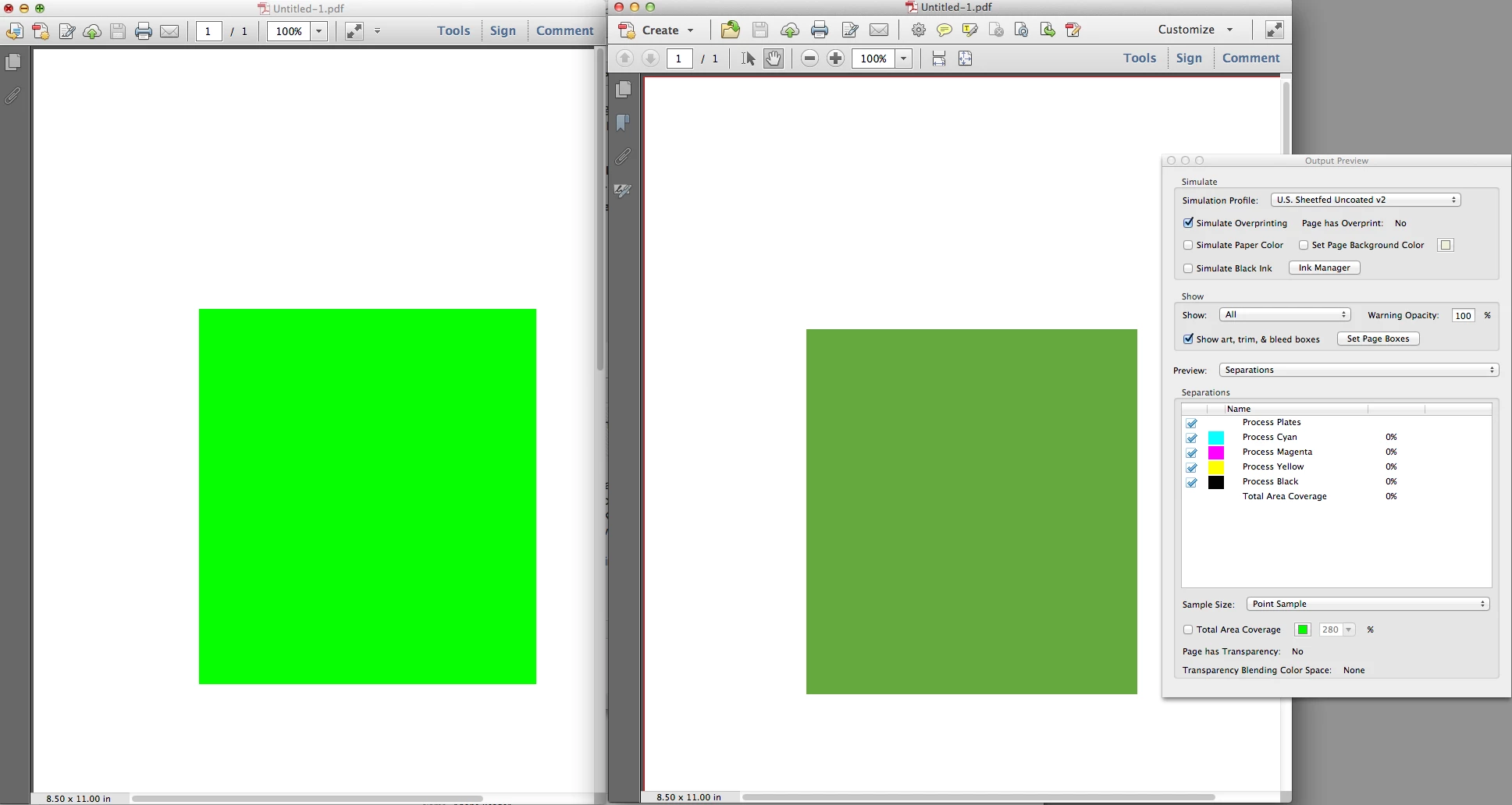

only had the issue in adobe Acrobat Pro (and presumably reader - but I didn't have reader to test it on).
Keep in mind that AcrobatPro is a print program and by default will usually show  a print simulation (CMYK) of the page. So when you export an interactive PDF all of the objects get converted to sRGB and AcrobatPro defaults to softproofing the conversion from sRGB to your AcrobatPro CMYK Working space. You have to set the simulation profile in Output Preview to sRGB to see the original ID preview
That will not happen with Reader. Reader doesn't have a print output simulation. Here's the same interactive PDF in Reader and AcrobatProXI:
If I set AcrobatPro's simulation profile to sRGB  and the displays match:

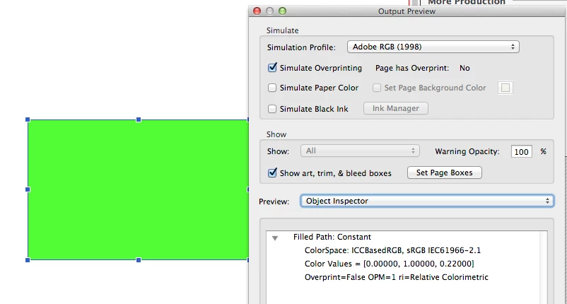

September 24, 2013
All objects in interactive PDFs get converted to and tagged with sRGB on export. You can see it in Acrobat Pro's Output Preview>Object Inspector:
