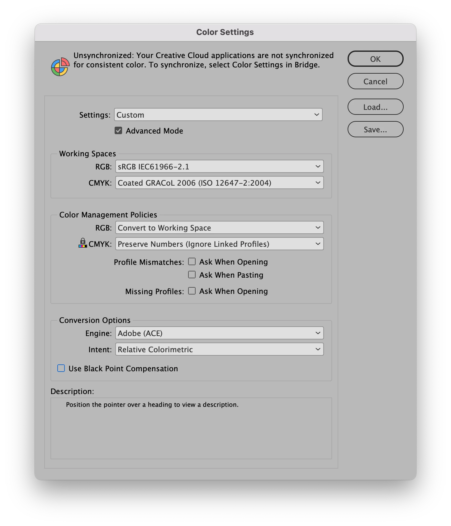

I am so frustrated right now. I used to be able to open my file, print 500 envelopes, and DONE!! Ever since I played with my color settings to make them match where I worked, I can't figure out how to get back to where I was with my printing. I haven't changed my links in my documents, the only thing I have changes is color settings through Bridge so that everything would sync. I can't remember what the setting was before. I have tried so many different things, but I'm not 100% sure of what I'm doing. I did try changing the color setting back to North America General Purpose 2, and the color is closer, but still muddy looking. For example, the color in Photoshop is 100% yellow, but when it prints, it looks like dull mustard.  When I look in the linked palette, it says the links are document cmyk.

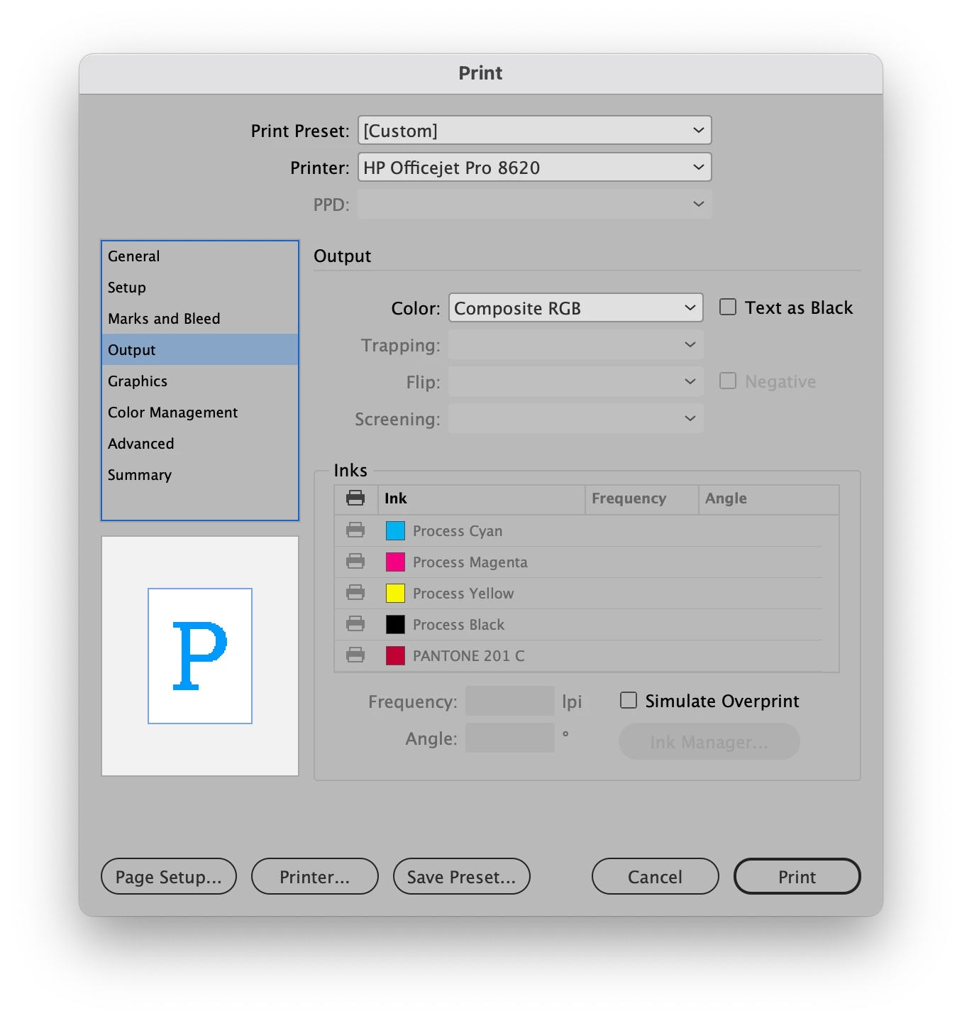

There's a possibility you are applying double-color-management through ID (it happens).

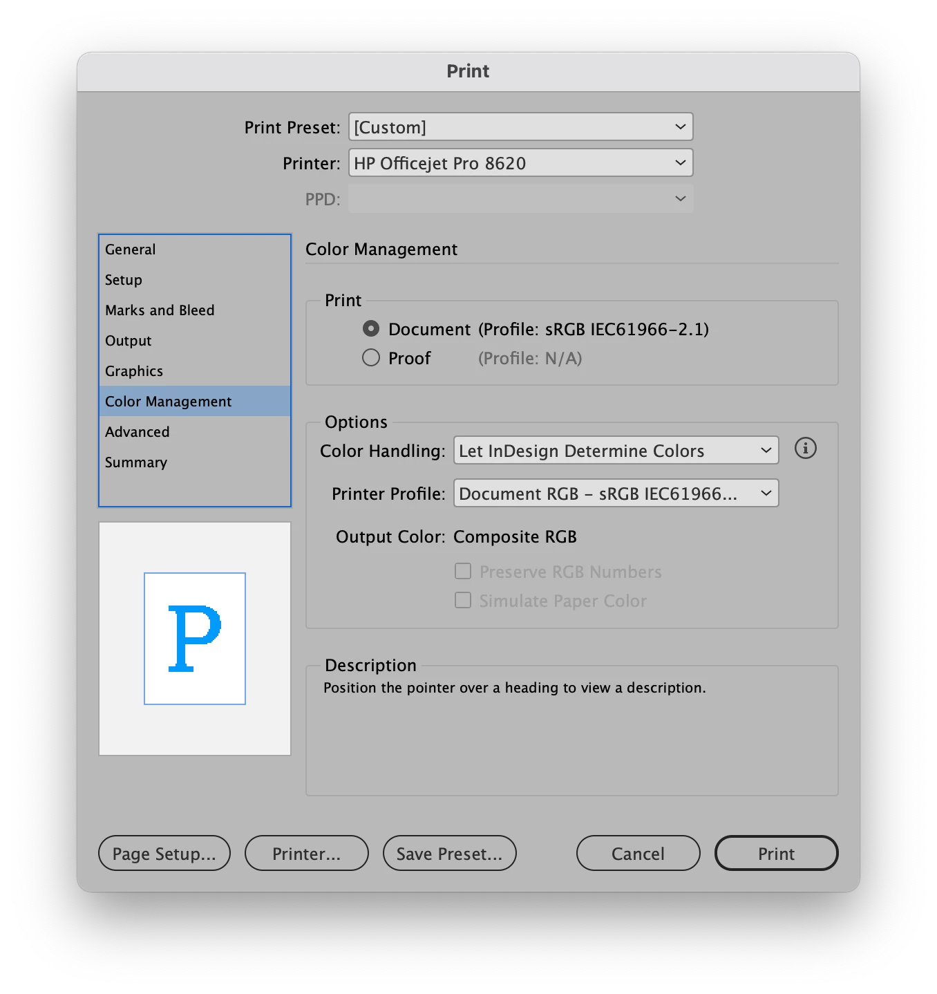

Can you show a screen shot of the color management tab in your Print dialog?

I have attached the color management image from the print dialog.

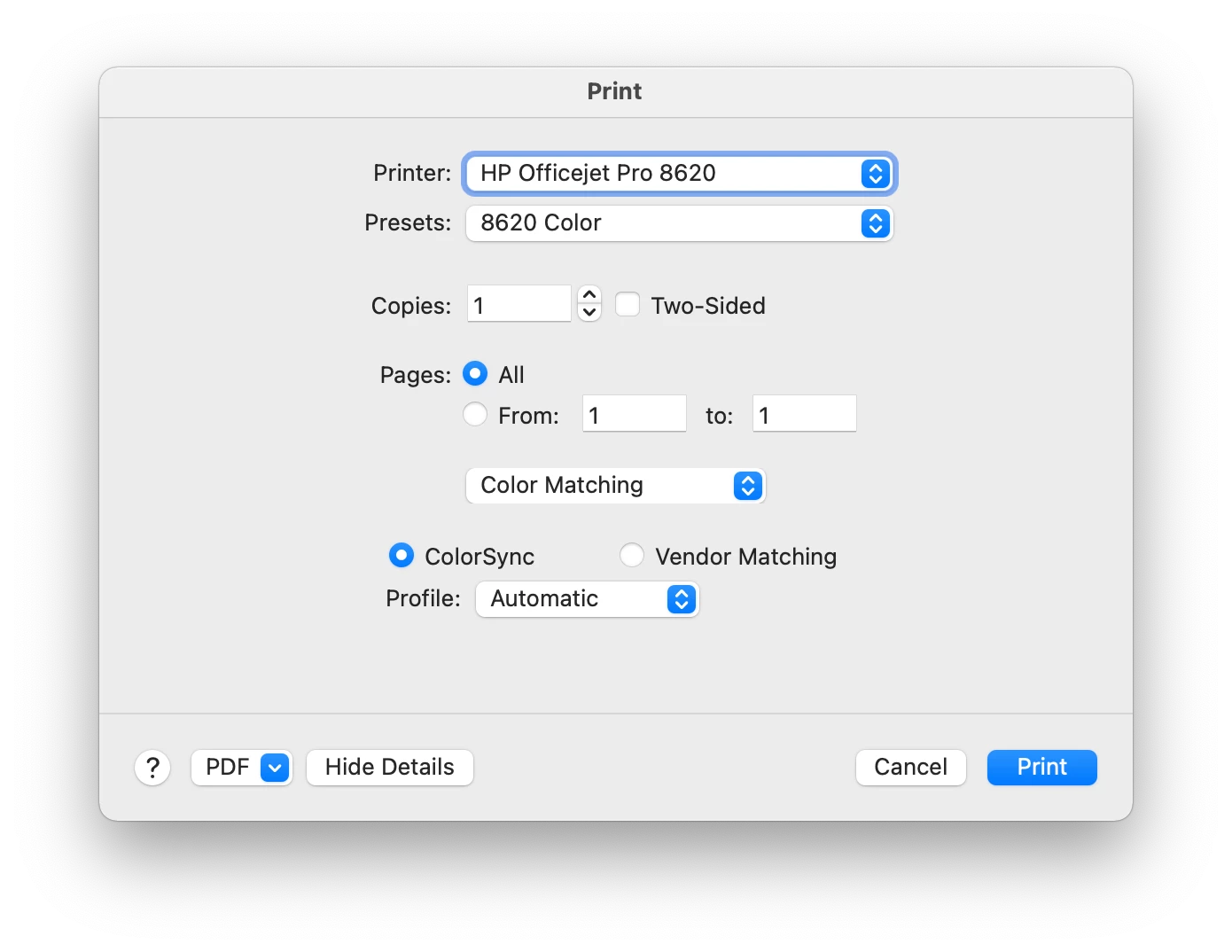

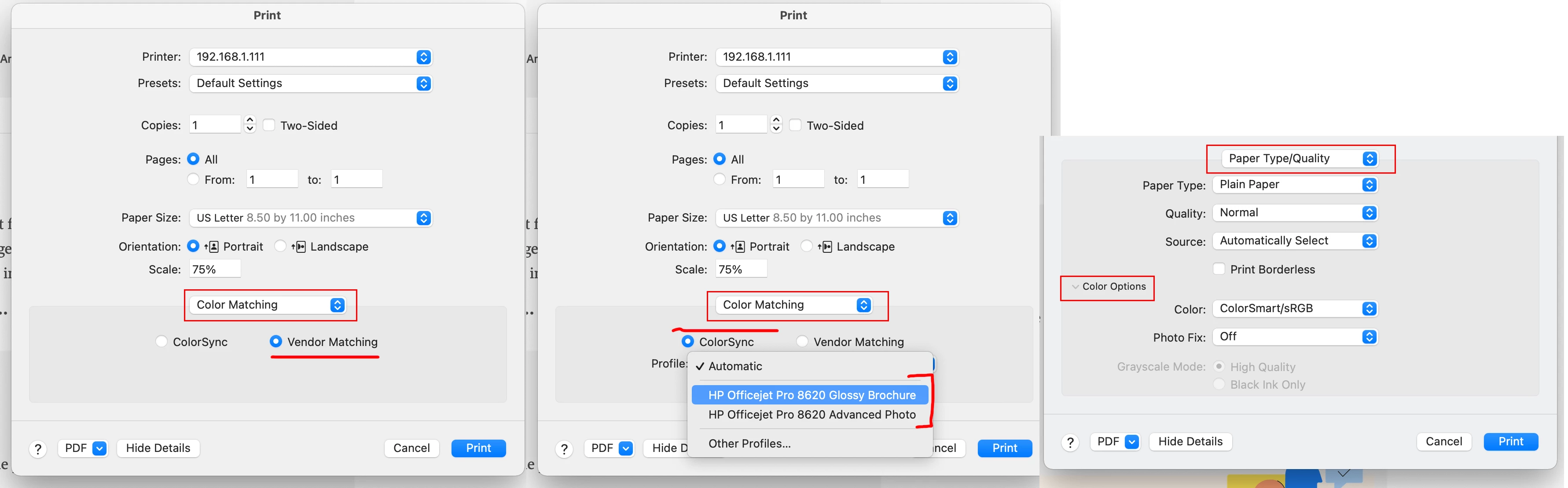

Might be time to check your printer settings. In particular, check the settings for Color Matching.
Normally you can go with what the printer itself will do... in your case it would say "Vendor Matching" or "In Printer" ; this uses the printer's default built-in conversion from sRGB.
Alternatively, you can select ColorSync and choose either Automatic (which will use an appropriate Profile if it exists: this can be problematic) OR select a predefined Profile that gets installed for your printer. I test installed a driver for your printer and it installed two, as shown. If you DO use ColorSync, make sure you DO NOT also set a conversion in InDesign. This is the double-converting I was mentioning. From you're screenshot, you're letting InDesign send Document sRGB data, which is appropriate.
Also make sure you've selected the appropriate paper configuration. Your printer will have built in fine tuning for each paper type.

You may want to try changing your CMYK: color settings profile options box from GRACOL Coated to SWOP Coated 20%. SWOP coated has traditionally been the default color setting for InDesign color display onscreen.
Hopefully that will get you the results you're looking for.
Good luck,
Randy
May 3, 2022
That gives me the exact same results. Thanks for the try though.
