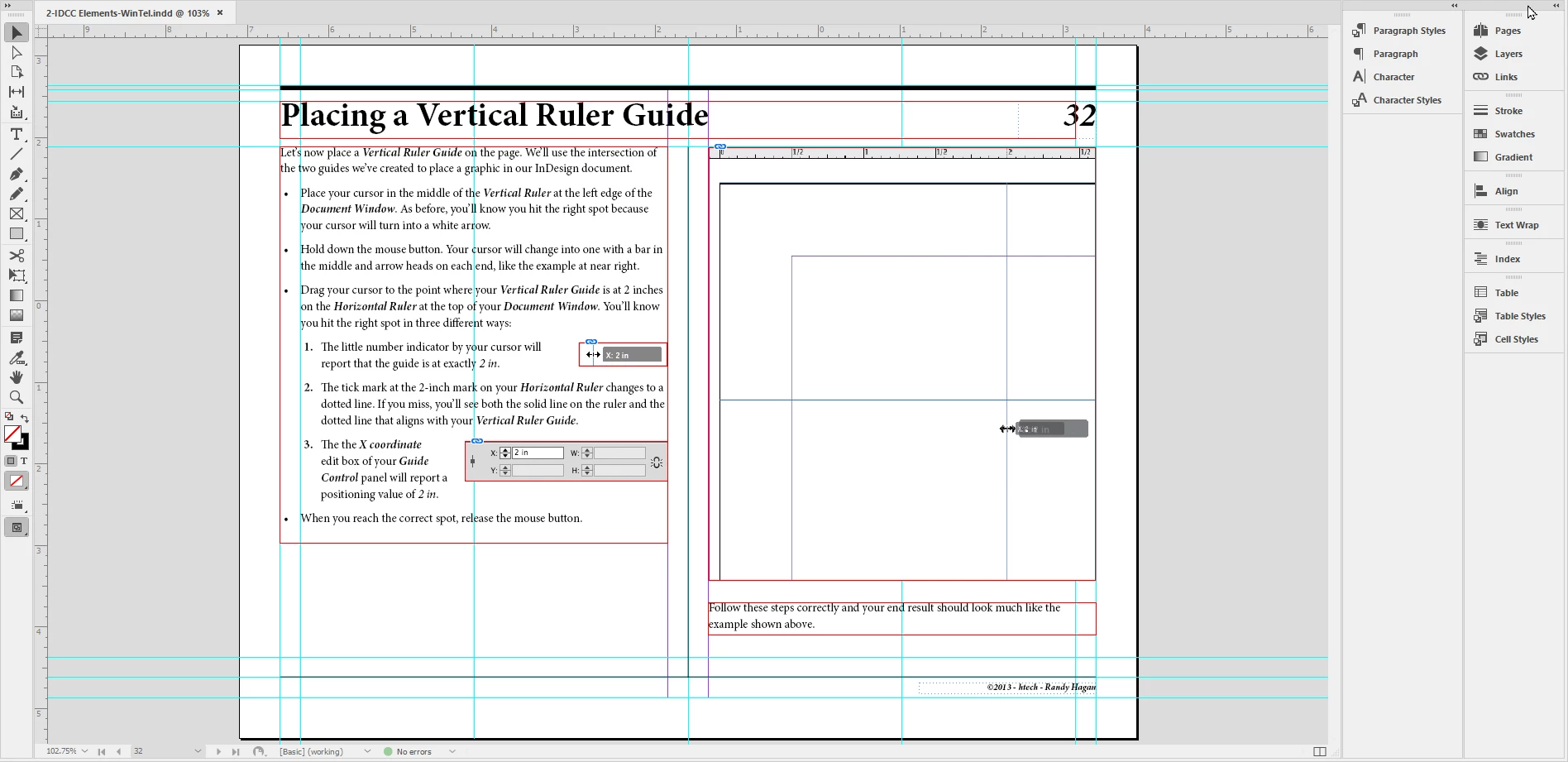

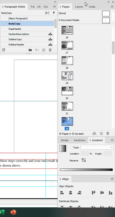

Yes. InDesign allows you to "park" groups of panels to the right of the document window in what's called an InDesign Sidebar.
  1. Since I have a very minimal sidebar (and in my case, I also have a two-column sidebar) I had to expand my dragged-out sidebar to grab it easily, like the example at right:
  2. Place your cursor on the very top bar of the workspace sidebar you dragged out, hold down the mouse button and drag it to the upper-right corner of your document window. You'll know you're in the right place when you see a bright blue line all along the right edge of the document window.
  3. When you see the bright blue line, release the left mouse button, and your workspace will be docked in the sidebar, as shown in the screen capture below:
This should get you where you want to be.
