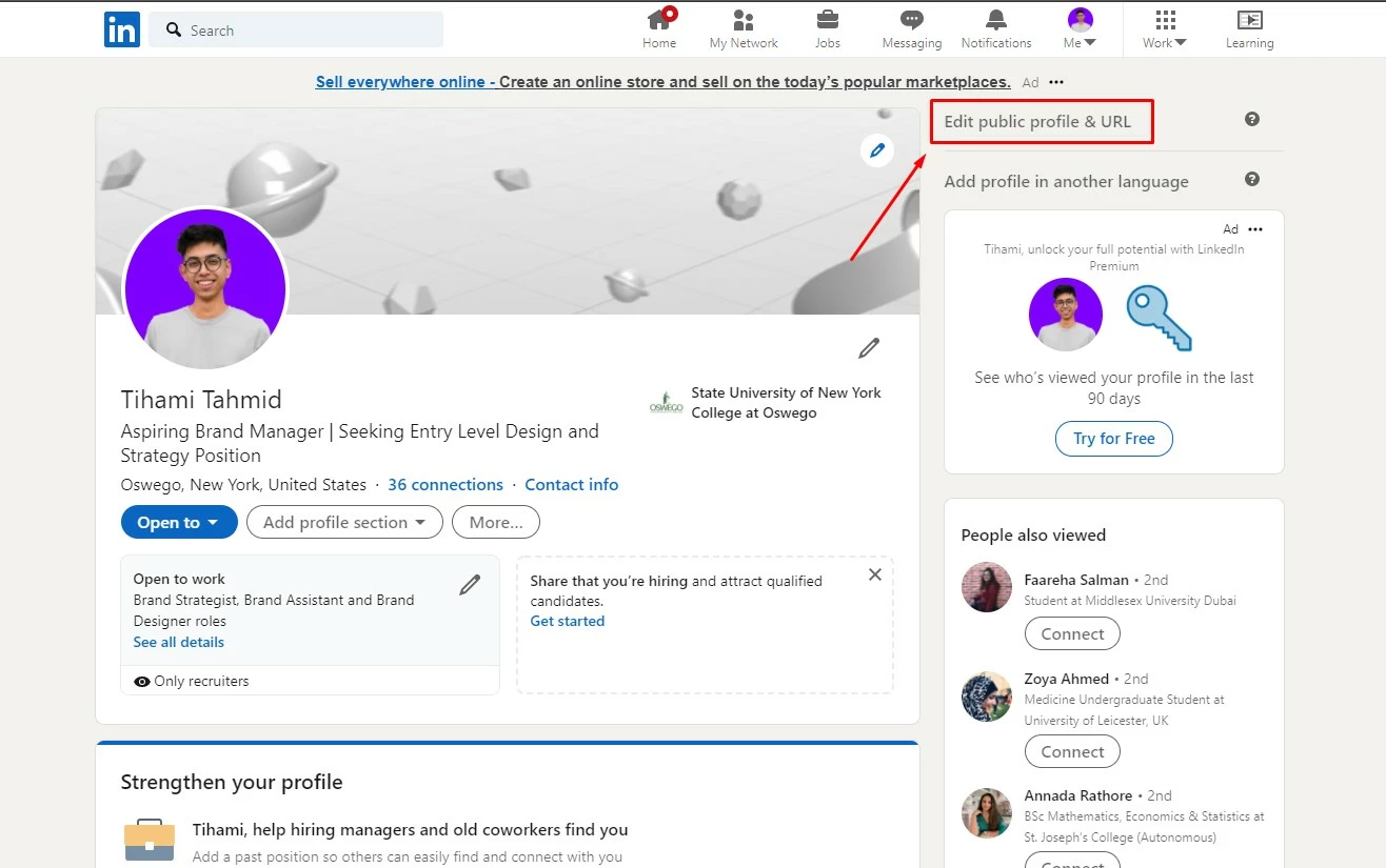

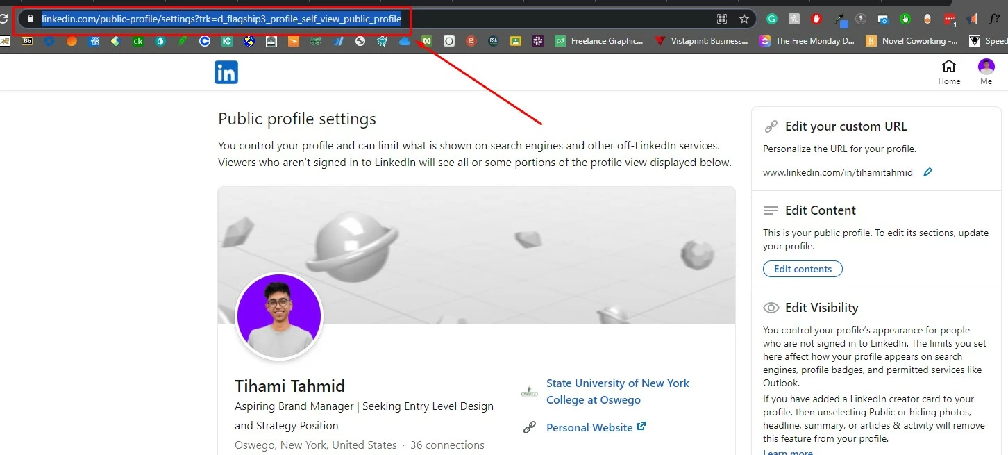

    I think I figured it out! Hers how you do it:
    * I was logged in during this process
    Step 1
    Go to your main LinkedIn profile and click the 'Edit public profile & URL' hyperlink in the top right.
    Step 2
    Now copy and use the long link, this directs to your public profile. This is my link -> https://www.linkedin.com/public-profile/settings?trk=d_flagship3_profile_self_view_public_profile
    Step 3
    Paste the link into your interactive element, hyperlink, or button, and hopefully say goodby to the red dot.
    // I'm not sure if this will work for everyone but it's the only thing that worked for me. I hope it helps, let me know if it does 🙂

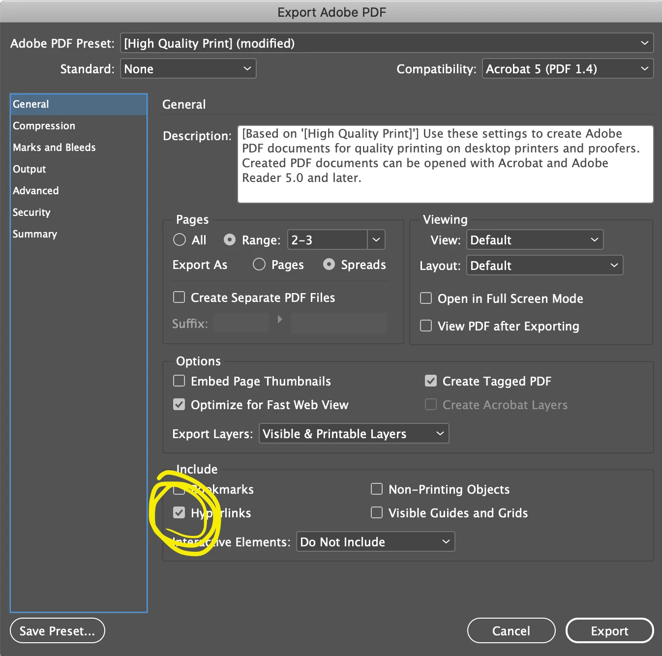

    When you press "Export" as PDF, you are shown "Export Adobe PDF" window. On its "Include" section below, tick "Hyperlinks."
