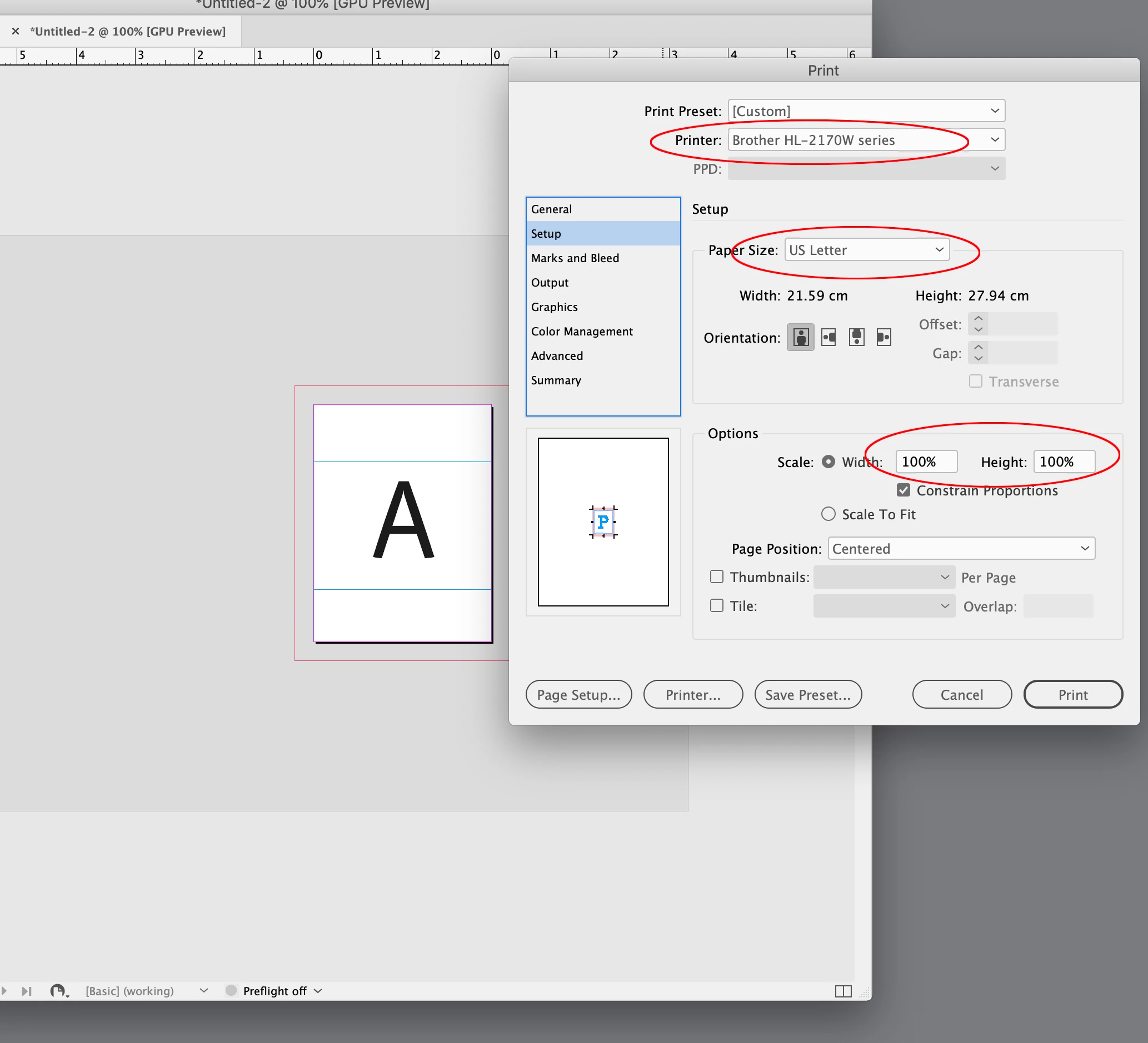

Hi @Maya22253560ah2d , are you also printing to a Brother laser printer? I’m not having any problems printing a 3cm x 4cm doc. Can you show us your Print>Setup tab?
