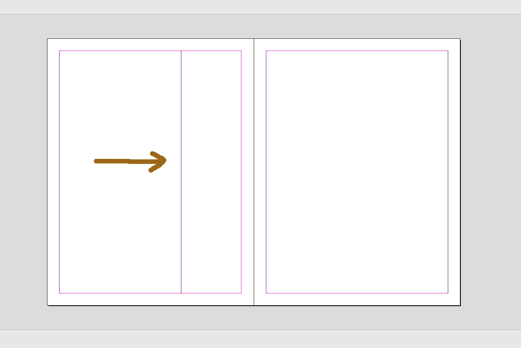

Hi!
I have a file from which I cannot remove guides. I can move it but I can't remove it.
I know of 2 types of guides: Spread guide and Page guide. But the Spread guide exceeds the spread margin and the Page guide ends at the edge of the page. It ends at the margins.
What kind of guide is it and how can I remove it?
Correct answer Barb Binder
That is an inadvertently unlocked Column Guide. Normally the column guides are locked, but if you unlock them you can move them. Just move it back and relock it.
You can also just change the number of columns from Custom back to 1.

I receive the file from client and this Column Guide are it was very close to the right margins but not over it and it complicate me when I wanted to snap object at the edges by resize.

I can't selet it, but can move. I don't know what is it but is not a box, or text box, or stroke, or any object. I hide all layes and has not disappeared. When I "Hide Guides", then it disappears. That's why I think it's a guide.
