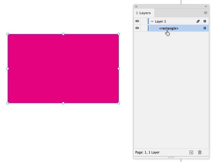

Also, I just noticed the position of your cursor matters when you make the two, single clicks. The hover has to be over the title with the hand icon—a hover over the layer, but not over the title will not work.
This works with separate single clicks:
But this does not:

I’m wondering if this could have something to do with OSX’s mouse double-click speed setting, which is set in System Preferences>Accessibility>Mouse&Trackpad? Seems like the complaints are coming from OSX users?

I think Bob is right—it‘s not actually a double-click, but two single clicks with a pause between.

Not seeing that behavior here. If all you want to do is rename, click the layer, wait a moment and then click the name of the layer.
That should let you rename it.
