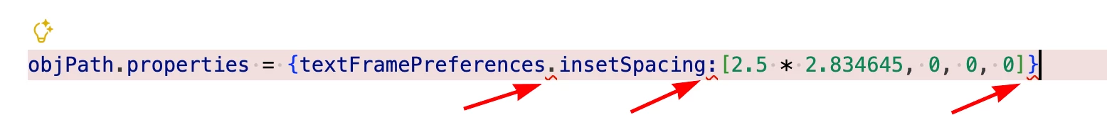

Can the “Inset Spacing” setting in the object style be written in the `properties` object?
Right now, I can only write it like this:
var objPath = app.documents[0].objectStyleGroups.itemByName(ObjStyleGroup).objectStyles.itemByName(myObjStyle);
objPath.textFramePreferences.insetSpacing = [2.5 * 2.834645, 0, 0, 0]
But I want to write it in the `properties` section, like this:
objPath.properties = {
textFramePreferences.insetSpacing:[2.5 * 2.834645, 0, 0, 0]
But that seems to be wrong.
What should I do?
    Also, you can’t use dot syntax inside the properties object. If I run your code with VSCode it throws an error and highlights the problems:
    ​@Eugene Tyson ’s code should work—this works for me where I’m setting properties, and nesting the textFramePreferences properties—VSCode doesn’t throw any errors on this line:
    objPath.properties = {strokeWeight:1, textFramePreferences: {insetSpacing: [2.5 * 2.834645, 0, 0, 0]}};
    When a property references an object with its own methods and properties (i.e., textFramePreferences) then this might be easier to read:
    //sets multiple properties of the object style object
    objPath.properties = {strokeWeight:1, strokeTint:50}
    //textFramePreferences is a separate object, so set its properties via objPath.textFramePreferences.properties
    objPath.textFramePreferences.properties = {insetSpacing:[2.5 * 2.834645, 0, 0, 0], columnRuleBottomInset:1, columnRuleOverprintOverride: true}

    dublove
    dubloveAuthor
    Jul 20, 2026 11:07 AM UTC
    Hi ​@rob day
    textFramePreferences: { insetSpacing: [2.5 * 2.834645, 0, 0, 0] },
    insetSpacing: [2.5 * 2.834645, 0, 0, 0],
    This is also incorrect.
    Not reporting an error does not necessarily mean it is working.
    It seems necessary to write it outside.
    Only this is correct
    objPath.textFramePreferences.properties = { insetSpacing: [2.5 * 2.834645, 0, 0, 0] };

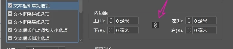

    Jun 15, 2026 3:05 PM UTC
    ​@Manan Joshi
    I tried that, but it didn't work.
    Do I need to unlock the “chain” in the middle?
    All the other settings worked. Like this one:
    enableTextFrameGeneralOptions: true,
    Jun 15, 2026 3:24 PM UTC
    Try enabling the object-style category first, and then set the preference separately:
    insetSpacing: ["2.5 mm", 0, 0, 0]
    You should not need to unlock the chain separately. The scripting DOM does not expose that chain button as a separate property. Passing four different values should set independent insets in this order:
    [top, left, bottom, right]
    If the four inset fields remain linked or unavailable, check whether the object style applies rounded-corner settings, as InDesign can restrict individual inset values on rounded frames.
