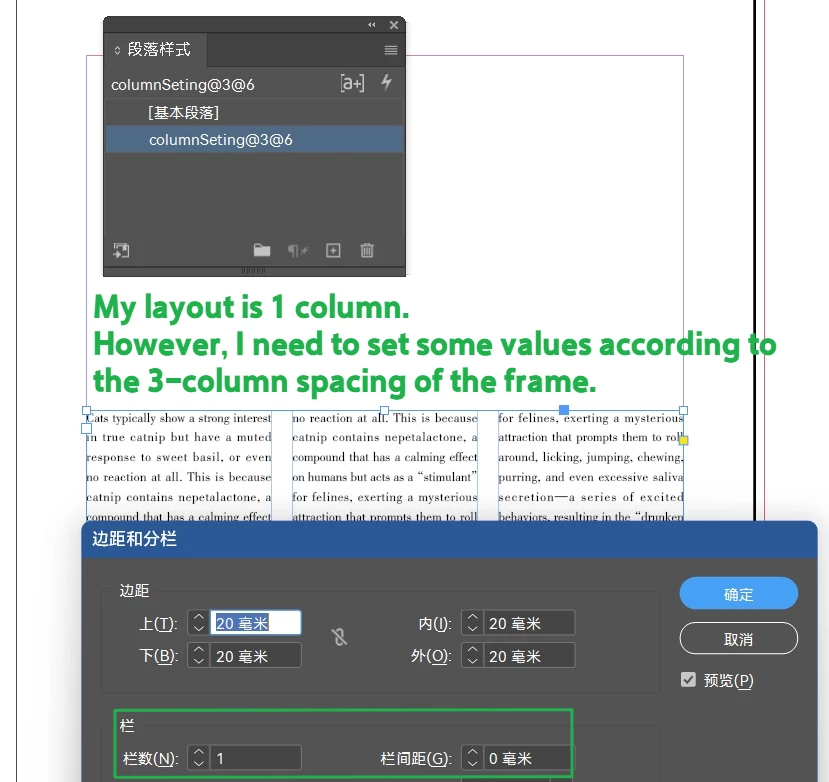

Can the script read the paragraph style name as a script setting value?
For example, my layout only has one column.
However, my text box has three columns with a column spacing of 6 mm.
But the settings for each ID document may be different.
If frequent switching may cause errors,
I came up with a solution to set 3 and 6 in a paragraph style.
For example, the paragraph style is named: columnSeting@3@6
When I run the script, it automatically sets 3 as the number of columns and 6 as the spacing.
Are there any other better methods?

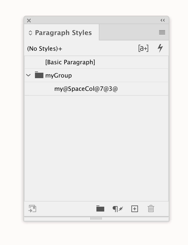

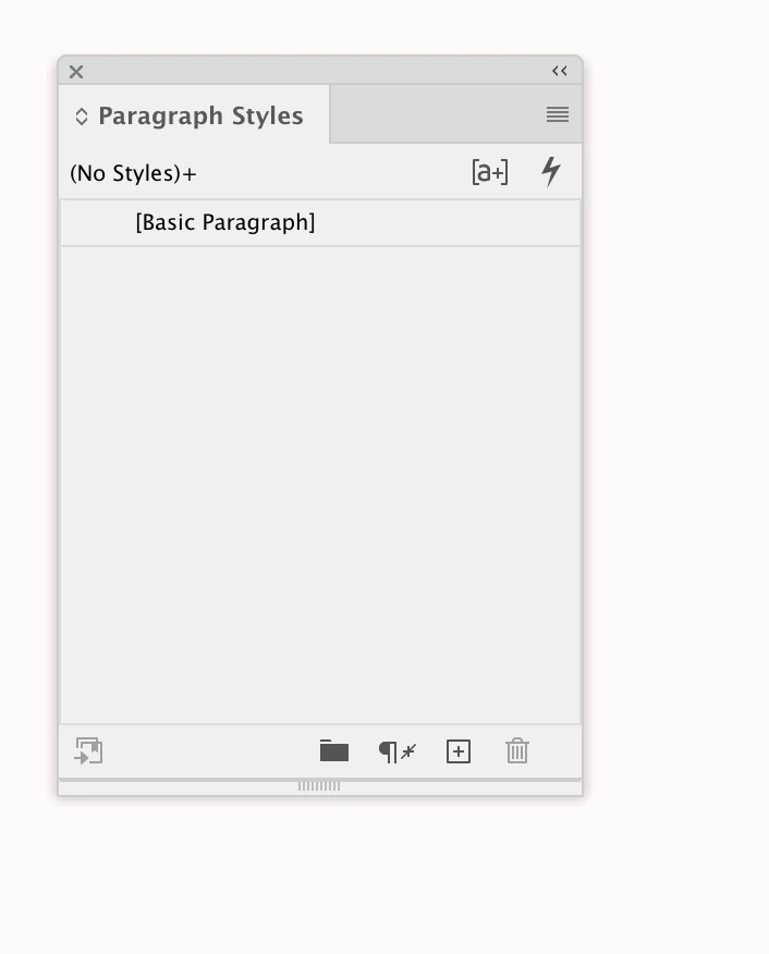

Are you referring to SetParGroup()?
I would like to assign certain paragraph styles to specific groups.
First, iterate through all paragraph styles. If SpaceCol is present, read the content after @ as csp and cn.
If not, create a new paragraph style named my@SpaceCol@7@3@.
Before the second checkColSet() check, add the following again:
var myParas = myDoc.allParagraphStyles;
This refreshes the paragraph styles.
This makes a group and returns a Pstyle if they do not exist, or returns the existing Pstyle if it does
var ps = addParaStyleGroup(app.activeDocument,"myGroup","my@SpaceCol@7@3@")
$.writeln(ps.name)
//returns the style’s name my@SpaceCol@7@3@

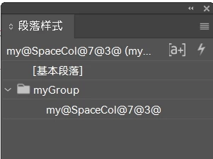

I did it, but I have some doubts.
Not found the first time, why is it still 0 after creating a new style?
checkColSet();
alert(csp);
alert(cn);
Is the variable occupied? Do you need to clear the cache?
Below is the complete code:

rob day
Aug 4, 2025 12:41 PM UTC
Your script throws multiple errors— myParas, cn, cps, colSetParStn are not defined
