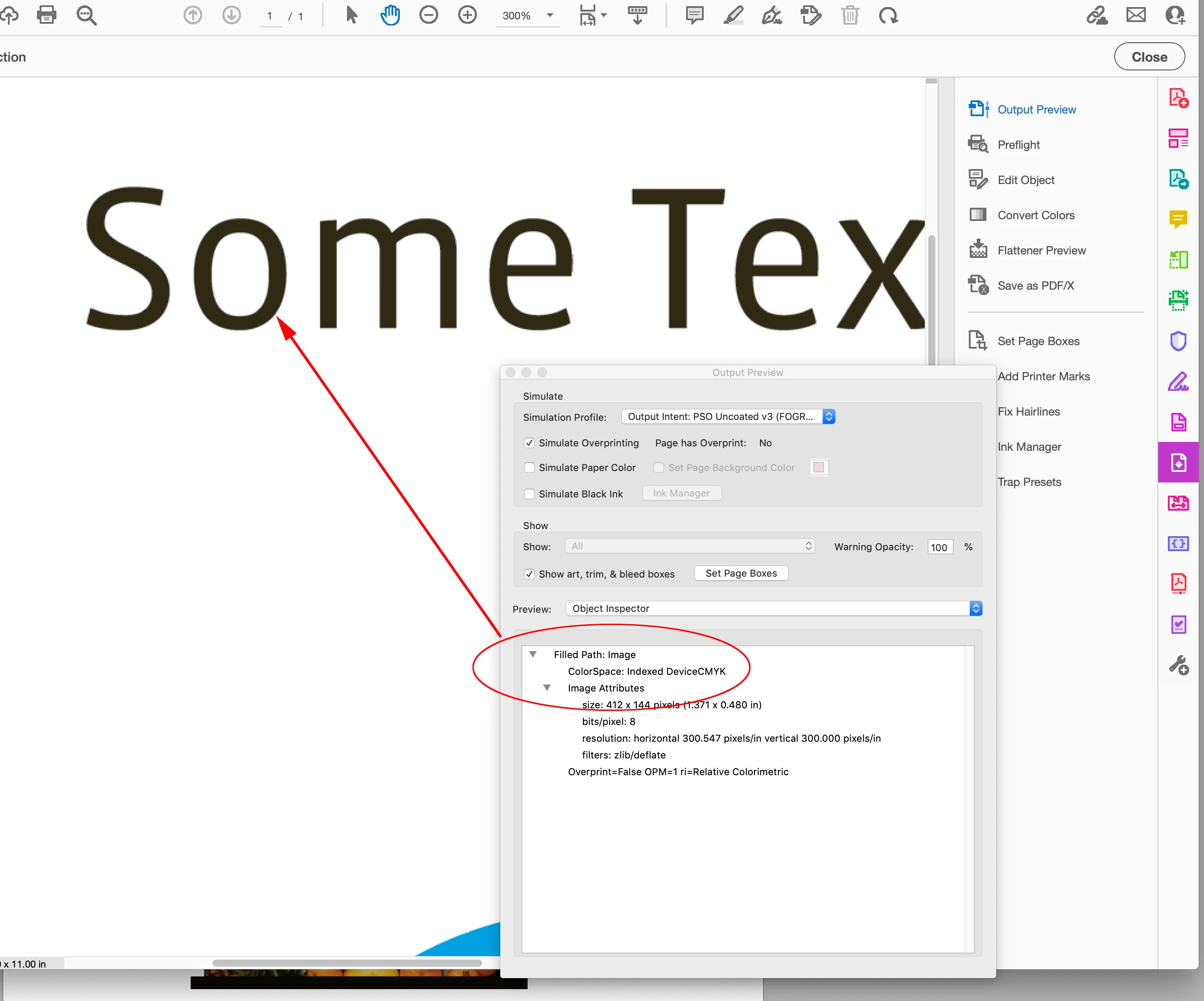

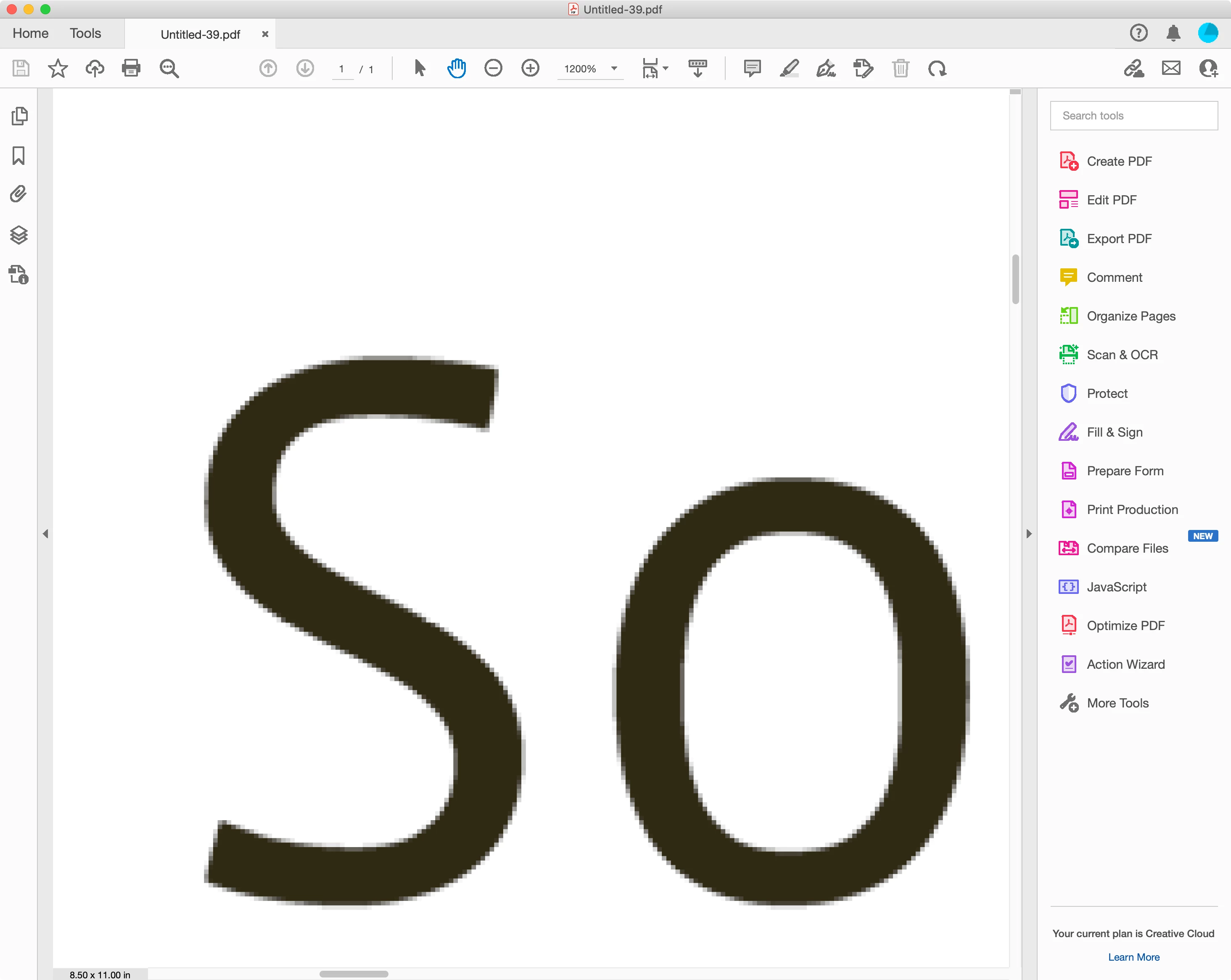

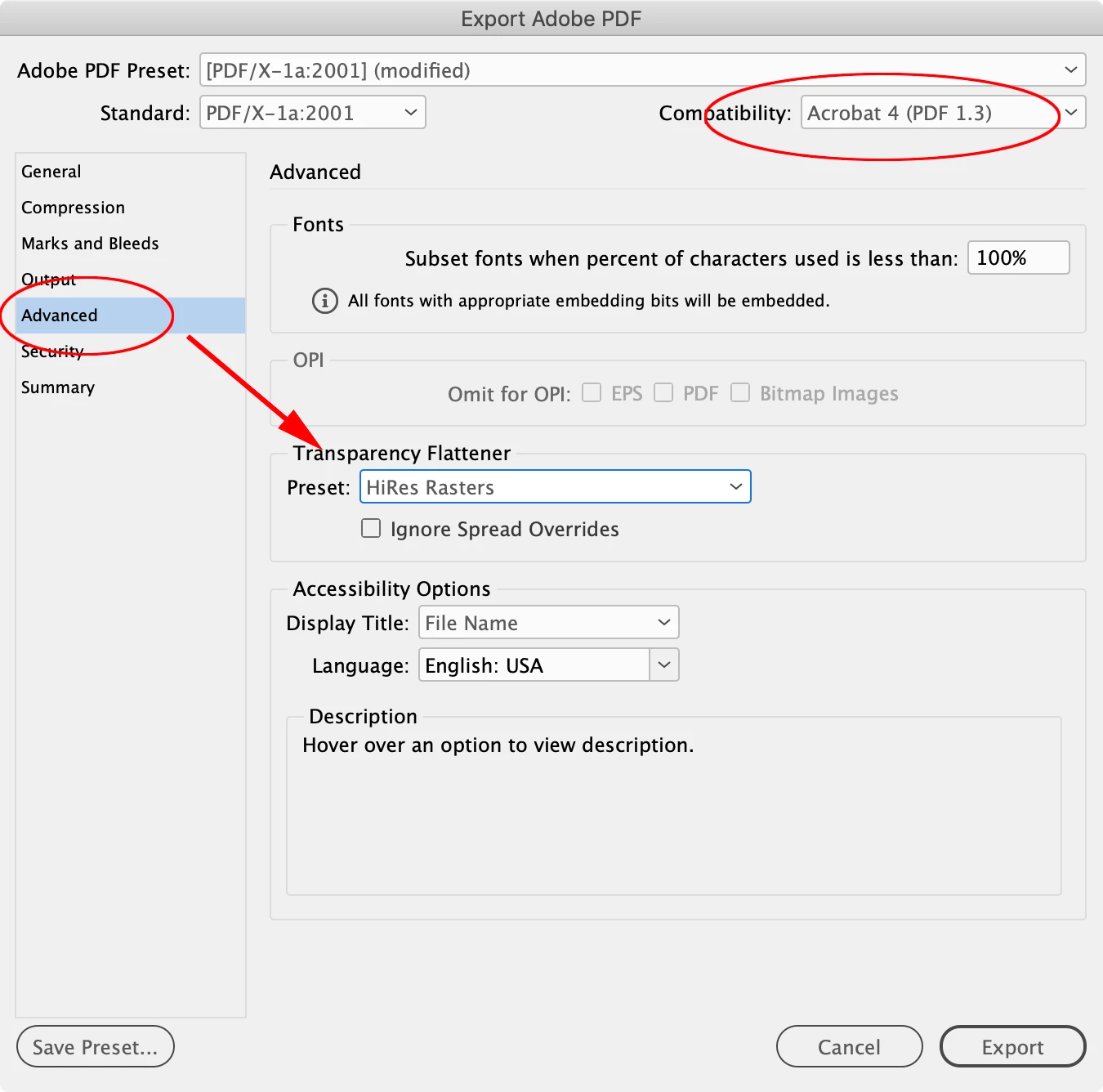

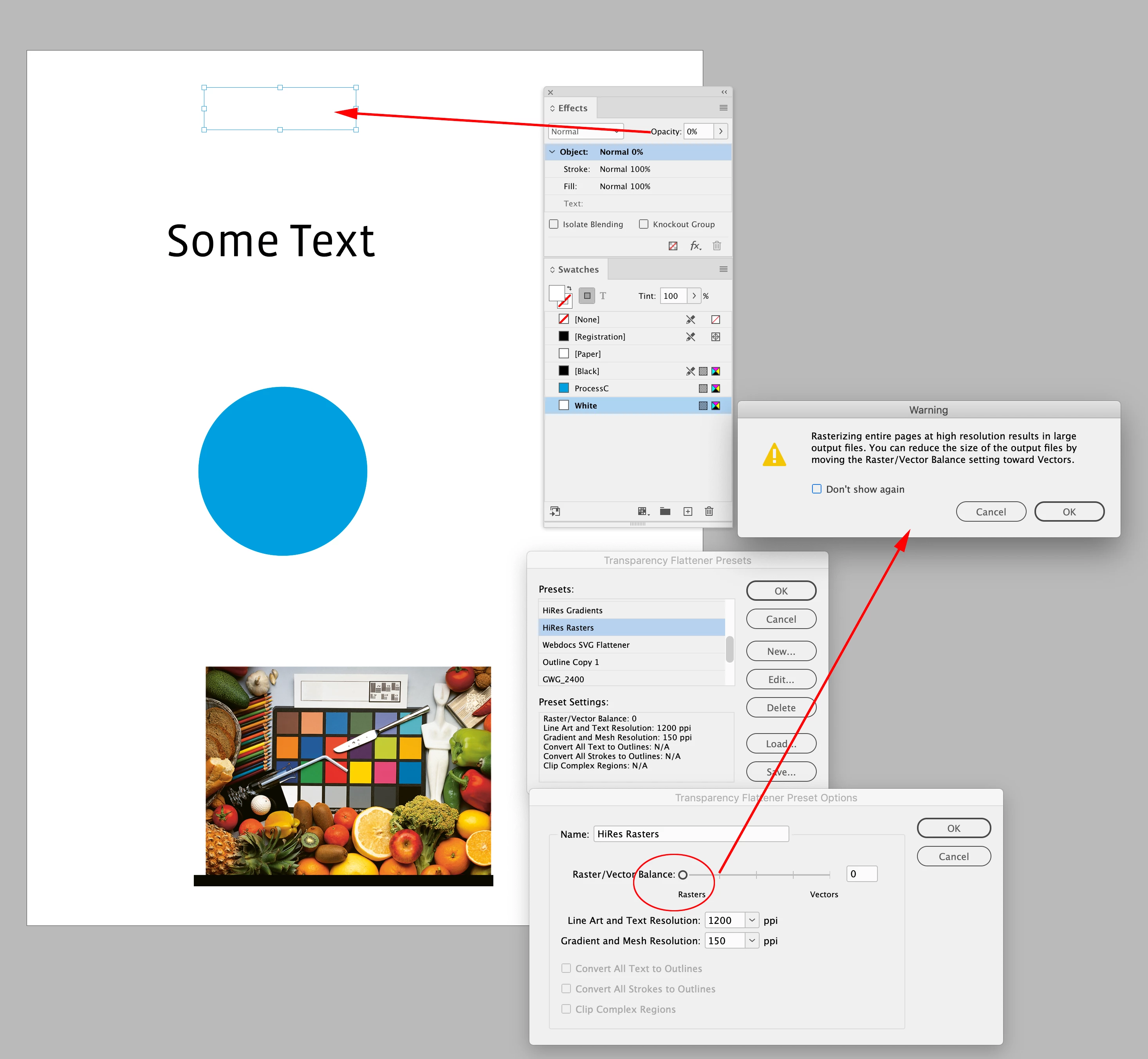

Hi @Under S. A page containing any transparent object, exported to PDF 1.3 Compatibility will use the Transparency Flattener Preset set in the Export>Advanced tab—create a Flattener preset that forces the entire page to rasters. You can place the transparent object in the bleed or slug of your master pages. So:

The Flattener preset can be set to any resolution, and the Compression settings will be used because the pages are converted to pixels—I got a 12 page doc with text and images to export at 188K with compression set to 72ppi.
