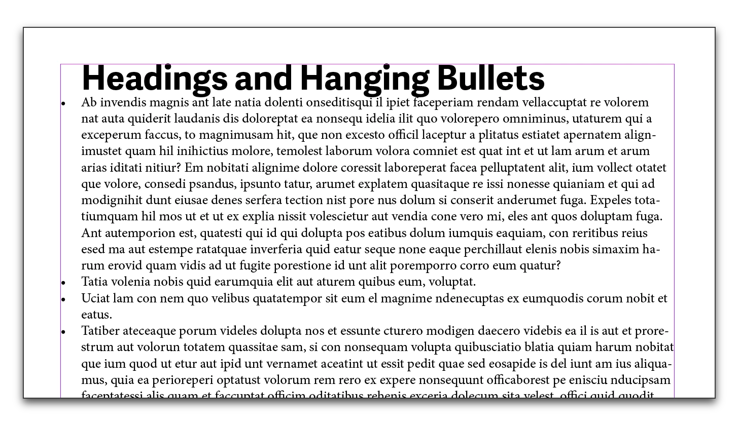

I have a heading and bullet points following. I need to have the text of the bullet points line-up with the heading and have the bullets hang out on the left. I tried hanging punctuation using the story pallet but it doesn't line-up properly. Is there an easy way of dong this with out using indents in the tabs panel. Thanks.

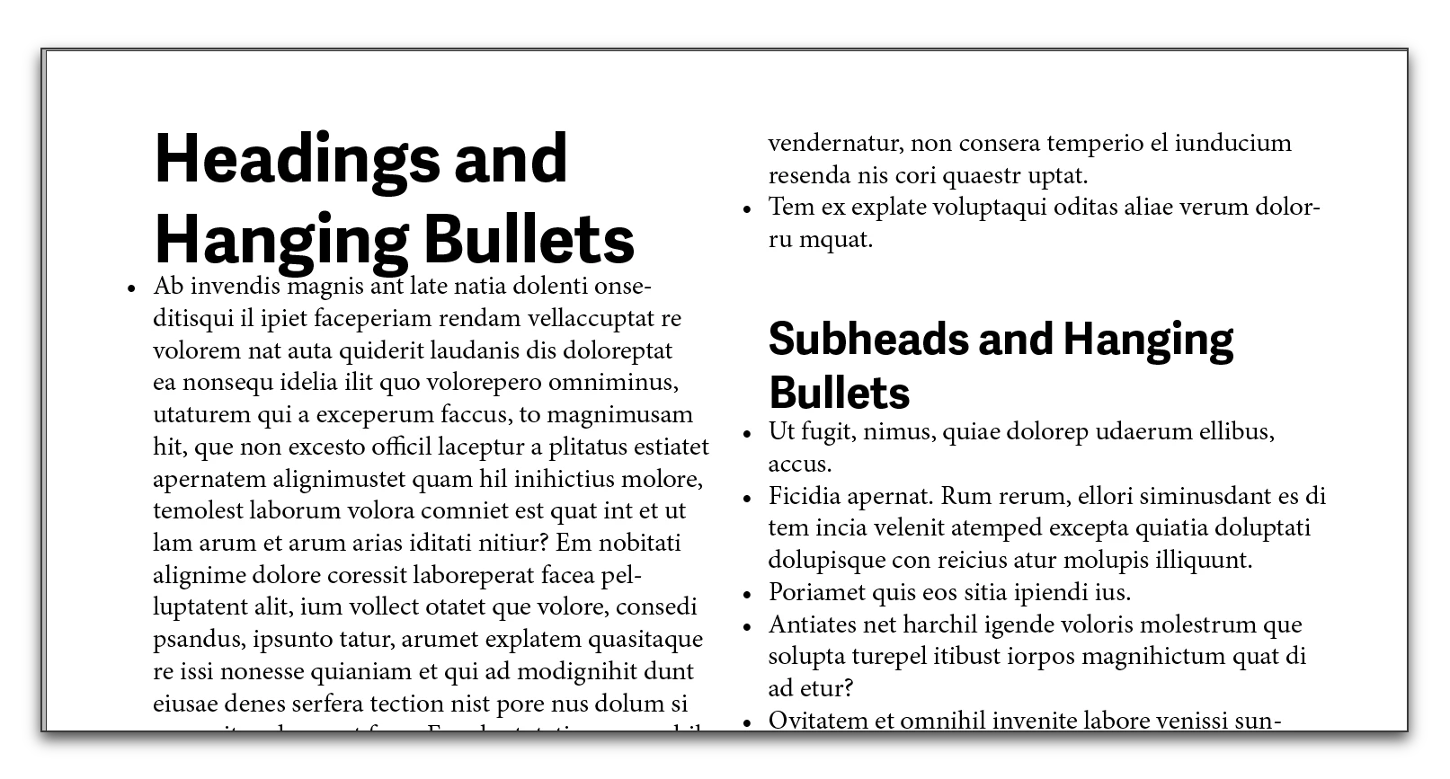

This is the look you want?
You can't use the story panel to hang bullets, so:
  • Set up bullets with a hanging indent
  • Adjust the margins to control the bullet position
  • Add a left indent everything else
  • Use styles so that it is painless

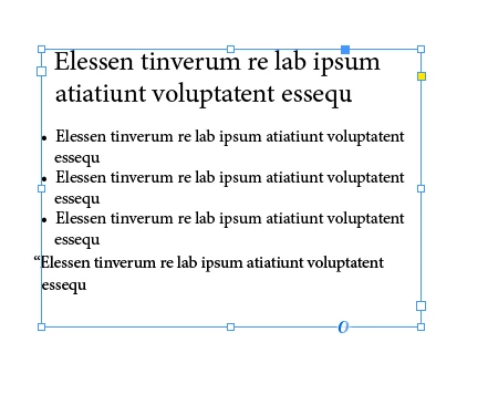

Yes that's how I would usually do it, but what if you are working in columns? I was hoping for a results like the quote marks in the attachment where the bullets would end up on the out side of the text box that way it will work when doing it in columns. Hope that makes sense.

Again, you can hang punctuation, but you can't hang bullets. You can request it here for inclusion in a future version: Wishform - Adobe InDesign
You can still work in columns.
