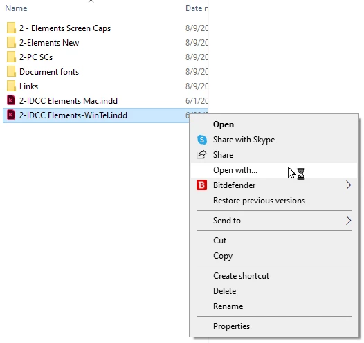

I believe can help you here. Let's go step-by-step through the process to do that with Microsoft Windows 10:
  • Open Windows File Explorer and navigate your way to one of your InDesign document files.
  • Click once to select the file, then right-click once to open the context-sensitive menu, as shown below.
  • Select the Open with... flyaway menu command.

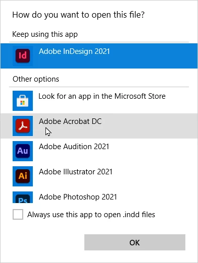

  • This opens a popup menu that will show first which program is the default for opening the .indd file. In my example below, that is Adobe InDesign 2021.
  •  Clicking on the More apps link will show you perhaps several options for other programs which may be able to open your .indd file. Many of them may be wrong. Scroll to the bottom and you'll see a link to Look for another app on this PC. Click that link.

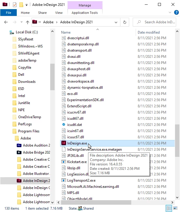

  • Navigate your way to your InDesign.exe file for InDesign CC 2021. By default, that should be stored on your [System drive (generally C:)]\Program Files\Adobe\Adobe InDesign 2021 folder, as shown below.
  • This will return you to the popup menu, now with Adobe InDesign 2021 shown at the top of the menu. Select the Always use this app to open .indd files check box, then click the OK button.
  • Now double-click the .indd file in your Windows File Manager, and it should open with Adobe InDesignCC 2021. Then go back to the file manager, pick another .indd file and confirm that it selects IDCC2021 as well.
