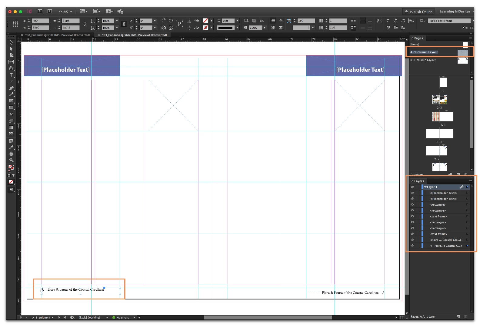

Hi Kyle—would you share a screen shot of your primary master page (usually A-Master but could have any name) with the Pages and Layers Panel open?

kylek74745887
Jan 3, 2017 8:17 PM UTC
I checked and all my layers are unlocked. (The option: Unlock All On Spread - is also grayed out)
HOWEVER, my page numbers are not listed in the Layers.
I was assuming that the chapter of my book project that has the - style source icon - next to it, is the Master page.
This also corresponds to what I believe i set up as the master page.
It's been a while now since I set up the page numbering.
Maybe now you can see where my error is.
Thanks!
Kyle

Jan 3, 2017 7:32 PM UTC
Kyle -
Are some of your Master Pages based on other Master Pages? If so, you would need to find the top-level Master page to make the correction.
