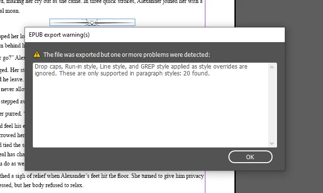

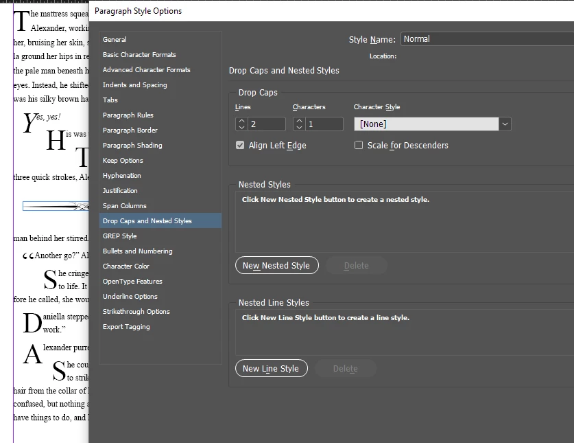

I've searched on the web and I can't seem to find how to fix this. I have an ebook which contains Drop Caps. When I export it to a Reflowable Epub, I get a notification that says: "Drop caps, Run-in style, Line style, and GREP style applied as style overrides are ignored. These are only supported in paragraph styles". The thing is, I can't figure out how to fix this. I know it says paragraph styles but when I use the Drop Cap Number of Lines option InDesign will not export the Drop Cap, and when I try to create it under Drop Caps and Nested Styles, it tries to capitalize every line. Does anyone know how I can fix this?

I've found a work around. Clear the formatting on the paragraph style used for the text, and then in Drop Caps and Nested Styles, set the Lines and Characters to 1. From there highlight the first letter of the paragraph that requires the Drop Caps and use the Drop Cap symbol under Paragraph to adjust it to how you need it to look. This exported fine for me.

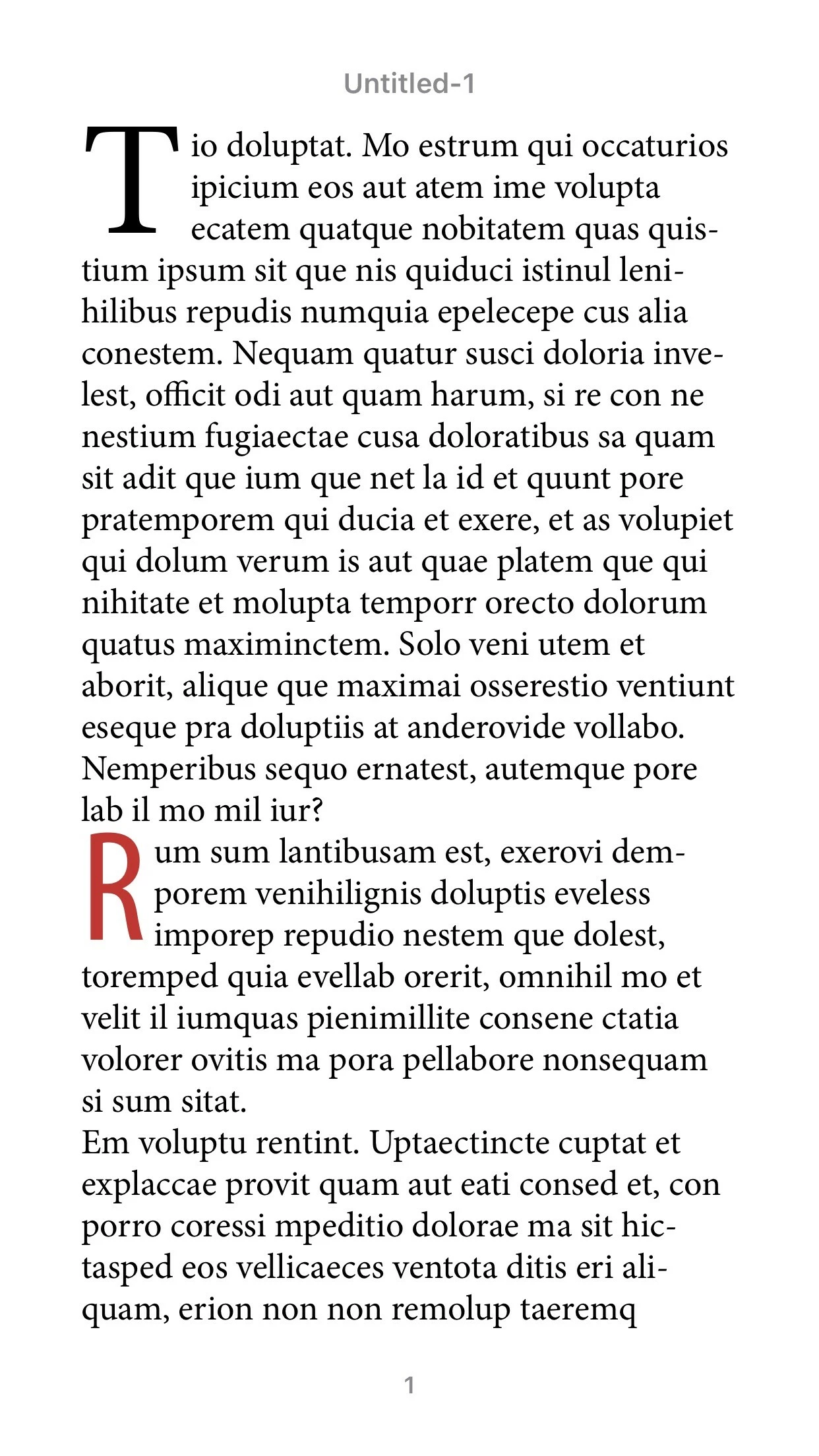

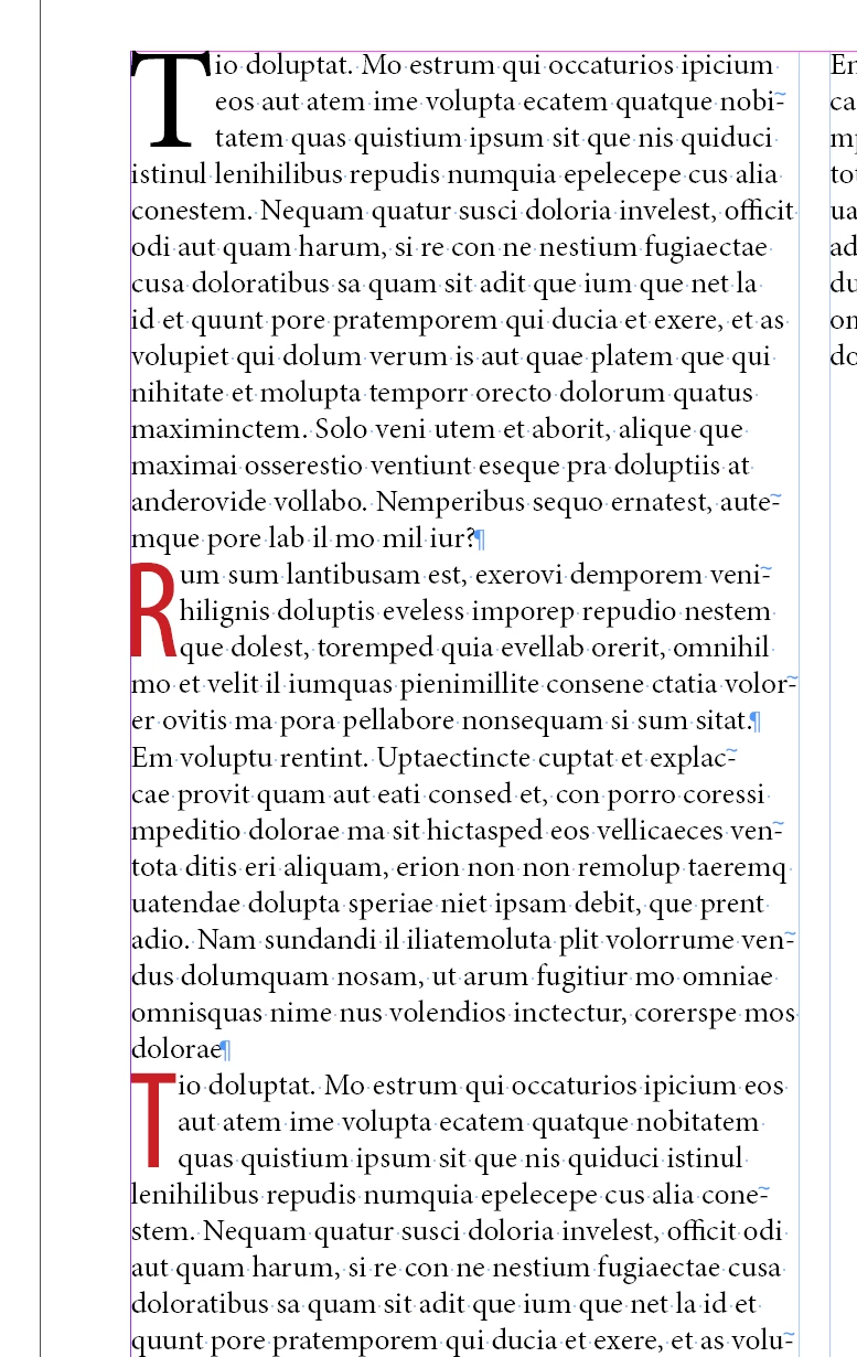

I just did a test of the following:
  • Para style w/ plain drop cap
  • Para style w/ drop cap and manually applied char style
  • Para style w/ drop cap with automatic char style
I exported to reflowable EPUB. It looked fine on my computer using Thorium Reader, and on my iPhone using Books.
InDesign:
iPhone screen grab (not showing entire export):

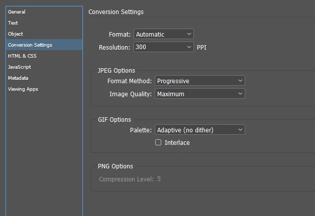

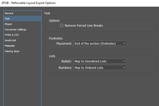

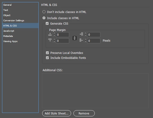

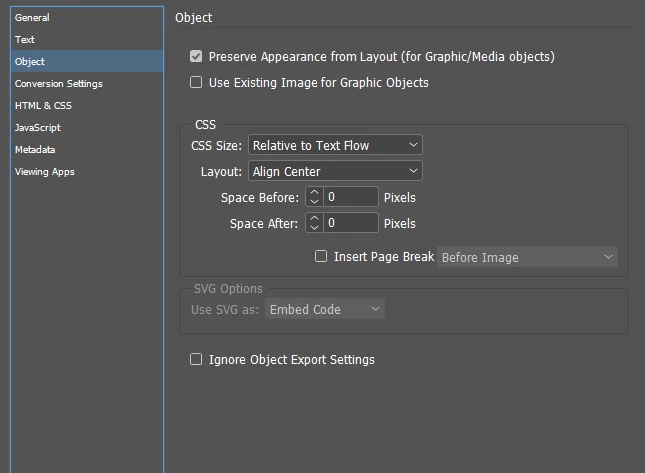

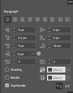

Sounds like there's some hope for this then. I'm on version 16.4. Here are my export settings.
Dave Creamer of IDEAS
September 4, 2021
I'm not seeing anything that should cause a problem.
