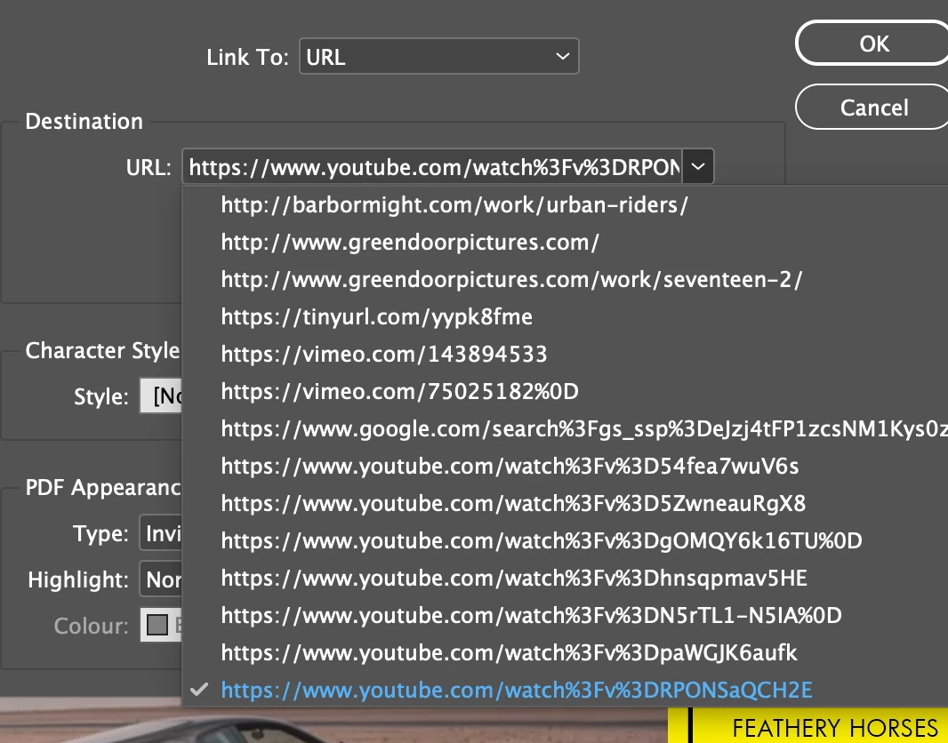

As I said, I get the same results with the escaped URL. By which I mean the one with %3F and so on. Get rid of that as I described "If I replace %3F by / and %3D by = the video plays."
These URLs are valid, but unusual, and they are being rejected by Google, so make them into normal URLs.
The Nice Things Studio
June 5, 2019
ok so I tried replacing in the hyperlink on the doc but it reverts to %3d. Sending out to pitch and asking people to replace characters in the URL on Chrome won't cut it as nobody will do that. Any other ideas?

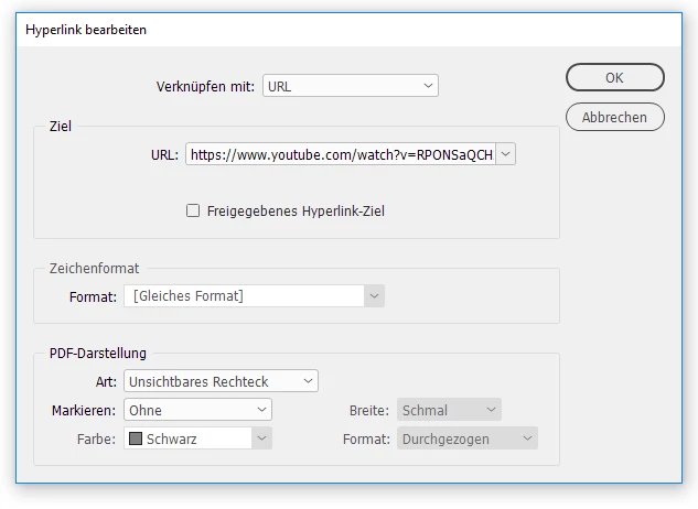

Hi Marion,
I have no problem to insert a hyperlink like the one you posted in reply 8.
German InDesign CC 2019 14.0.2 on Windows 10:
What's your exact version of InDesign?
What's your operating system?
Uwe

I can't really tell from your post because the forum mangles URLs. Does it use the URL escapes (%3F and so forth) when it is typed in InDesign?
June 5, 2019
Of course it does! Ok here's a screen grab - it's the one in blue
June 5, 2019
What does the URL look like when you enter it in Indesign?

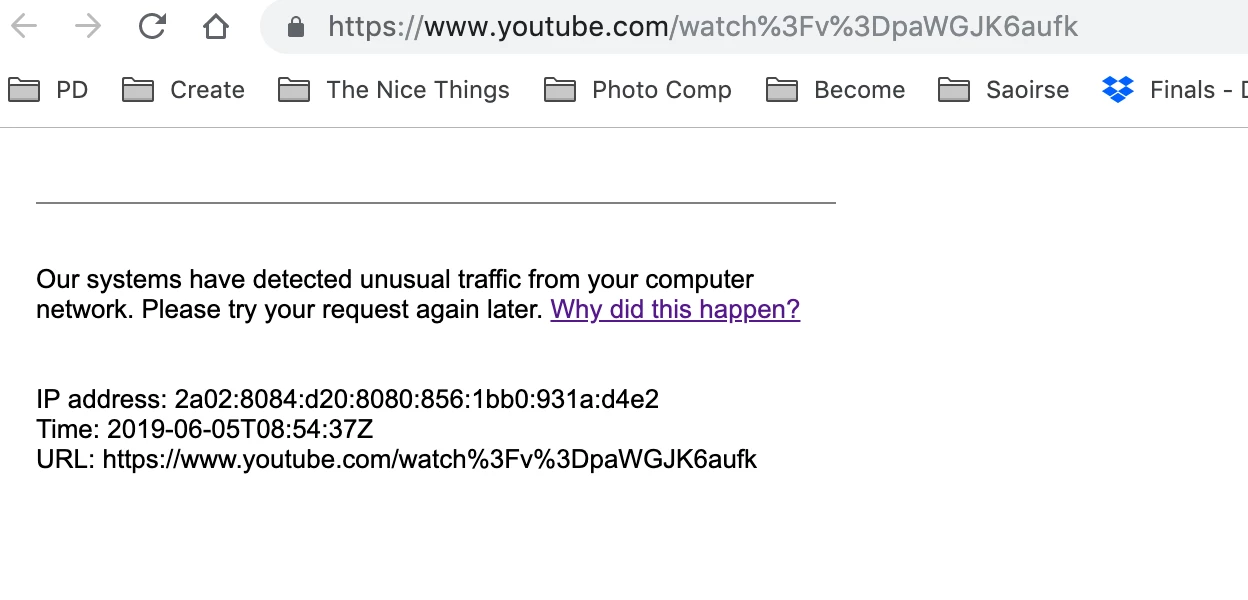

More details please. So you're adding YouTube hyperlinks that appear in the exported Pdf file. In Acrobat, you allowed all hyperlinks but now when you click on the hyperlink in ACROBAT, the hyperlinks aren't working? Do they open in a web browser? Where is the failure occurring?
June 5, 2019
Hi Chad, yes they do open in a Web browser, in Chrome. See screen grab attached. All other links are fine. It's just with Youtube
