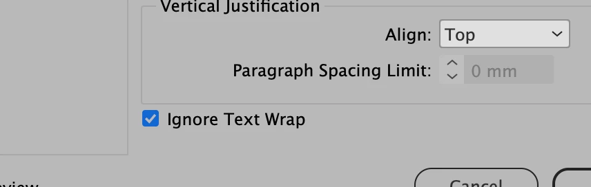

You can go to the Object> Text Frame Options
and tick the option for Ignore Text Wrap

Try this:  select Text Frame Options, found under the Object tab and tick Ignore Text Wrap.
