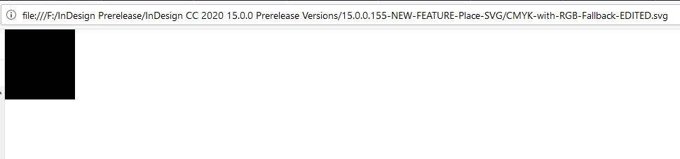

November 7, 2019
Hi yaws,
Mac OS X Preview app reverts to fallback color Black, because it will not interpret any fill color right, not the device-cmyk, not the #00A0E0 entry. The same with Firefox browser on Windows 10:

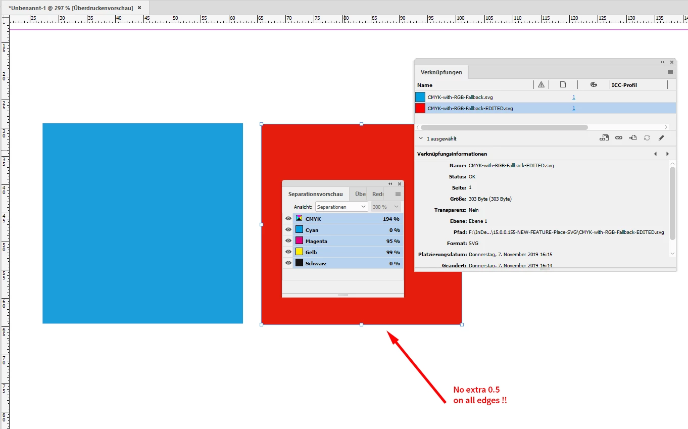

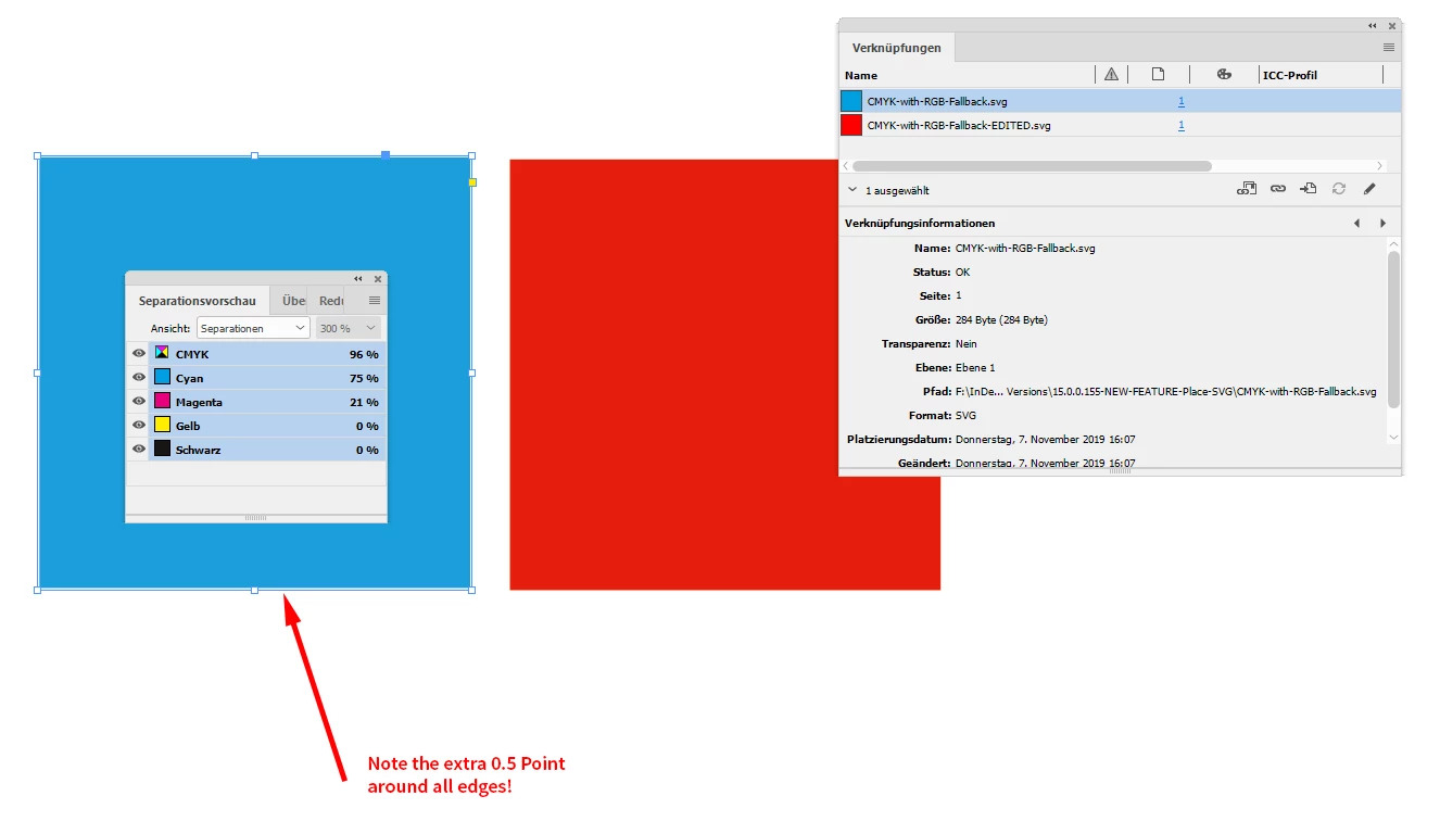

Hi yaws,
thank you for the SVG code:
<svg version="1.2" baseProfile="tiny" id="Ebene_1" xmlns="http://www.w3.org/2000/svg" xmlns:xlink="http://www.w3.org/1999/xlink"
	 x="0px" y="0px" viewBox="0 0 100 100" xml:space="preserve">
<rect fill="#00A0E0 device-cmyk(1.00, 0.00, 0.00, 0.00)" width="100" height="100"/>
</svg>
What happens here is, that InDesign is seeing a rectangle filled with color #00A0E0.
The device-cmyk entries are ignored. InDesign is using the RGB fallback.
FWIW: InDesign is also ignoring the viewBox entry "0 0 100 100".
It will honor x, y, width and height if that is defined in the same line with the viewBox entry.
Now edited with a different fill ( device-cmyk unchanged )
x="0" y="0" width="100" height="100" viewBox="0 0 100 100" xml:space="preserve">
<rect fill="#FF0000 device-cmyk(1.00, 0.00, 0.00, 0.00)" width="100" height="100"/>
</svg>
On the left your code placed:
On the right your code placed with the changes I did with fill and the added width and height values:
So the device-cmyk values are definitely ignored.

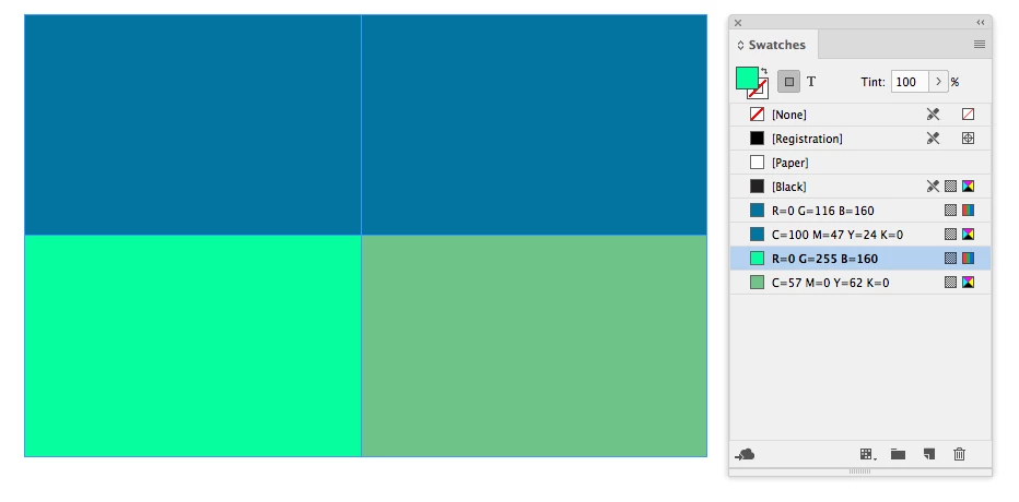

rob day
November 7, 2019
I don't think it's easy to match RGB to CMYK exactly.
If the RGB color is inside of the destination CMYK space, then a color managed conversion would match. Here the blue is in gamut so a color managed conversion from sRGB to US Web Coated SWOP is a perfect match. If the source RGB color is out-of-gamut, like the green below, then there can’t be a match:
If you need a specifically built CMYK color, something like 50% gray, or 10|0|0|40 gray, or 100% black; then color managed RGB conversions would be a problem because the conversions are always managed. Most common CMYK profiles convert one color grays into their 4-color equivalent.
