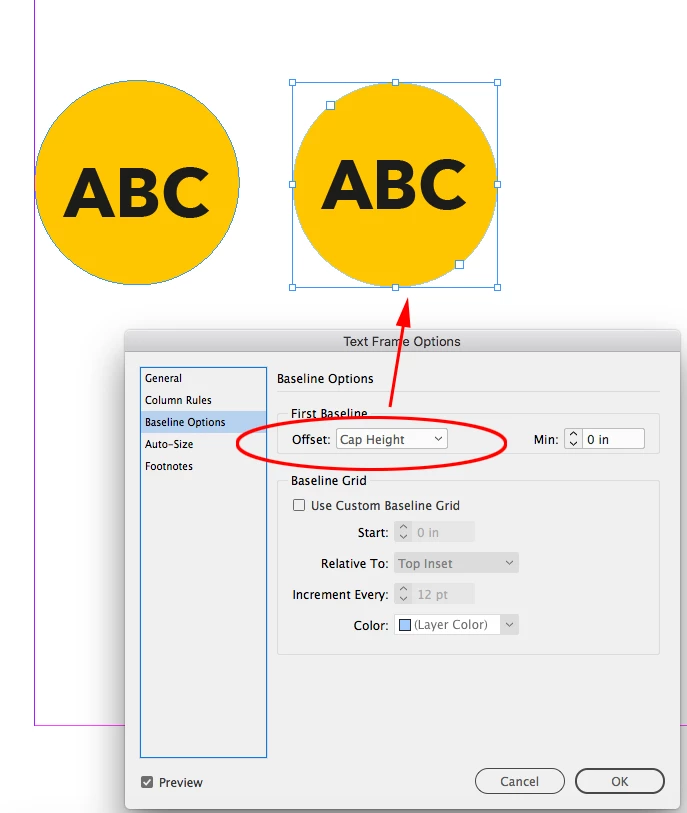

    rob day
    November 25, 2020
    This thread is 10years old, so you might want to post a new question. You shouldn’t need a script, I don’t think any of the answers note that the First Baseline Offset determines whether all caps will center vertically. Left the first baseline is set to Ascent, right it’s Cap Height

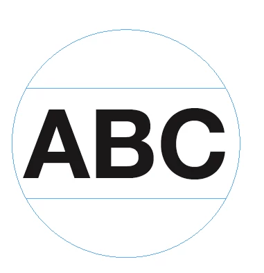

    January 22, 2010
    Insert a Table
    Make the table with no stroke and no insets
    increase the size of the table to the height (or near height of the circle)
    Vertically center the Cell, and center the text
    OR
    Use an anchored object - my screenshot needs a bit of tweaking
