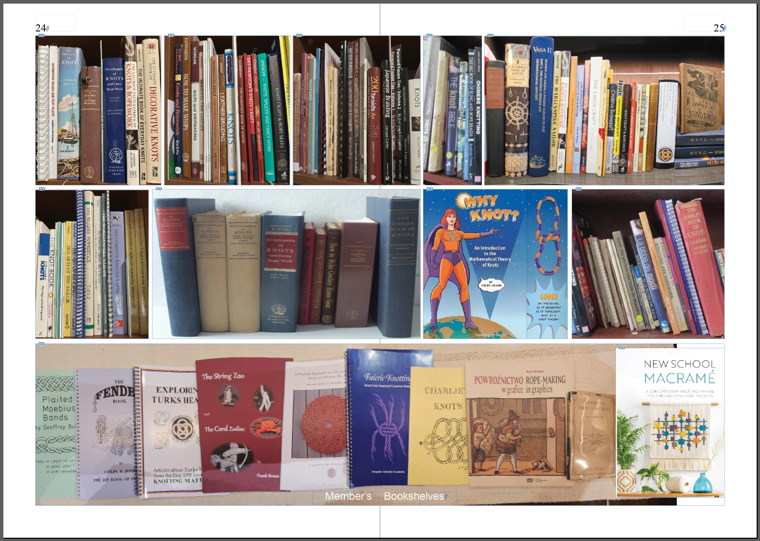

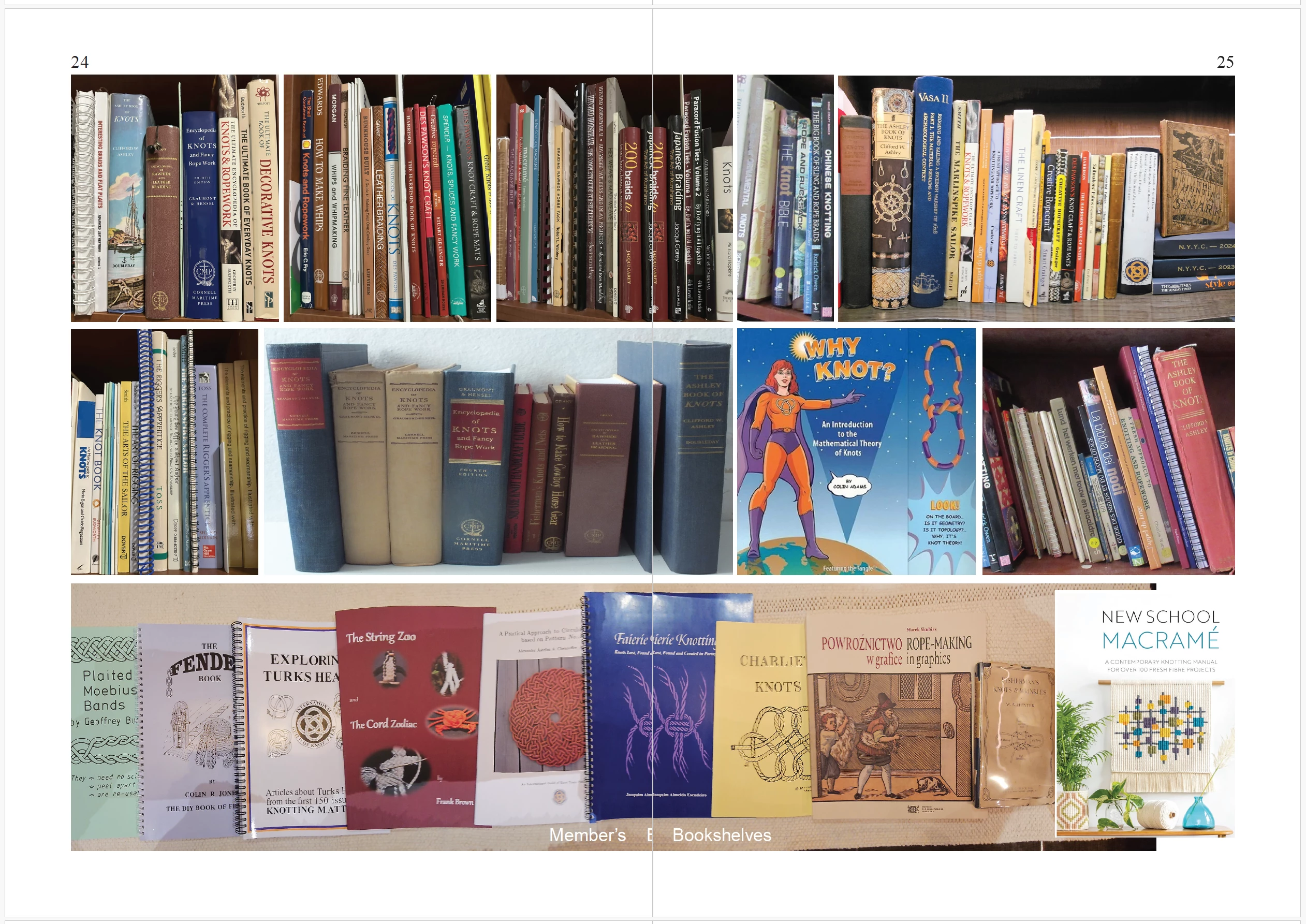

I probably need another 'master' to cover the middle spread of my magazine, but I could use help.
See what I see in Indesign versus what I see in the Exported PDF.
What do I do to make the Centerfold of the pdf match the spread in InDesign?
InDesign on top, Exported PDF below.

Do you have inner bleed added? And is bleed included in the PDF output?
Inner bleed is useful in production as it means the prepress imposition can be shifted and trimmed correctly in position so that the images marry up - without it it could be awkward to impose properly.
If it's for production then you an change your Inner Bleed settings in the PDF output options.
If it's for digital online or not required to print professional you can make the PDF without bleed.

It is for Production and your helpful query, got me to look closer at my Export settings.  I had two problems: I removed the inner bleed as you suggested and I now Export As Spreads versus Pages.
I now get a 'centerfold' image in my PDF as it appears in InDesign.  Thank you.

But if you want to print it in a printshop - with all the bells and whistles - you shouldn't be exporting as spreads - but as single pages - and people at the printing place will do imposition.
If your publication will be stitched - printed as a booklet - as you've 48 pages, your image will be prefectly fine after imposition.
In case of more pages and different finishing - it's more tricky or even impossible to have it "in one piece" in the printed publication.
