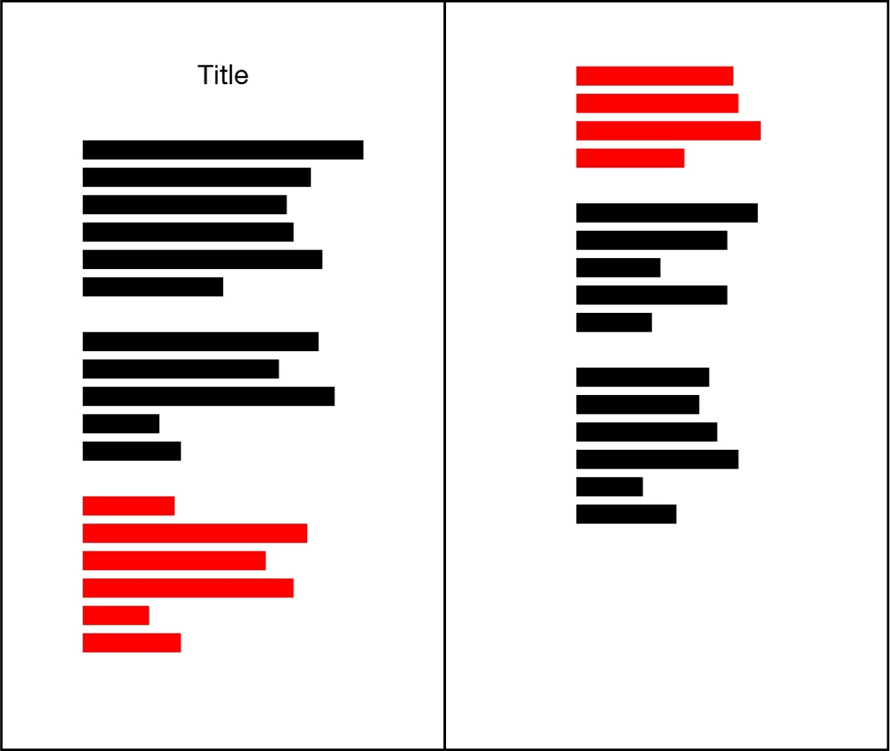

I am working on a book of poems. I need to make sure that the (left aligned) text running within each page is centred on the longest line. As far as I am aware there is no mechanism for doing this automatically in inDesign and besides, the optical centre will always be different from the actual centre.
So I need to manually add an indent to every page to indent the text until it feels centred on the page. My problem is that some of the stanzas/paragraphs run between two pages which each need different indentation. I can only apply indent to a whole paragraph, meaning it will effect the beginning of the paragraph on one page and the end on another. If the second page requires a different indent this means the end of the paragraph that has run over from the previous page will indented correctly for the previous page and not the current page or vice-versa.
Is there any sensible solution to this problem?

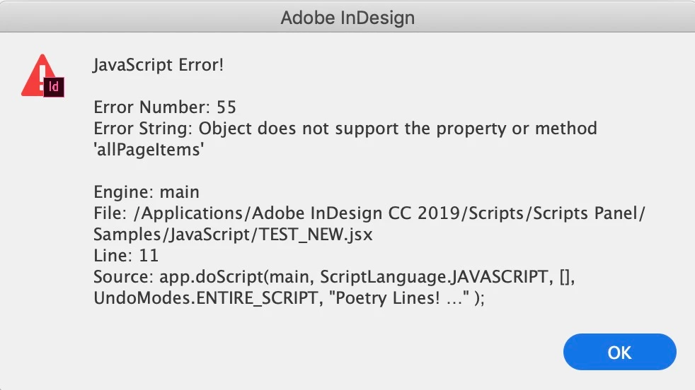

    Nov 22, 2019 9:20 AM UTC
    Mike_Jensen_TG said: I've tried Obi-Wan's script, but it doesn't seem to work, and not sure why.
    Hi Mike,
    what exactly does that mean?
    Is there an error message?
    Is the result not the result you are hoping for?
    Something else?
    Uwe Laubender
    ( ACP )
    Nov 22, 2019 5:57 PM UTC
    Hi Uwe,
    This is the error I get (Indesign CC 2019):

    Aug 13, 2017 1:18 PM UTC
    Screenshots!
    Aug 13, 2017 1:54 PM UTC
    Hopefully this will help. In this example, the paragraph in red runs over two pages, but each page needs a different left indent.
    TᴀW
    Aug 13, 2017 2:09 PM UTC
    Each line should be a separate paragraph.
    When you need extra space between the stanzas, use a different paragraph style that has that extra space.
    That way you will be able to control the indents of individual lines within each stanza independently.
