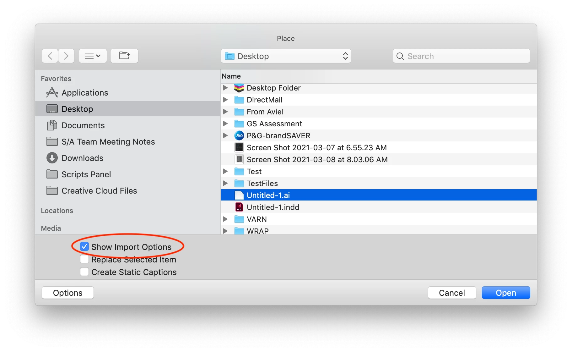

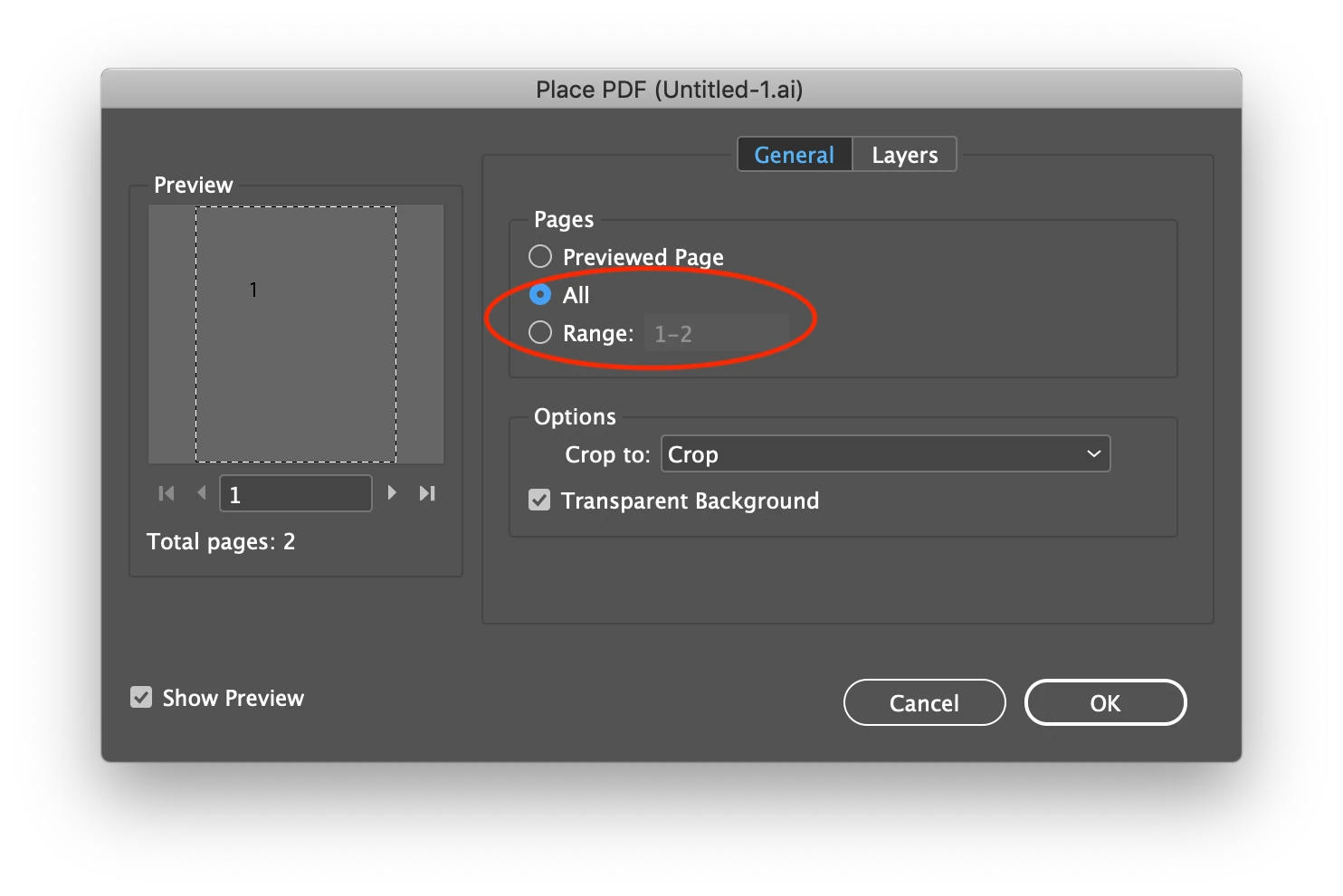

Thank you for your answer. Maybe I didn't explain the issue in the best way. On Indesign I have linked an .AI file, that contains inside several differently illustrated artboards. Indesign let me visualize automatically only the first artboard. I would like to show also the other ones. The expansion of the image frame doesn't work, so I guess there should be an option to active each single artboard.
March 18, 2021
When placing .AI file that contains several different artboards, each artboard needs to be placed separately to be viewed in Indesign.
You can do this in one go, just check on Show import options then place dialog select all or a range of artboards to be placed.
