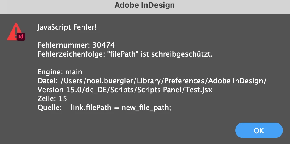

I would probably then have an InDesign server process it that way. But now I have the problem that this property is read-only.
I have also tried running the following, but to no avail:
filePath.readonly = false;

In InDesign I get the Error (filePath is a read-only property):
Do you have any idea? I hope you can help me.

This script would work, if it should relink, but it shouldn't.
I just want to change the string in the filePath of the link. But it's not possible because it's read-only.
links[i].filePath = newLinkedFile;
I would like to do something like this in the for-loop. But I think it's not possible, right?
It's not possible to change the filePath-Property to write too instead of read-only, right?
