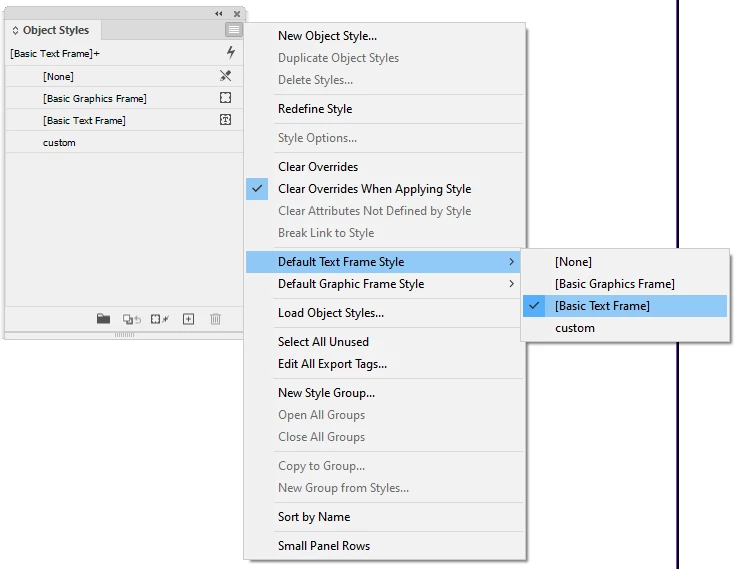

You can set an object style as the default style for text and graphic frames in the Object Styles panel:
That way the style is applied to all new frames.
August 23, 2023
Thank you @Peter Kahrel for your reply,
This method seems works manually,thanks for the advice, now i have to recreate it programmatically.

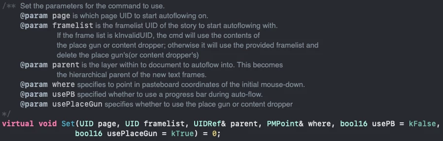

I already tried this method but unfortunately it doesn't work because the method I use for the overflow seems to create new boxes with no style applied, even though the parent has a certain style applied, maybe i leave a photo of the method i use.
i also tried to set default style and default text style to object style that i want to apply to box, but nothing to do it doesn't work.
