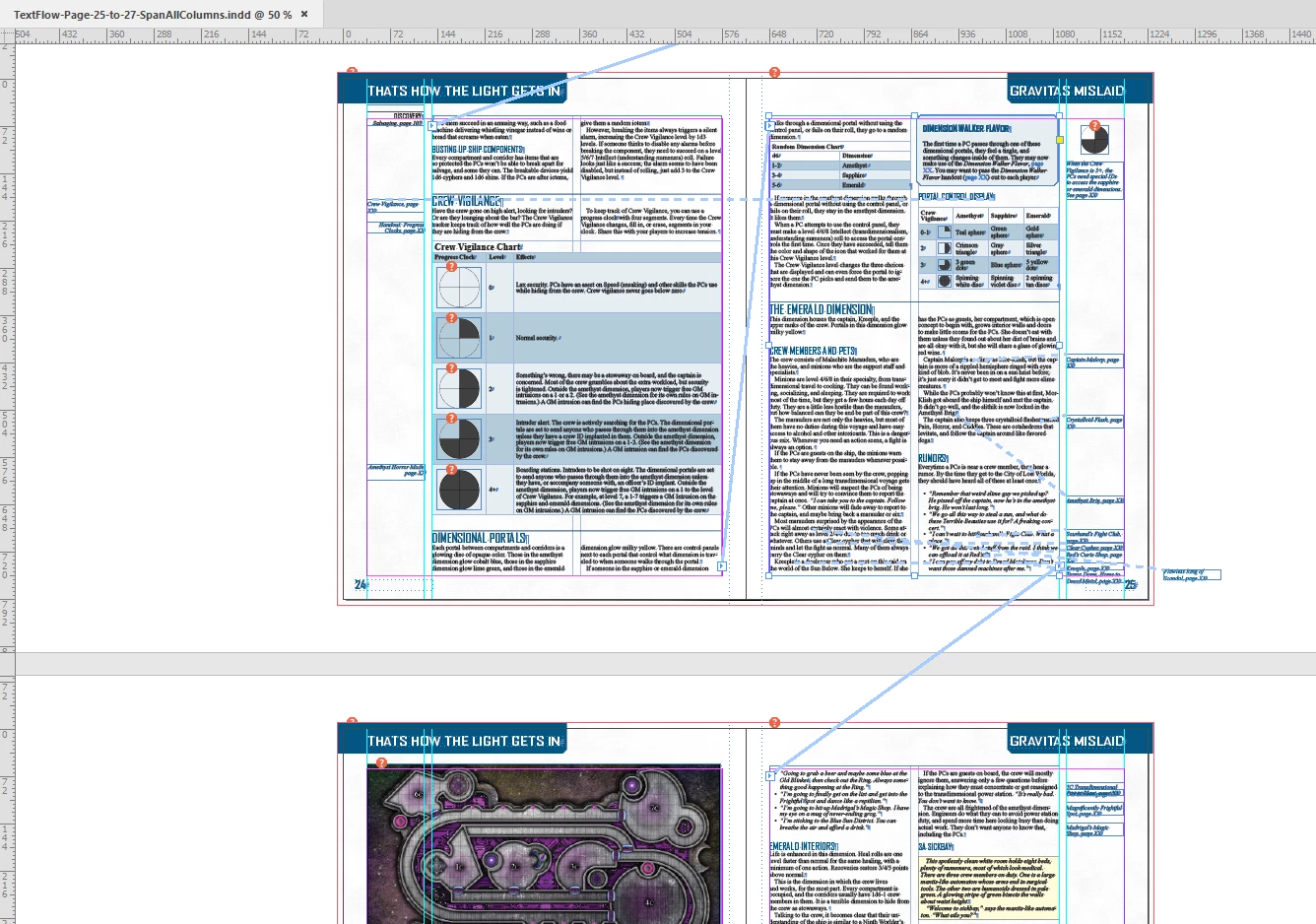

I have a span columns all header paragraph style. It works fine a few times, then it causes the paragraph to jump to the top of the next page.

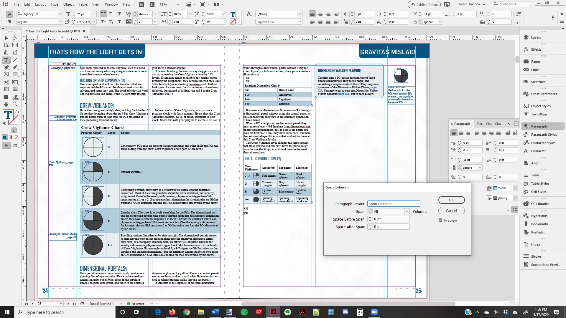

On the left page (above), the text "Crew Vigilance" and "Dimensional Portals" is "span all columns" and it's working fine. The table "Crew Vigilance Chart" also spans columns and is working fine.

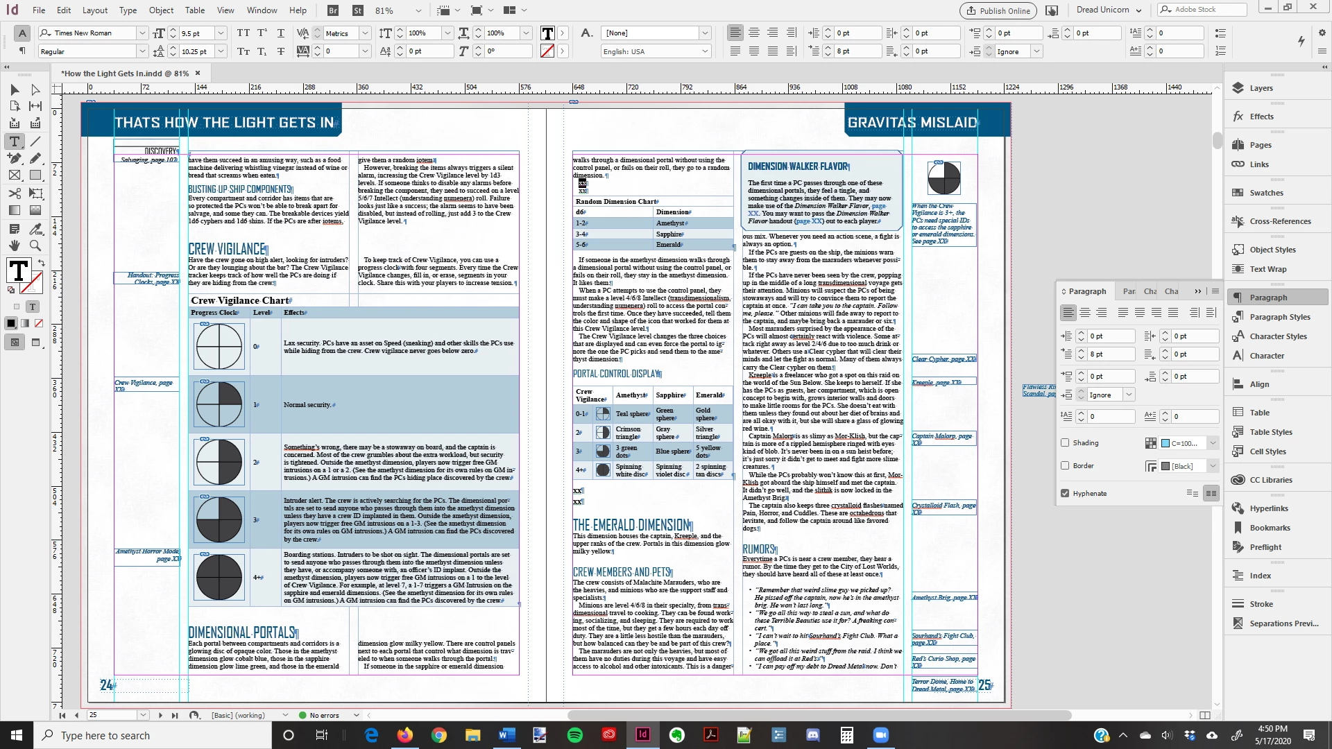

On the right page (above), I had to set the text "The Emerald Dimension" to "single column" to get it to stay on the page. Otherwise it jumps to the next page:
At first I thought it was the paragraph style in question. So I inserted some XXs in both my normal paragraph style and [Basic Paragraph]. If I set any paragraph on the right hand page to "span columns" it jumps to the next page.
I'm kind of stumped here. Any ideas?

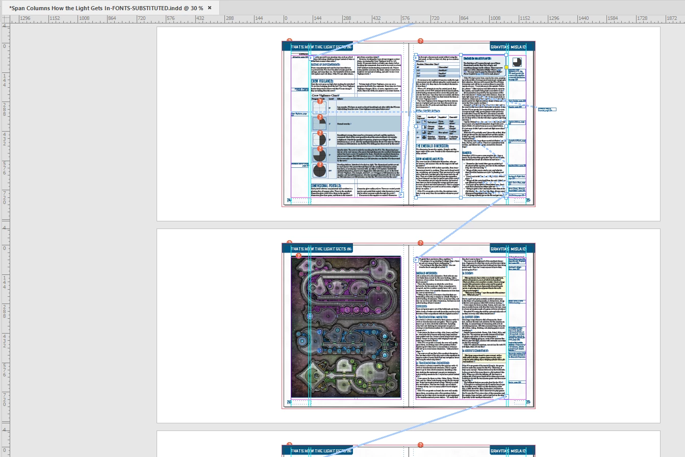

As far as I can see, the cause of this issue is on page 26:
A placed image with a frame that is set to text wrap.
I see two solutions:
[1] Remove the text frame stacked below the graphic frame on page 26.
[2] Anchor the graphic frame on page 26 to the main text flow.
Solution [1] in screenshots:

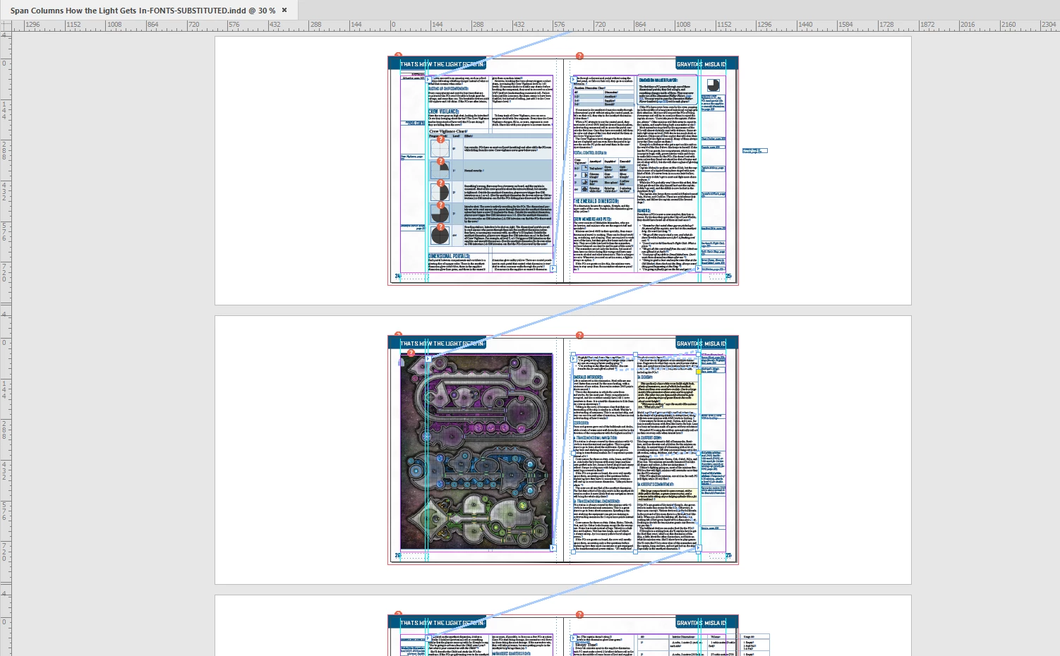

Text frame on page 26 removed, text flows from page 25 to 27:
Span Columns changed to Span All on page 25:
