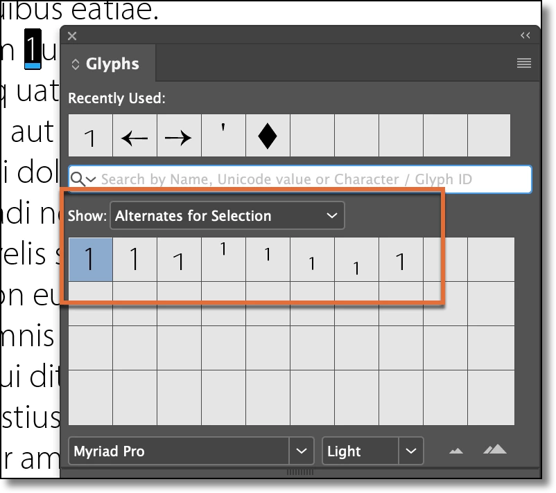

  1. Type a number in a text frame.
  2. Select it, and point to the blue bar underneath. Do at least two options appear?
  3. If so, click the triangle to open the Glyphs panel:
  4. Hover over the number style you want and tell us what it says on line three (above the name).

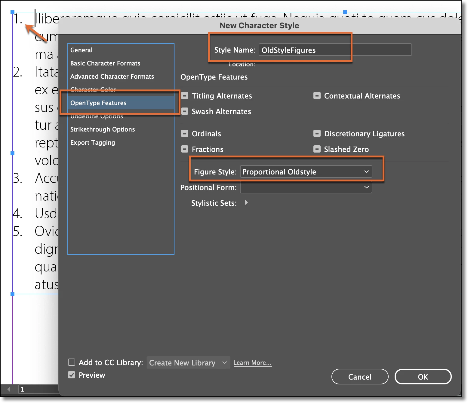

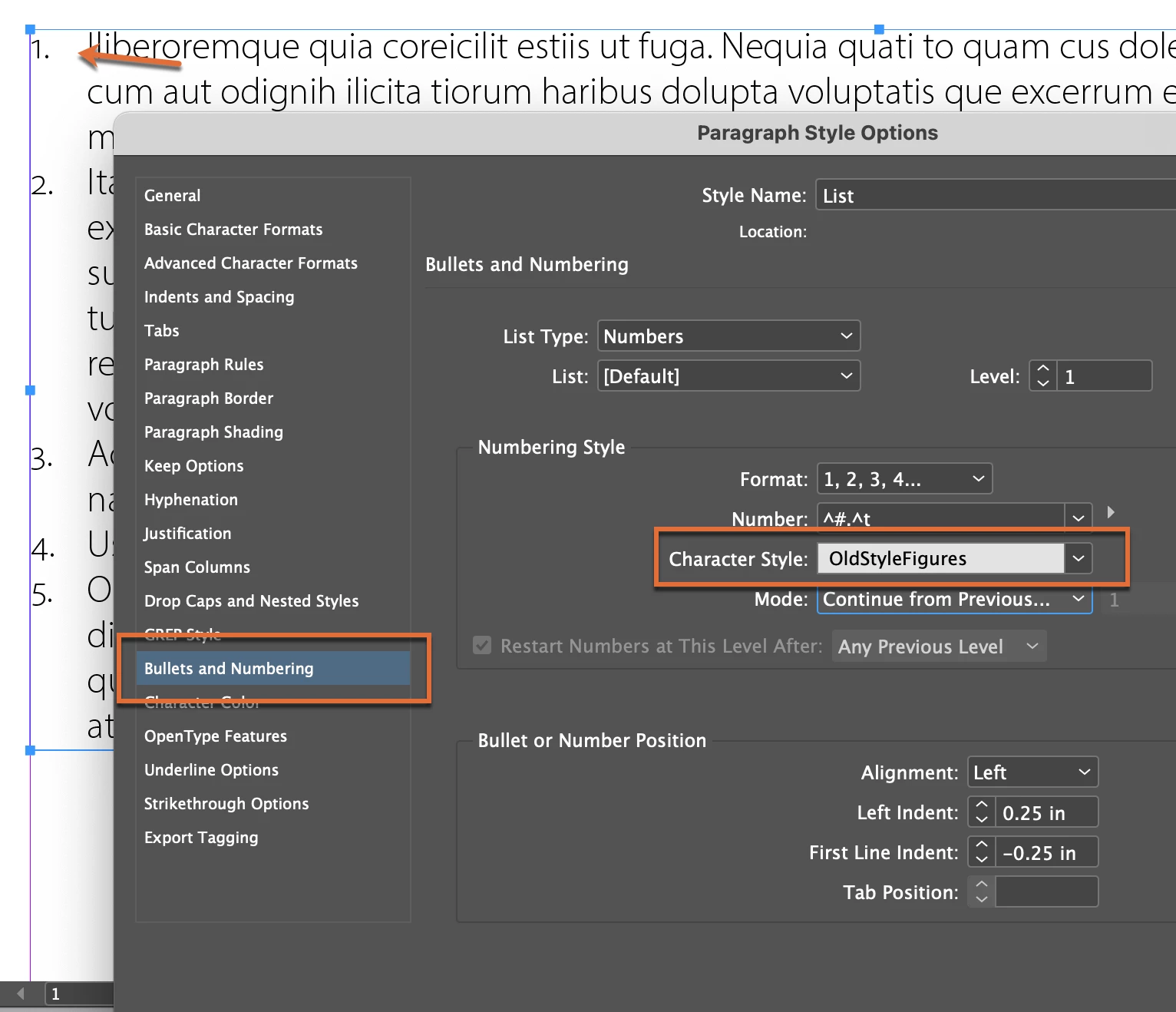

Set this up by nesting a character style in the list paragraph style.
If the font offers the second figure style that you are showing us—and I assume it does because you are showing us—create a character style to change the figure style. For example:
Then assign the character style to the List paragraph style.
