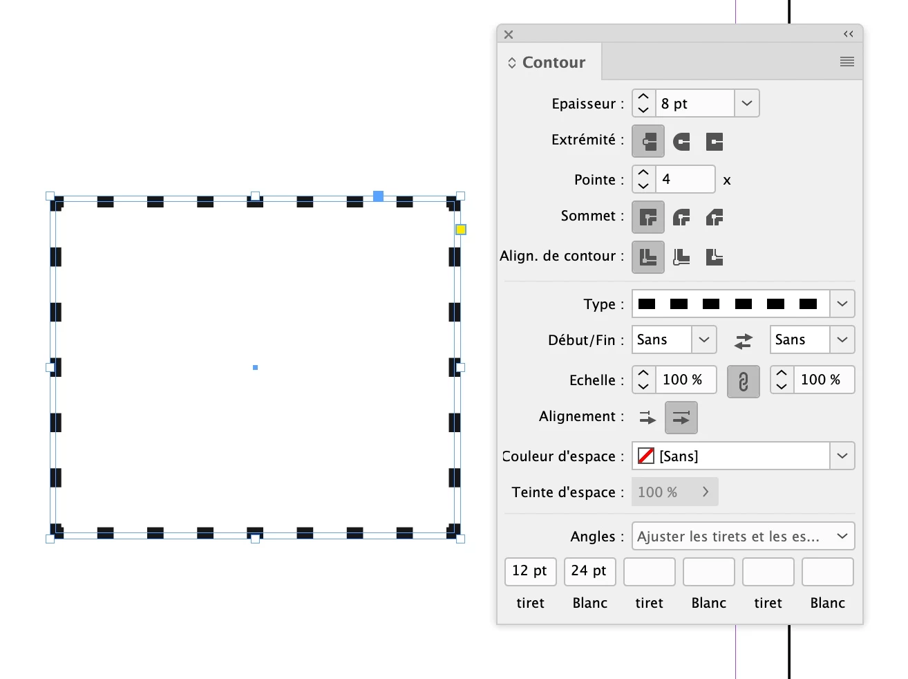

This is not necessary. The problem is solved as described here. You need to select the dotted line, which is taken out separately. As shown in the screenshot. Otherwise, the gap settings do not appear.

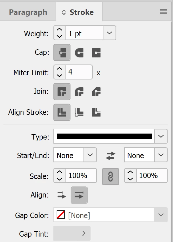

Thank you for the reply.  I was hoping I had just missed something, but I don't see the same stroke palette that you have.  I'm attaching a screenshot of mine.  My ID is v 17.4, I think.

Also, the screenshot shows the line on the palette as solid, but the palette doesn't change, no matter which type I select.
