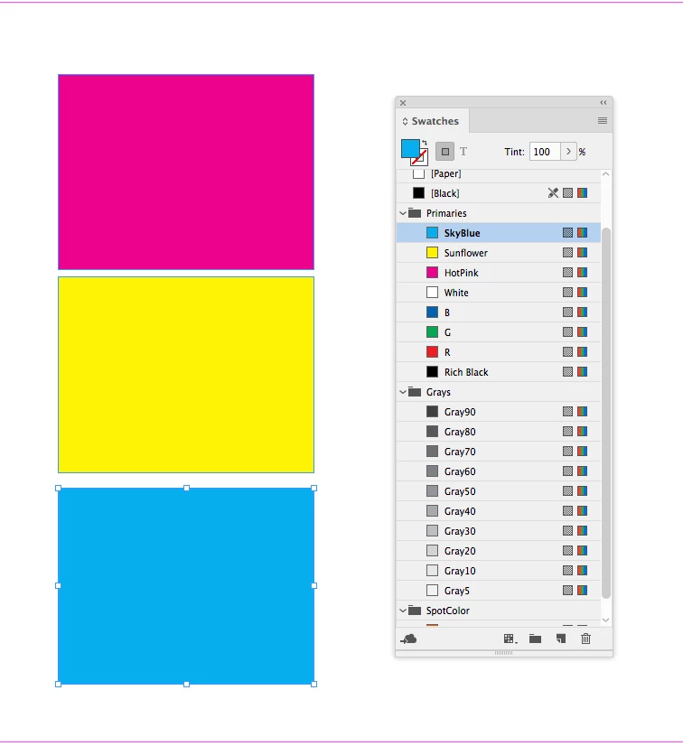

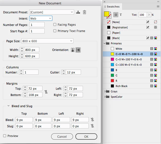

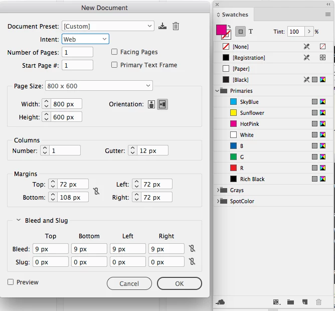

    rob day
    May 30, 2018
    David seems to be describing what I would call a bug (or a bad feature) with the changing color appearance of the default colors.
    You can create your own default swatch colors by editing the Swatch panel's colors with no documents open. It looks to me like the only swatches affected by an appearance change when choosing web intent are the default named swatches, (i.e., C=100 M=0 Y=0 K=0).
    Normally CMYK colors shouldn't change in appearance when they are converted to RGB from CMYK, but the installed default swatches can change in appearance and name. It's hard to think of a case where one would want that to happen.
    So here I've left the default Cyan, Magenta, and Yellow swatches:
    The 3 primary CMY colors change in appearance and name, but note that my other colors are converted via color management and I get RGB versions with the same appearance
    If I give the 100% CMY swatches a custom name, or change the percentages slightly, the conversion is color managed and the appearance doesn't change:

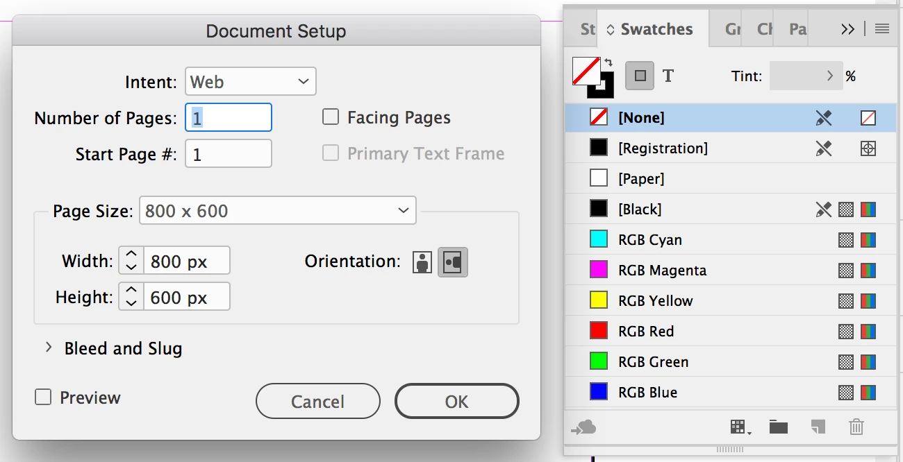

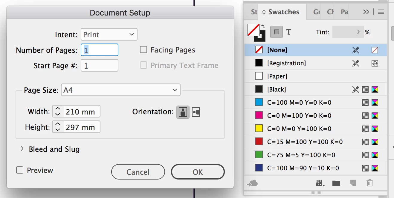

    Colin Flashman
    March 17, 2018
    Did the document ever start off as an RGB web file? That would explain the [Black] swatch being RGB (Note the RGB icon to the right of the [Black] swatch):
    If this is the case, does the following change to the picture below if the Intent in the Document setup is changed from Web to Print?
