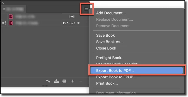

If your publisher accepts PDF files, then it's an easy thing to export a single PDF from the book panel.

Hi @SJRiegel:
As per @SJRiegel's correct answer: click underneath the list to deselect the chapters and choose Export Book to PDF from the book document's panel menu to export the book to a single PDF.
