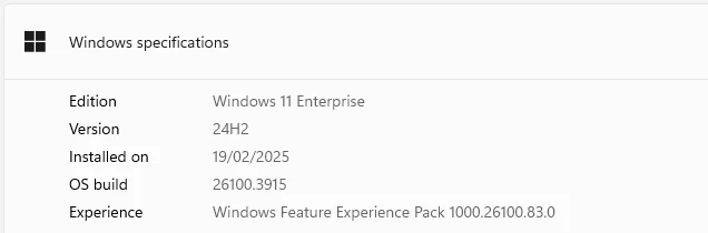

Thanks for sharing the details. I can imagine how frustrating this must be. Could you please confirm the version of InDesign you're using and the operating system details? Also, let me know if the issue occurs with all your Bengali files or just a specific one. If possible, a small sample INDD file and a quick screen recording showing the encoding issue would really help me test it on my end and discuss it with the team.
Looking forward to your update.
Abhishek
May 1, 2025 10:55 AM UTC
Hi Abhishek
im using InDesign 2025 i think its 20.3 x 64 this is from the about Indesign... in the help section
Windows Version :
This issue is with all the files im trying to create

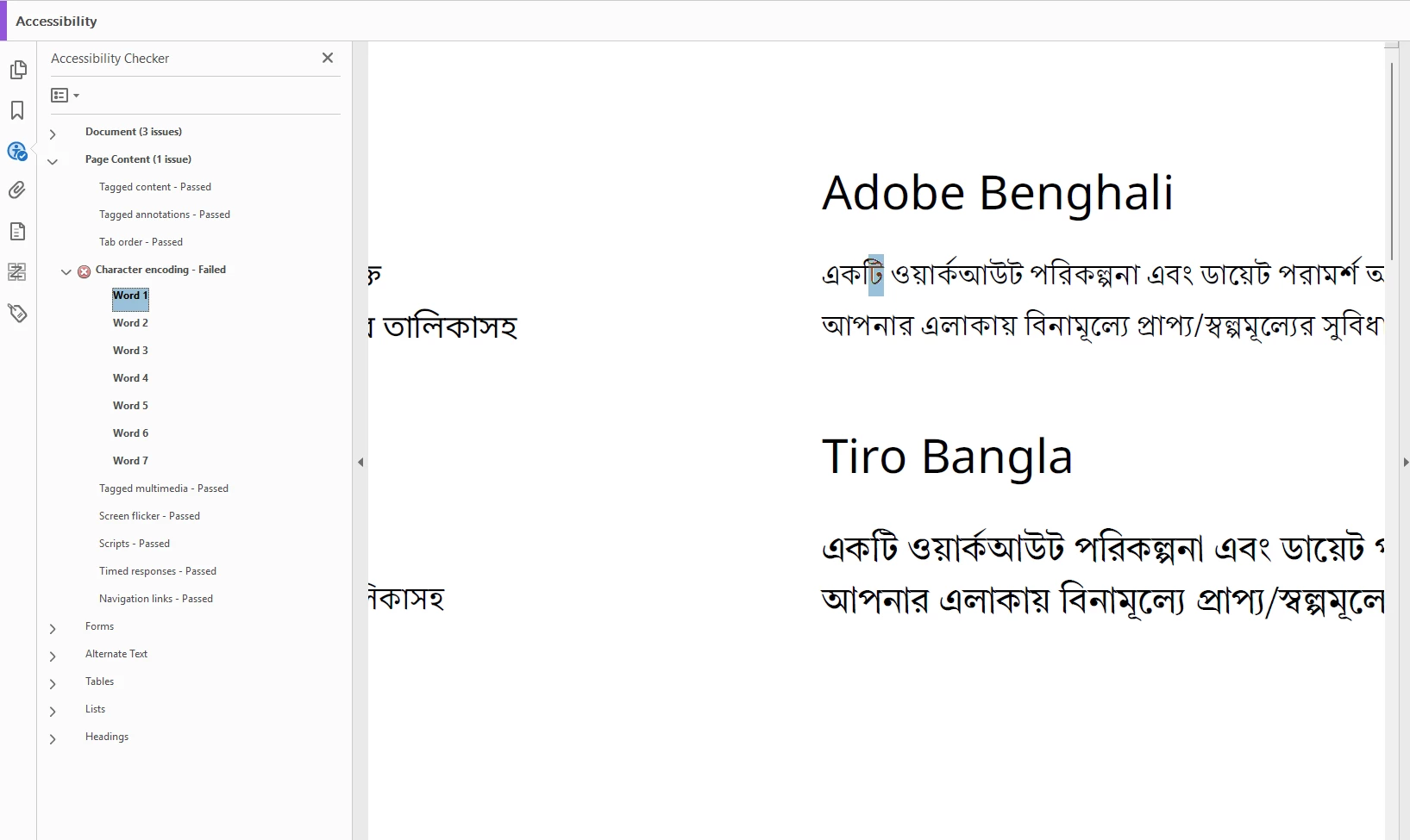

Ive created a 2 files with 2 different composer - one standard and one World ready - i then generate the PDF's from these - ill attach them here
the files have 4 versions of the same copy all in different fonts and there are 2 versions the only difference is the composer
ive attched a screen grab of the error on the world ready composer file being tested in acrobat for accessibility
in this file the words are correct but fail accessibility in the other PDF (attached) it passes accessibility but it has changed / corrupted the formatting of the words so it doesnt read correctly
