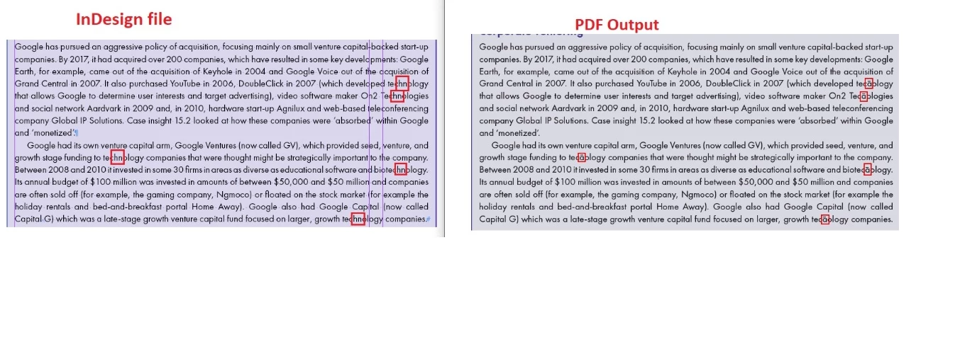

'hn' character converted as unknown character in PDF, but same character looks fine in InDesign application file. It seems display of the character is converted as unknow character during PDF creation.
The issue is not only with the above said characters but also with hi, il, io etc. When the issue was reported we tried opening the application files and found that the characters were correct in the application files.
I've attached error screen shot both InDesign and PDF FYR. Please check and share the solution to fix the same in our project.

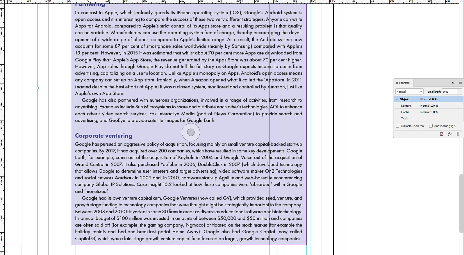

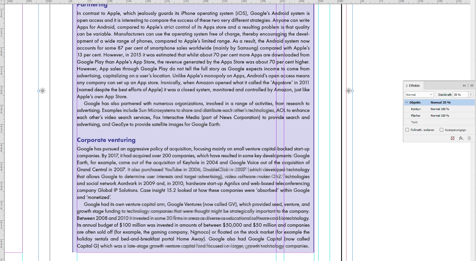

There will be no changes in word wraps at line ending as far as I can see. For that test I placed your PDF and one that I did with the substituted OTF fonts and set your PDF to opacity 35% with the effects panel:
This is a view on my placed PDF where the top PDF, your sample PDF, is not visible because I set opacity to 0%:

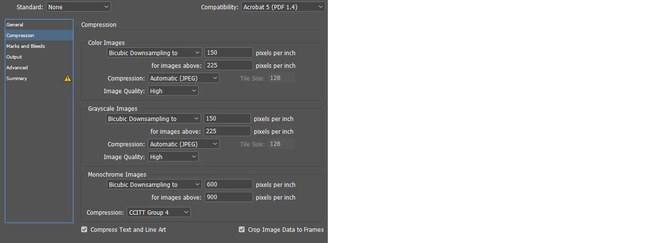

We'll be happy to look into it. We'd require some more information like:
1. Version of OS, InDesign and Acrobat.
2. What presets or settings are being used for PDF export? (You can also attach a screenshot of PDF export settings.)
This information will help us understand issue better.

1. MAC OS, InDesign CC2015 and Acrobat reader
2. Screen shot attached FYR...
