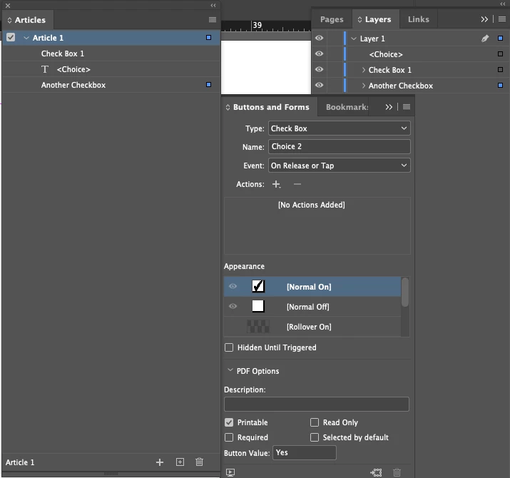

The fact that you're using the Articles panel tells me that your objective is to make your PDF form accessible. It's worth noting that the name of the objects have no relevance for accessibility per se. That being said, the name that you give the object in the Buttons and Forms panel is not recognized by the Articles panel. But if you rename the object in the Layers panel, it will apply to the name of the object in the Buttons and Forms panel AND will be reflected when the item is added to the Articles panel AND in the name when adjusting the tab order within InDesign.

I want the tag and tab order to be the same, that's why I do the adjustments in both places.
If I rename the object in the layers panel I can see the new name in the button & forms panel (and vice versa) but no matter where I do the name change, it never gets reflected in the articles panel.

I'm not sure what version of InDesign you are using but I'm using the latest release. What I am finding is that the Articles panel reflects what is defined in the Layers panel. Even if you rename the item in the Buttons and Forms panel afterwards, the Layer name remains and so does the name of the object in the Articles panel. See screenshot below.
