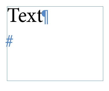

I have looked for an answer many times, but it seems like it is impossible. I want to clean up a document (made of someone else), that has lots of paragraph line break and then the end of story-symbol #. Is it possible to make this:

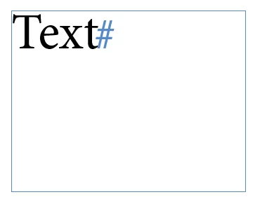

change to this:

You can use a GREP find/change.
find \s+\z and leave the change field blank.

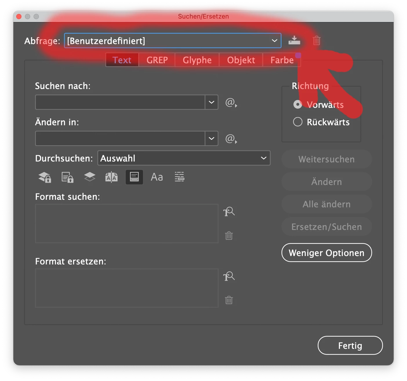

There is in find and replace a preset, Remove trailing spaces and other to clean up text preinstalled. Use that.

Thank you, but I cant seem to find that preset. Can you take a screenshot? The problem was solved using Peter's sullotion, but just curious on this one as well 🙂

Here are all stored presets. You can add your own:
