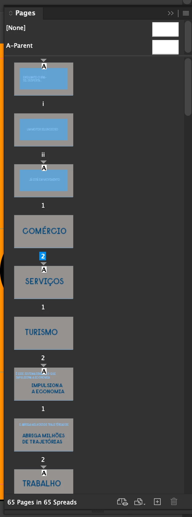

Hi again! 🙂
I just converted a PDF into an indesign file, but I noticed it came with a bunch of section breaks —  the page numbering restarts every 1, 2 or 3 pages. I've selected all pages and tried to override the sections by starting a whole new section in "numbering and section options" but it just affected the first section/the first two pages.
By any chance, does anyone know a good workaround so that it won't be necessary to manually reset all the sections one by one, not in this nor in future converted documents, please?

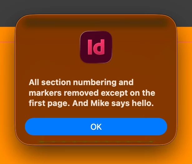

This JavaScript will successfully remove extra section markers:
 * Remove all section numbering and section markers
 * except for the first page in the active InDesign document.
 * Works in InDesign 2026.
(function () {
    if (app.documents.length === 0) {
        alert("Please open a document first.");
        return;
    var doc = app.activeDocument;
    var sections = doc.sections;
    if (sections.length === 0) {
        alert("No sections found in this document.");
        return;
    // Keep only the first section; remove all others
    for (var i = sections.length - 1; i >= 1; i--) {
        try {
            sections[i].remove();
        } catch (e) {
            $.writeln("Error removing section: " + e);
    // Reset the first section’s properties to make sure it’s clean and intact
    var firstSection = sections[0];
    firstSection.continueNumbering = false;
    firstSection.pageNumberStart = 1;
    firstSection.sectionPrefix = "";
    firstSection.marker = "";
    firstSection.includeSectionPrefix = false;
    alert("All section numbering and markers removed except on the first page. And Mike says hello.");

ppppppppgonzaga
Nov 4, 2025 11:55 PM UTC
Hello Mike! Works perfectly!
Thank you so much!
