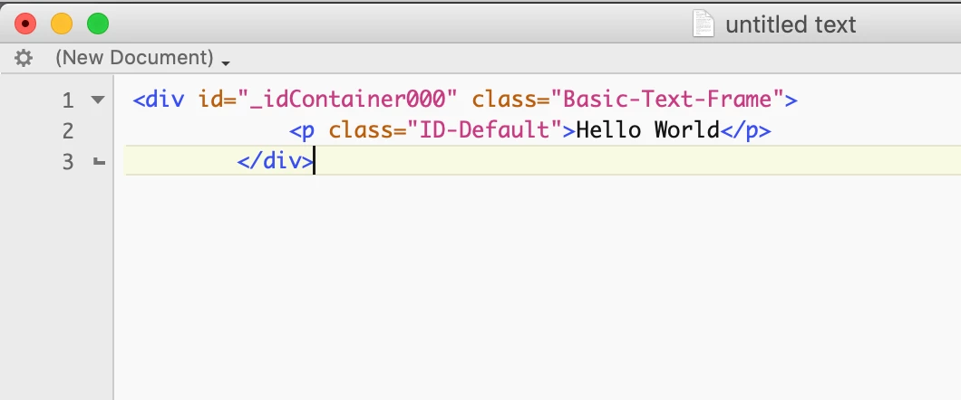

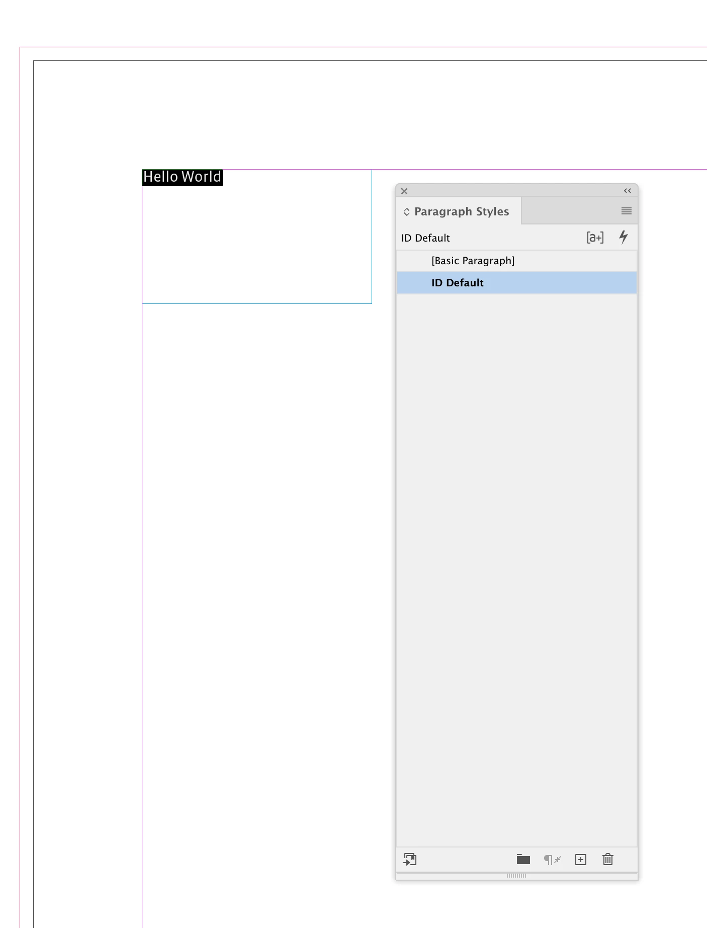

Here’s a variation on the CSS script:
var sel = app.activeDocument.selection[0];
CopyTextAsHTML(sel)
* Copt the selected text with HTML tags
* @ param a text selection
* @ return void
function CopyTextAsHTML(t){
    var doc = app.activeDocument;
    var f = new Folder(Folder.temp.fsName + "/gethtml")
    f.create();
    var exPath = f + "/" +  doc.name + ".html";
    doc.htmlExportPreferences.viewDocumentAfterExport = false;
    t.exportFile(ExportFormat.HTML, File(exPath));
    var htmlText = readFile(exPath);
    var regx = new RegExp("<div[^.\]+div>");
    var ht = htmlText.match(regx);
    var tf = doc.textFrames.add({contents:ht.toString()});
    tf.parentStory.texts[0].select();
    app.copy();
    tf.remove();
* Read a text file
* @ param file path
* @ return file’s text
function readFile(p) {
	var f = new File(p);
	f.open("r");
	var x = f.read();
	f.close();
	return x; //returns the text in the file sampletext.txt

This was the solution I was looking for. Only at the RegExp I had to enter the following <div[^]+div>.
So I could pass everything I had selected and still correctly.
