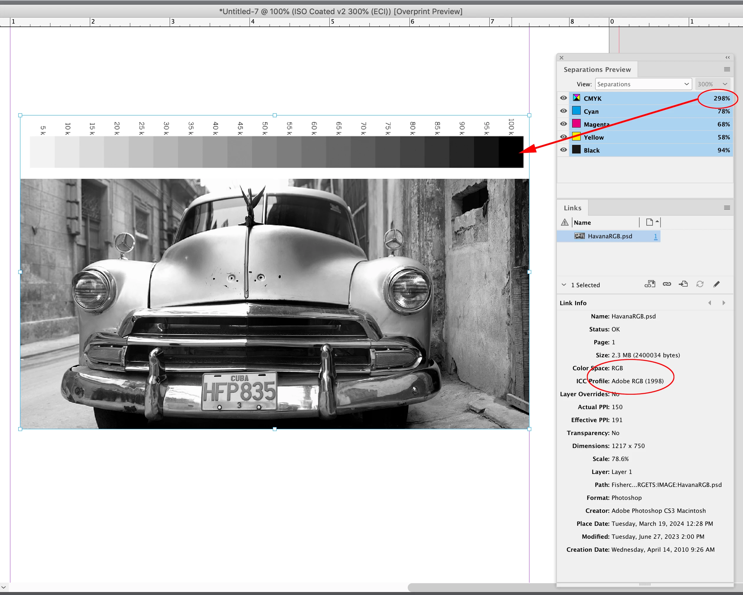

Hi @mattjenkins81 , Are you sure the printer is letting your PDF/X-1a CMYK values output unchanged without any additional conversions on their end?
If you are sure your values are being output to the plates, you can use Separation Preview to check the image’s black point. You want to make sure the image black point approaches the ISO Coated 300% total ink limit:

@rob day Thank you for the response, yes I have confirmed with the printer the RIP is 'optimised' for the colour profile mentioned, I take that to mean they don't do any further conversions. Great, thanks for the tip, I'll check the separations and ink limits on the images.
