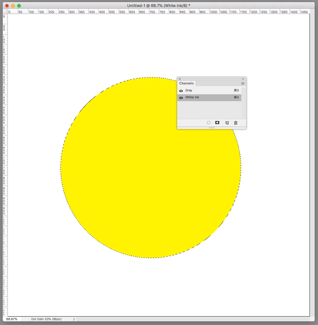

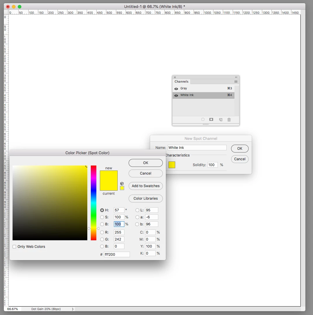

    I am designing a card but i need to add a spot colour to print white

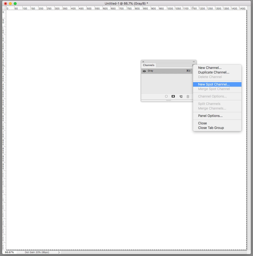

    To create a Spot color in Photoshop you have to make and use a Spot Channel. The color mode doesn't matter, but the artwork has to be in the spot channel and not in the process color channels. Here I'm adding a Spot Channel to a Grayscale file by choosing New Spot Color Channel from the Channels panel:
    Give the channel a name and define the color preview by clicking the Color swatch. Color is for the screen preview and doesn't affect the printed spot color.
    Make sure your art is limited to the spot channel

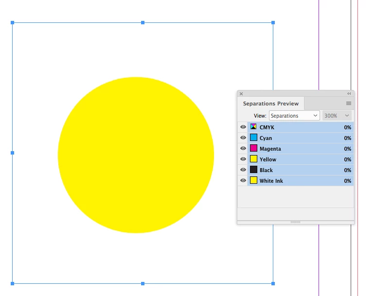

    After placing the PSD with the White Ink spot channel in ID the spot color shows in the Separation panel:

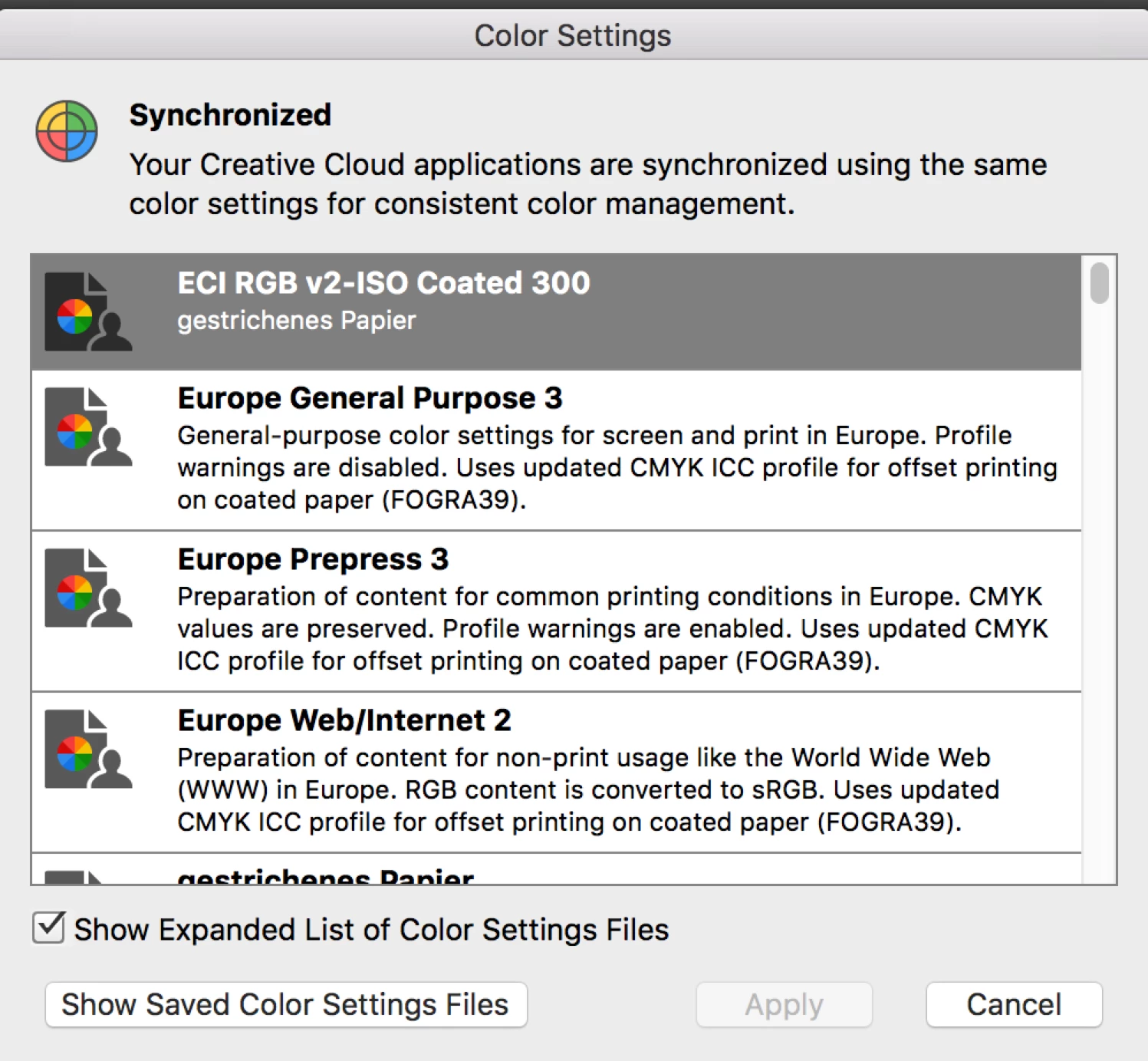

    Marianne-Deiters
    August 30, 2018
    Is ist only a different appearance or did you measure the color? For the appearance it could help to use the Overprint Preview from the "View" Menu.
    Are you eventually using different color settings in Ps and Id? Then you cold get different colors by converting the profiles. For future works with new documents it is easy to synchronize the color settings in Adobe Bridge. Press ctrl + shift + K in Bridge, make your choice and press "Apply"

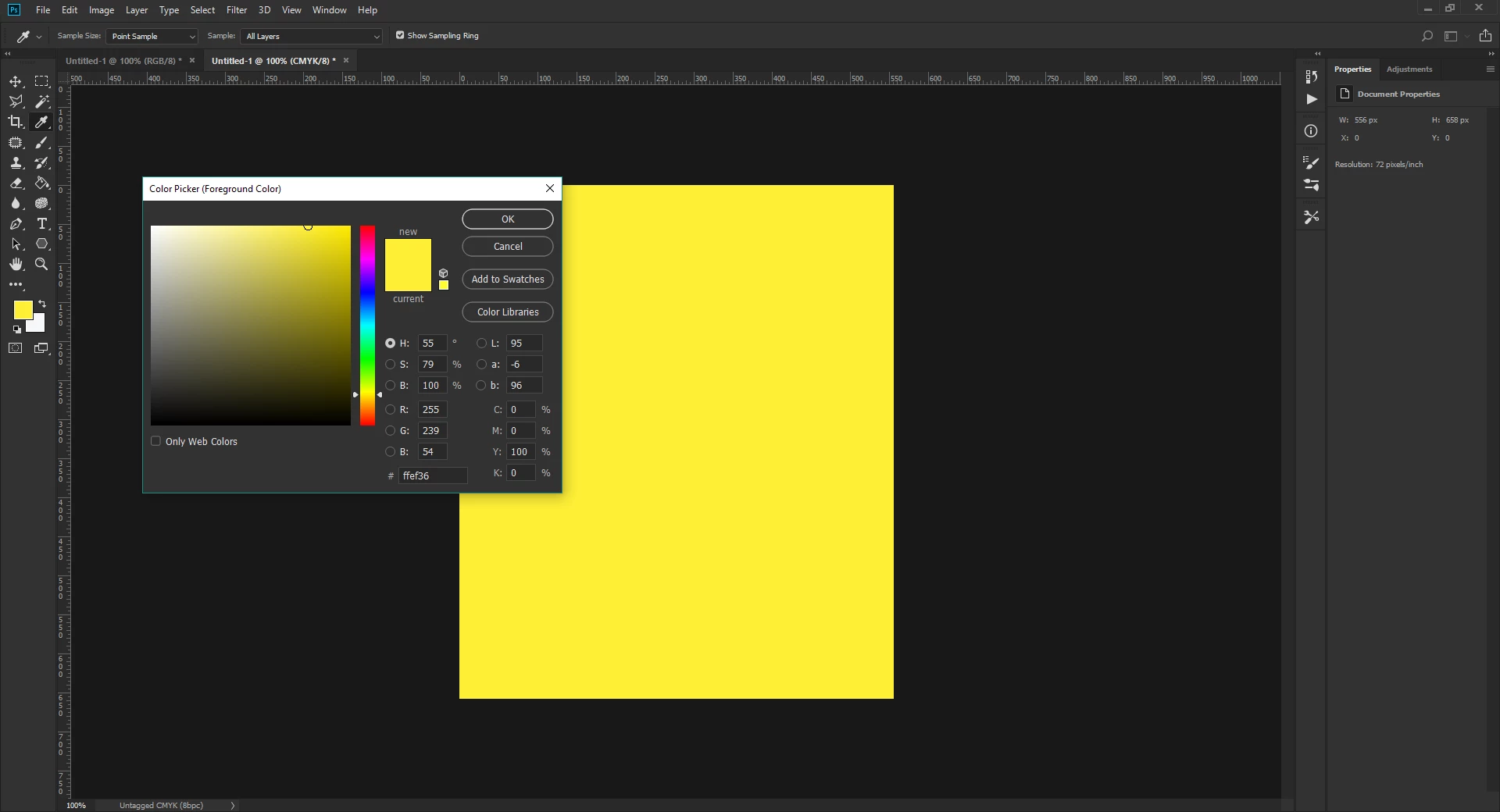

    August 30, 2018

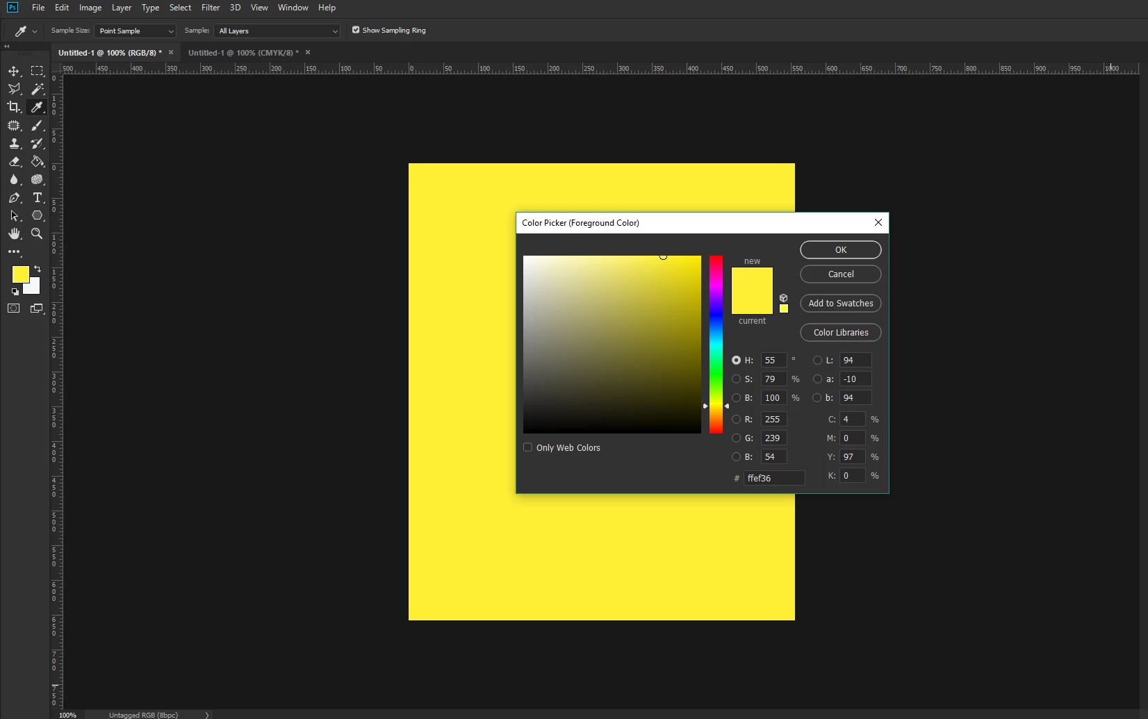

    Is your colour space set to CMYK?
    Notice the first image colour space is RGB, even when I input C0 M0 Y100 K0 and then use the eyedropper tool it still shows as C4 M0 Y 97 K 0
    But the CMYK colour space is Y100 as intended.
    RGB
    CMYK

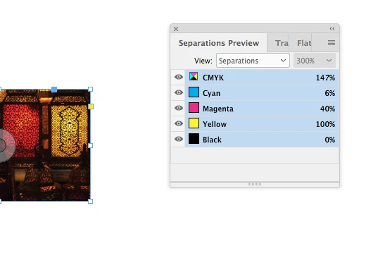

    manal shanableh
    August 30, 2018
    From Window> Output> Separation Preview
    View: Separations
    when you mouse over the any color over the inserted image, you can check the color percentage.
