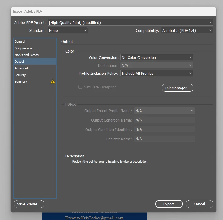

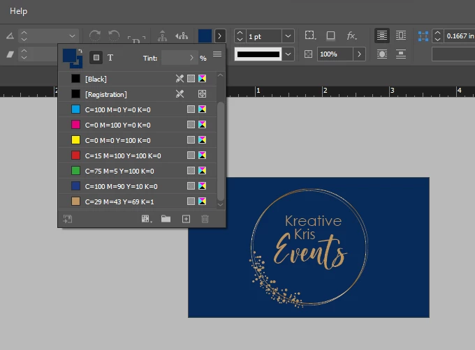

I'm trying to print a business card on GotPrint. After uploading to GotPrint, I get a message that says 'we recommend uploading files in CMYK'. I've never gotten this message before and haven't changed any settings in InDesign. The only thing different is the paper stock/finish I chose in GotPrint. I don't see how my file isn't in CMYK. Any help is much appreciated!
Screenshots attached

Right you would normally need a Spot color for foil printing.

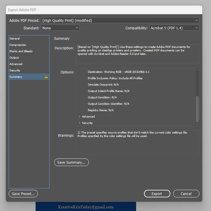

Hi @Dana L , The info in your Summary capture doesn’t match what you have set in your Output —the summary is showing you set Color Conversion to Convert to Destination with the Destination set to sRGB. If you want to be assured that the PDF is all CMYK Export to the PDF/X-1a preset.
Dana LAuthor
August 1, 2023
Thank you, Rob. I tried exporting to PDF/X-1a and I'm still getting the same error. I eventually got the Summary and Output to match to CMYK, but GotPrint is still giving me the error, so I'll check with them. Thank you for your help.
