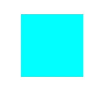

Hi all,
I've just upgraded to the 2019 suite. Since doing so, when placing CMYK Illustrator graphics into InDesign they display as RGB when in Typical Display under Display Performance. If I change to High Quality Display they display correctly. It's no biggie but as I work in CMYK more often than not, it's a bit frustrating to either have to reopen my graphics to double check I've got the correct Document Colour Mode in Illustrator or to have to toggle between Typical and High Quality Display modes in InDesign.
Does anyone know of a way to change this so that the Typical Display mode displays CMYK graphics as CMYK?
This is a 100% cyan box created in Illustrator and placed into ID 2019 and viewed in Typical Display mode.
Equally this might be something that's changed in Illustrator and to do with the export of the graphics, I guess.
Many thanks in advance guys and gals!

    Beste Antwort von Laubender
    Thanks Uwe, but either of those slows down my work as everything then previews in high res. Whilst either of those solves the display problem, neither explain why in CC 2019 the Typical Display is displaying in RGB.
    Ham1000  wrote
    … neither explain why in CC 2019 the Typical Display is displaying in RGB.
    My assumption is, and I tested this with CC 2018.1 and CC 2019, that in your color settings color management is turned off.
    Uwe

    October 26, 2018
    Having trouble replicating this. Would you be in a position to share the files?
    Kind regards
    Eugene
    October 26, 2018
    Hmmm interesting.
    Just a few quick queries:
    What colour mode is your InDesign file in? Is there are any transparencies on the page?
    For example, if you go to Edit>Transparency Blend Space - what is it set to?
    Another thing just occurred to me.
    Is the colour set to 100% Cyan in Illustrator.
    What I'm thinking is if the document was originally RGB and you apply a 100% cyan it would convert it to RGB values - if you then convert the document to CMYK - the values will change from RGB to CYAN and make a 4 colour cyan.
    I suppose the easiest way to check for something like this is if you go to the separations preview and see what values you have the Cyan square.
    Sorry for all the questions and the ponderings!
    Ham1000Autor
    October 26, 2018
    Hi Eugene,
    Colour mode is CMYK. There are often transparencies on the page, but none of this has caused the issue prior to upgrading to CC 2019.
    The colour of the example square above in Illustrator was 100% cyan with Document Colour Mode of CMYK, too. There hasn't been any conversion per se between CMYK and RGB; it's literally just the screen preview which displays in RGB. If I sent it to a printer it would still reproduce as 100% cyan.
    Separation preview confirms 100% cyan, too. As I say, it might be an Illustrator export issue, except – as I mentioned previously – if I change the Display Performance to High Quality then it displayed correctly.
    Weird...
