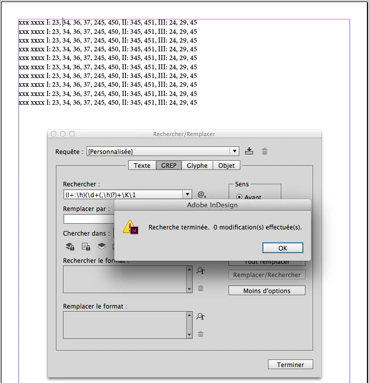

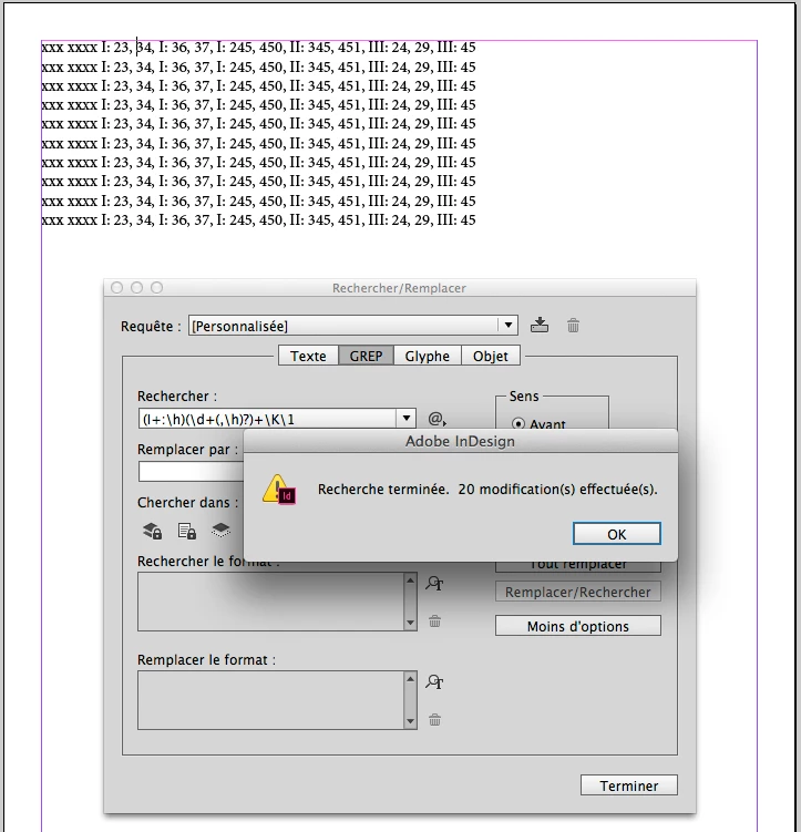

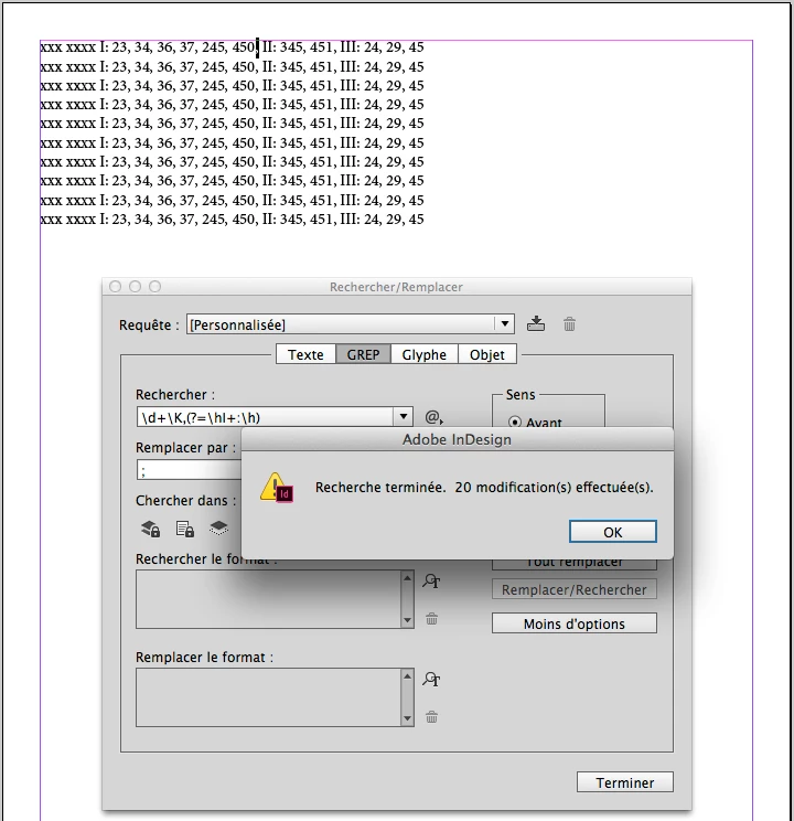

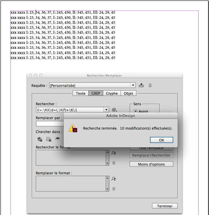

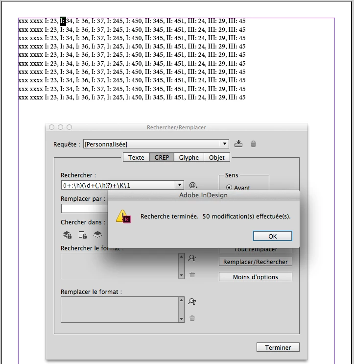

If I only used the ID Find/Replace window, I should need to play 4 times the first and 2 times the second to have a "zero" replace-counter:
Regex1:
Regex2:
… So, if you count the points, we have: (Regex1: 50 + 20 + 10 + 0) + (Regex2: 20 + 0) = 80 find/replace!

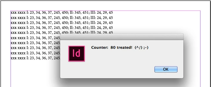

I've rewritten the script! My deal is to launch "x" times the regex1 because I know it won't find all the occurrences in one time!
So:
function main()
        var myDoc = app.activeDocument,
        FindWhat1 = "(I+:\\h)(\\d+(,\\h)?)+\\K\\1",
        FindWhat2 = "\\d+\\K,(?=\\hI+:\\h)",  ReplaceBy2 = ";";
        app.findGrepPreferences = app.changeGrepPreferences = null;
        app.findGrepPreferences.findWhat = FindWhat1;
        myFound = myDoc.findGrep();
        var F = myFound.length,
        myCounter = 0;
        for (var f = 0; f < F; f++) {
            myChange1 = myDoc.changeGrep();
            F = myChange1.length;
            myCounter += F;
        app.findGrepPreferences.findWhat = FindWhat2;
        app.changeGrepPreferences.changeTo = ReplaceBy2;
        myChange2 = myDoc.changeGrep();
        myCounter += myChange2;
        alert( "Counter:  "+ myCounter + " treated!  (^/) ;-)" )
What I'm trying to get is having a first estimation of "F", run  x (<= F) times the regex1 [see lines 07 + 14].
When "F" will be equal to 0 [see line 13], the "for" loop will be finished and, so, the "while" loop will be finished too!!
At this moment, the script could run the Regex2!
As you see, this 2nd version works but surely a more orthodox way, based on these 2 regex!
