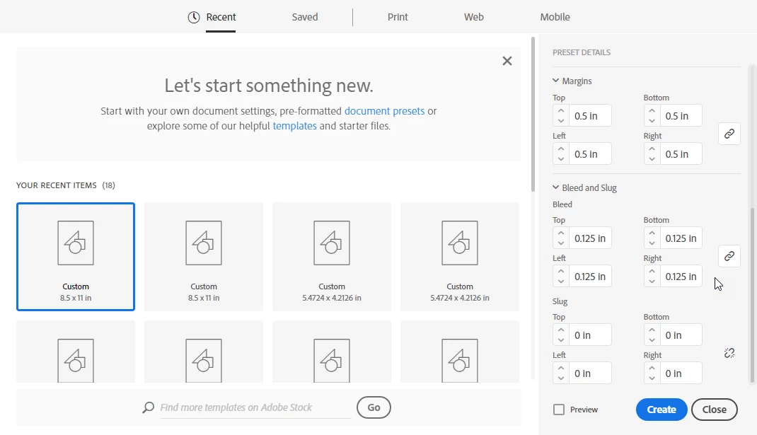

Starting from a new document (though this will work with an existing one too):
1) Create the new document with equal margins. My example below is letter sized, four pages, with a half-inch margin all around. Turn off the Facing Pages check box.Open the Bleed and Slug section at the right and enter your bleed space. I used an eighth-inch bleed.

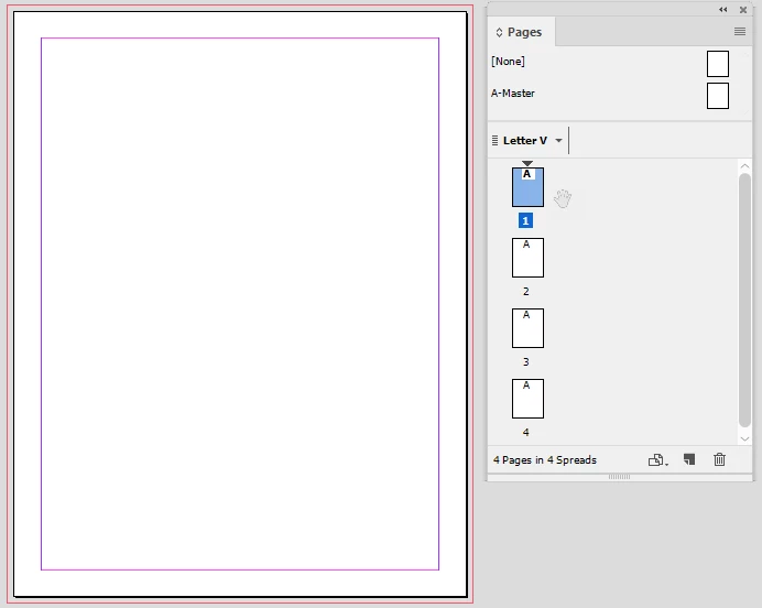

2) This opens our four-page document with it's default A-Master master page layout, as illustrated below:

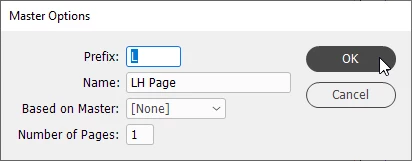

3) Let's start changing the rules here, by first editing our A-Master setup to reflect the layout for our left-hand pages. Click on the flyaway menu, the three lines in the upper-right of the Pages panel, and select the Master Options for "A - Master" ... menu command.

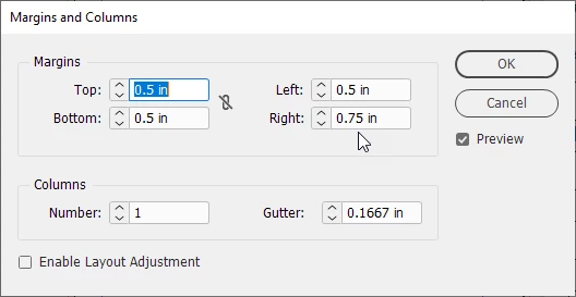

It's a bit redundant, but we can both rename the Prefix: letter and the Name: of the masters in the edit boxes. So why not; let's make the letter L and the name LH Page. Click the OK button. Then we change the "inside margin for the left hand pages, which would be the Right: one, to show 0.75 in. Go to the Layout>Margins and Columns... menu command and change the margin as shown below:

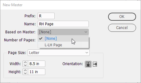

4) Go back to the Pages panel flyaway menu and Select the New Master... menu command.
We'll fill in this new master page with an R Prefix: and RH Page Name: edit boxes. If we had an elaborate layout we could base it on our existing LH Page master, but since this is a simple example we'll choose the Based on Master: option of [None]. Now we'll change the "inside margin for the right hand pages, which would be the Right: one, back to 0.5 in and the Left: one to 0.75 in. Go to the Layout>Margins and Columns... menu command and apply the appropriate margins. Massage the master page content if/as necessary.

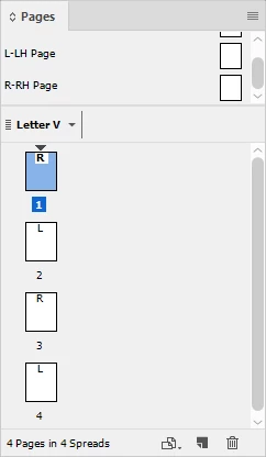

5) Apply the appropriate master pages to your document, then fill in the document pages, as shown below, and you'll be in business.
Never print as spreads, or InDesign will artificially re-introduce your crossover bleed problems. Hopefully this will work pretty slick for you.
