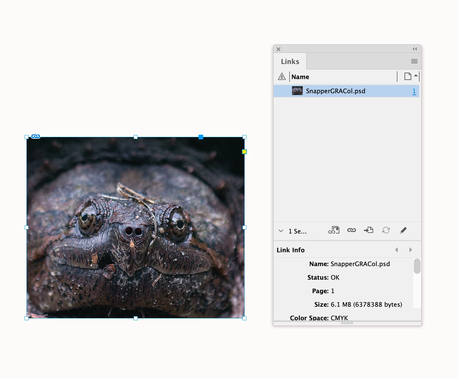

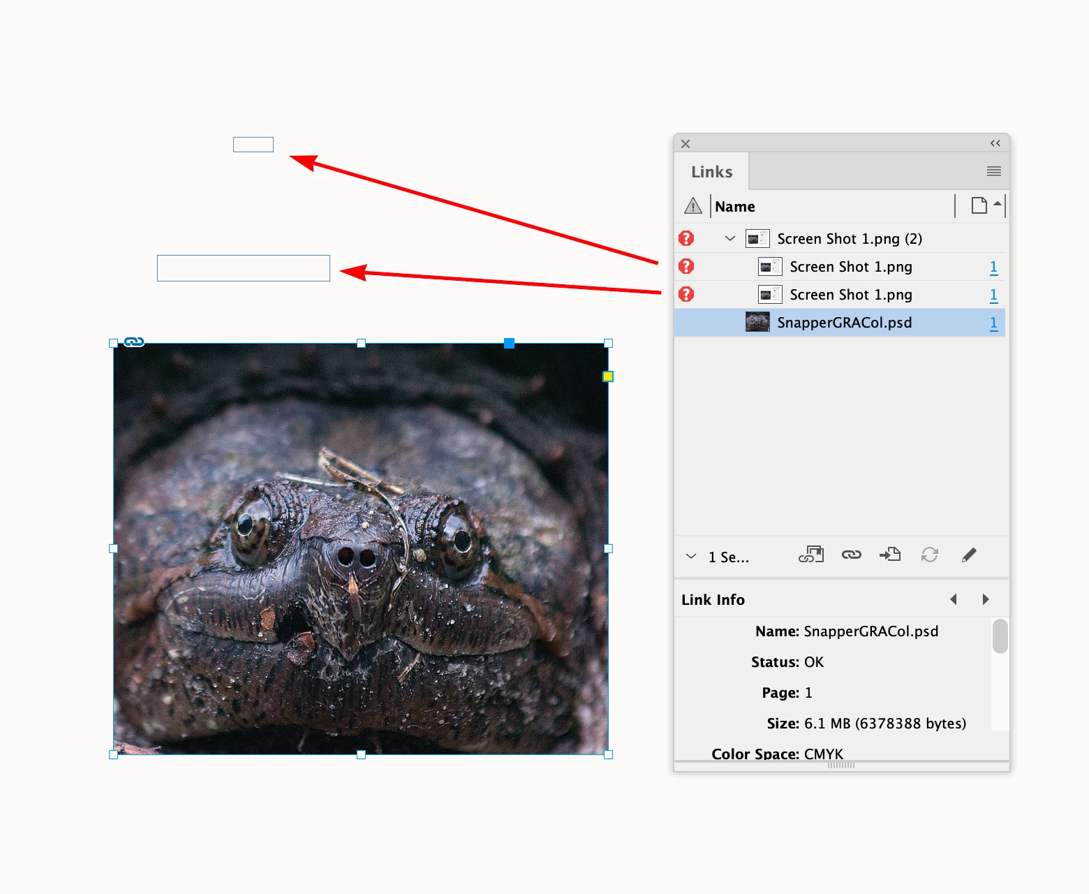

    Here there are 2 missing links, which are not visible:
    Which get removed via the script:
