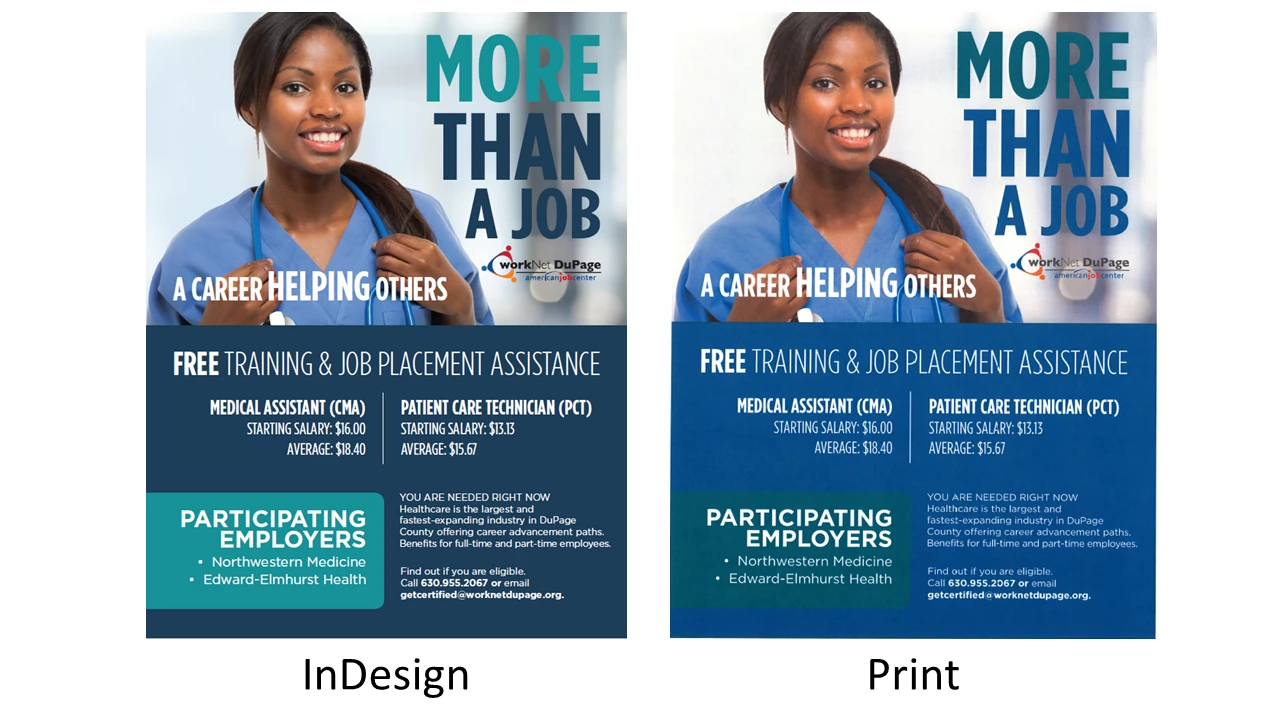

We just got a new Xerox VersaLink C7000 color printer. Our marketing coordinator created a flyer in InDesign and tried to print it with the Xerox. Quality is fantastic, but some of the colors are off (see image below).
Is there a way to address color disparities in InDesign? I've been reading about RGB working spaces and I'm guessing that the colors the marketing coordinator selected just don't translate well to the printer and/or the paper (using a multi-purpose office paper, [20 lb / 10M / 75 g/m2]), but would love to hear how you all have addressed similar issues.

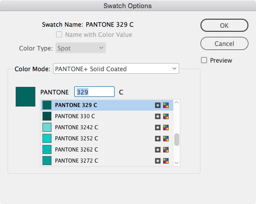

From your captures in #1 it looks like the spot Pantone colors are the problem, and right exporting a PDF would not be a fix without first changing the spots to process.
The image is printing brighter and more saturated, while the light green is printing darker and less saturated, and the dark green is printing brighter and bluer—I'm guessing the light and dark greens are Pantone spots?
You only want to spec spot colors when the job is printing on an offset press and the Pantone colors will output to custom plates—Pantone inks are custom colors and composite color printers can have difficulty rendering them.
Try setting the Pantone colors to Process like this, and then export an sRGB PDF:

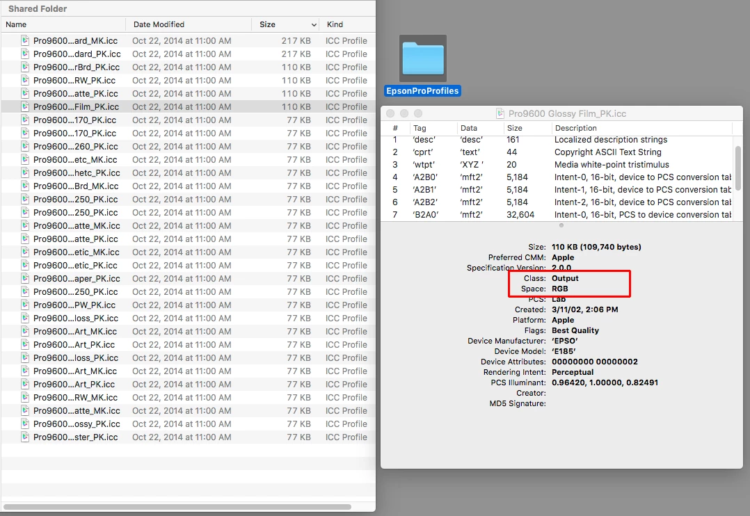

Troubleshooting someone else's composite print color management can be almost impossible because there are so many variables in the individual print  drivers that affect output. If the driver expects RGB color (most composite printers) the output profile would also be an RGB (output) profile and would normally be selected in the print driver and not assigned to the document. The printer profile would change depending on the paper being used and maybe resolution quality.
My RGB driven Epson printer has 30 different RGB output profiles installed in the OSX /Library/Printers/EPSON folder:

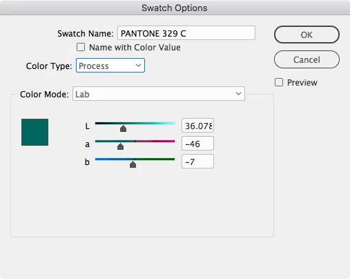

Are all of the colors process or are you using Spot colors? Look at Swatch Options>Color Type

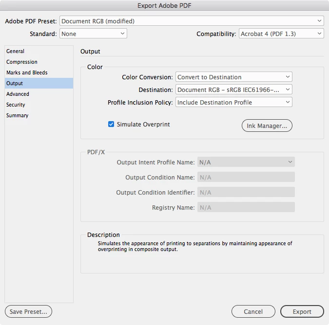

Unless you have a third party RIP to drive the printer, exporting the page to PDF and printing from Acrobat might produce better results. Composite print drivers almost always expect RGB color and handle the final color conversion internally. So try exporting the page to PDF with the Output tab set like this, and print from Acrobat:
