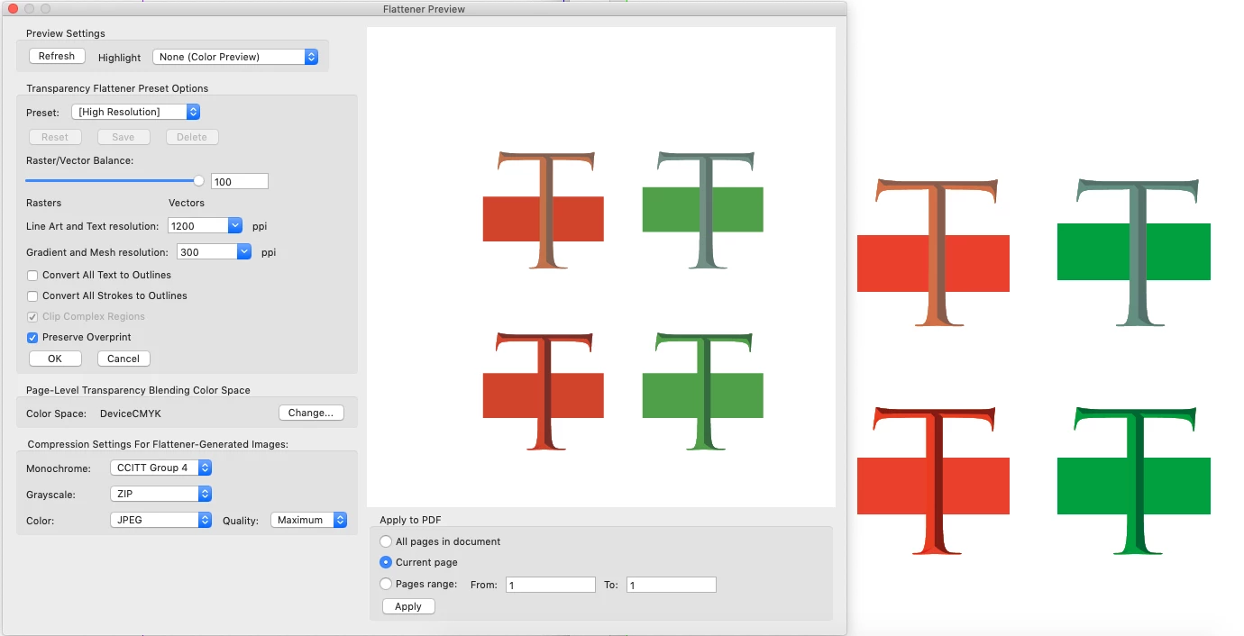

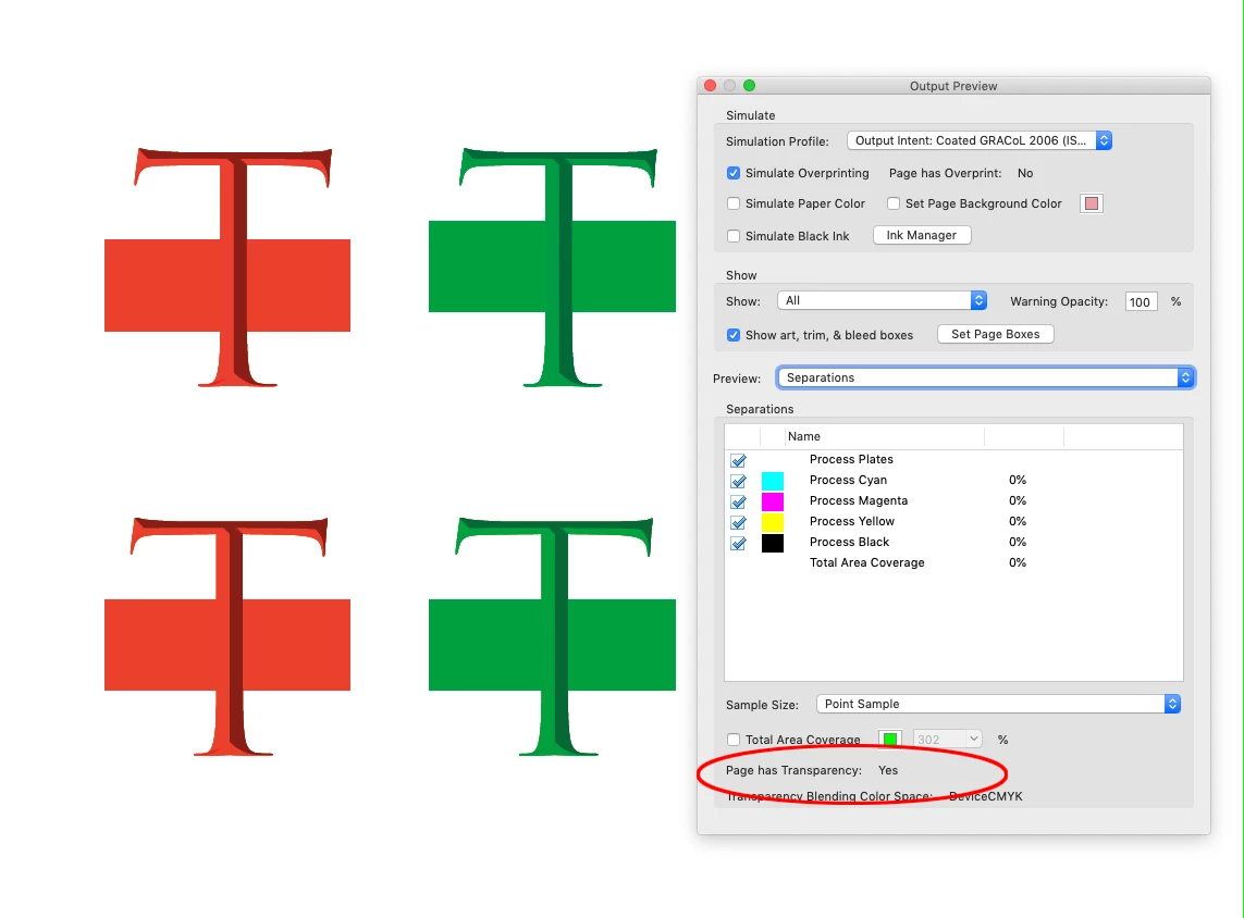

Hi @Brad @ Roaring Mouse , it looks like the problem happens in the transparency flattening and isn’t related to profile inclusion. I do see better results with PDF/X-3 and PDF/X-1a where the page is flattened on Export (Acrobat 4 Compatiblity).
PDF/X-4 as well as X-3 and X-1a export Document CMYK color as Device CMYK. With PDF/X-4 it is a feature not a bug, it reduces the chance of accidental CMYK-to-CMYK conversions (i.e. [Black] converted to 4-color), and the Output Intent Profile tells the printer what the document CMYK profile is.
It looks like the SVG fonts incude transparency (InDesign’s Flattener Preview highlights Trajan Color) If I export my Trajan example as PDF/X-4 and flatten the page using AcrobatPro’s Flattener Preview the extreme color problem becomes apparent.
Ironically one of the selling points of PDF/4 is it delays flattening of live transparency and possibly color management until output, but with SVG fonts PDF/X-1a’s flattening will produce a better result.

I actually delved into the PDFs with PitStop and compared one created with the PDF/X-4 preset with a few made with other standards. In all the other ones, the objects that made up an SVG object were individually tagged with the output colorspace (in my case, GRACOL), whereas the 4:2008 one was not tagged (which, as you mentioned, was probably by design), and had the incorrect cmyk values.
I also printed my test file out to Postscript (full Level 3 PS/Color Unchanged) and it rendered properly, and also Distilled perfectly, no matter what Standard I used.

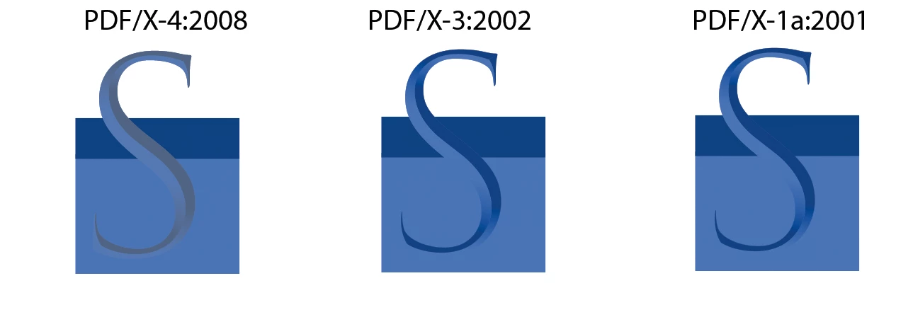

Jul 28, 2021 9:59 PM UTC
Sooooo... I think I've got it figured out:
If you use the PDF/X-4:2008 spec, the colors will screw up.
If you use PDF/X-3:2002 or PDF/X-1a: 2001, the colors will render properly.
After doing some tests with Illustrator using the same 3 standards, which work fine, it seems there's something happening when ID exports to that standard with the SVG fonts.
I also went back to ID2020 and found PDF/X-4:2008 problematic there too, but in a different way.
Anyway, here's the result...(Exported with Color Convert to Destination)

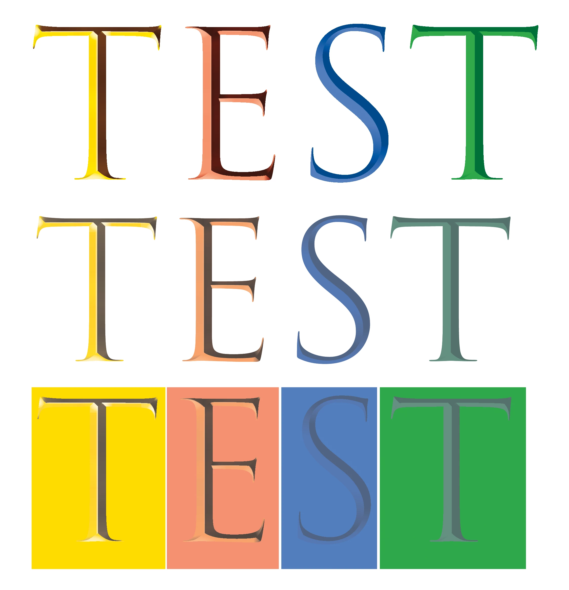

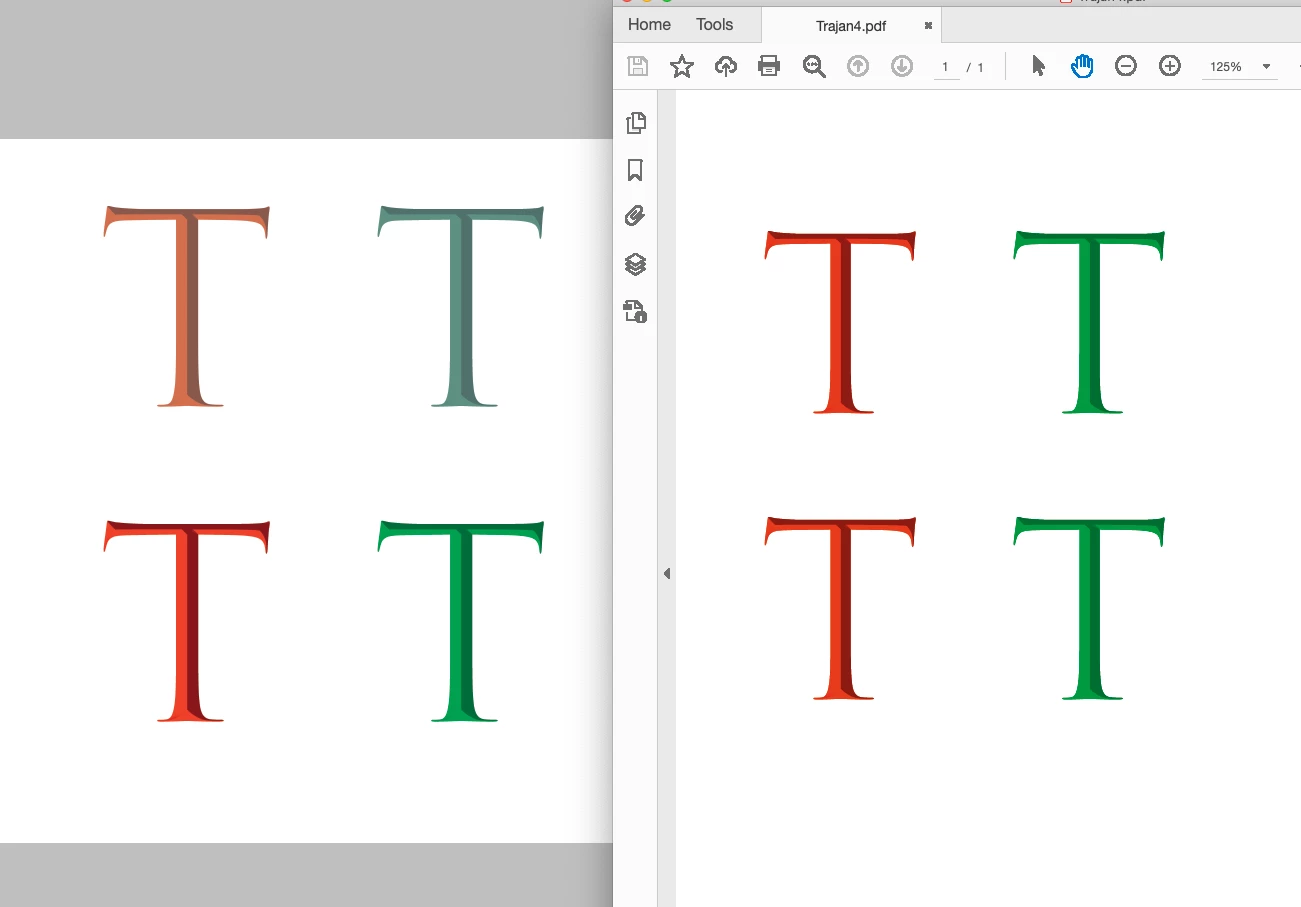

Interesting: I took both your PDFs, and opened/rendered them into CMYK files in Photoshop. The dulling appears equally in both results. (Actually, if you open both PDFs in Illustrator, the colours are dulled there too)
Sooo,  just did a test using the Trajan Color Font, and I'm experiencing the exact same dulling problem if I export a PDF the way the you have done (i.e. Output intent US Web Coated (Convert to destination)
The PDF looked just fine on screen, but upon test-rendering it into Photoshop, the colors dulled exactky the same as you experiened.
(See Attached: It should look like the top line. At bottom, I added color squares behind each letter using the same colors in the font. They rendered correctly but you can see the font itself went dull.)
However, saving to PDF with No Color Conversion rendered properly in Photoshop. So, I suggest you export your PDF that way (you should anyway: it’s the preferred workflow); Let your printer convert it in their RIP.
As an expriement, I created the same type in an Illustrator file, saved as as PDF in both RGB and CMYK, and both rendered correctly when opened in Photoshop. In fact if I place these Illustrator PDFs into ID, they render correctly, even when the live type in ID does not.
So it appears ID has an issue with how a color space is applied to SVG type.
